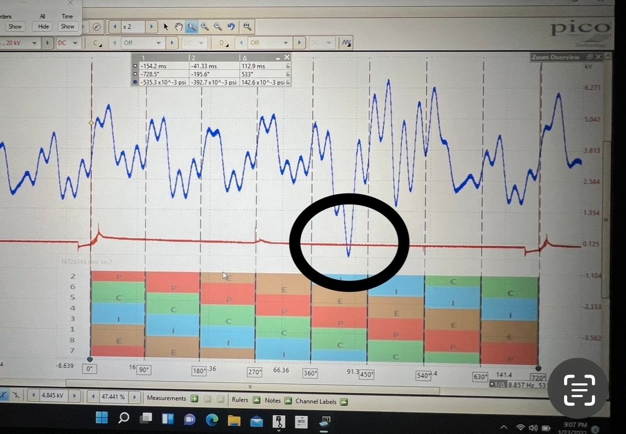

Ok, first thing the crankshaft position sensor is the engines’ “misfire detector” so when a misfire occurs the crankshaft slows down and when a certain threshold is passed a misfire will be seen…MAP being lower on a cammed car with higher valve overlap or even a higher MAP reading has nothing to do with misfire detection…to verify a cylinder is misfiring and positively identifying which one I use a pressure transducer in the tailpipe to see this and the misfire will produce vacuum in the combustion chamber instead of the exhaust gassed being “pushed out” of the exhaust manifold…this vacuum (circled below) can be seen in my waveform below….I can run a car for hours until I might see a misfire and yes some misfires which are called “phantom” misfires can be set by the ECM…I don’t know if all this started after your engine work was done but a “crankshaft variation learn” should have been done by whoever did the engine work…a crank position sensor change also requires this procedure…any vibration like worn torque tube bushings can also set a P0300 since these vibrations also cause the crankshaft to slow down….if I were you I’d get it professionally diagnosed !!

Okay so quick update I Got the test done the one you recommended there was no loss the line was straight across, So i replaced plugs and coil packs issue still persists, Replaced the heads partially because i had an issue of spark plugs having a slight wiggle to them even after torque. and a new intake manifold both mostly for power but also to knock out more problems. issue still persists i’ve cleaned grounds, the only other issue that popped was a loss of ecm contact that came and went, The car is currently untuned so possibly could be the problem but i have a feeling it’s not, Do you have any other ideas?
