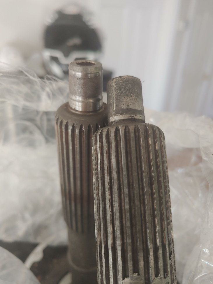

Kind of lost here, and are you looking for a complete TT assemlby including tube houseing as well, or just the front input shaft part of the TT assembly since it got chewed up?
If just this,
Then post photo of marred up part of shaft, since if just the snout area where it goes into the Pilot bearing, that part is easy to fix with just weld build up,and turning the end back down, and a lot cheaper than replacing the input shaft with a new one instead.

I was hoping to get the entire propeller shaft as a complete unit with new bearings and couplers already installed but the only one available is for the automatic cars. With import fees and taxes, it wasn't much more to get the entire shaft, but I guess I will just be rebuilding mine and putting a stronger front input shaft. My local shop warned me they don't typically rebuild them because of the risk of vibration, but with the manual propeller shaft being discontinued, I have no choice but to rebuild.
