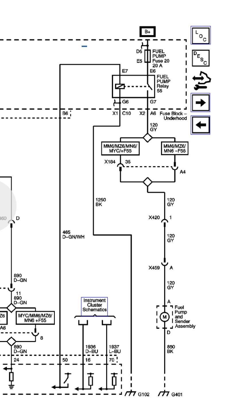

We did some research and based on what we read, we figured the airbag module would be telling the pcm not to turn the fuel pump on. However when we turn ignition on, the fuel pump relay clicks temporarily (I even tried manually bypassing it) and I checked that the 10A fuse in the underhood fusebox is also good.

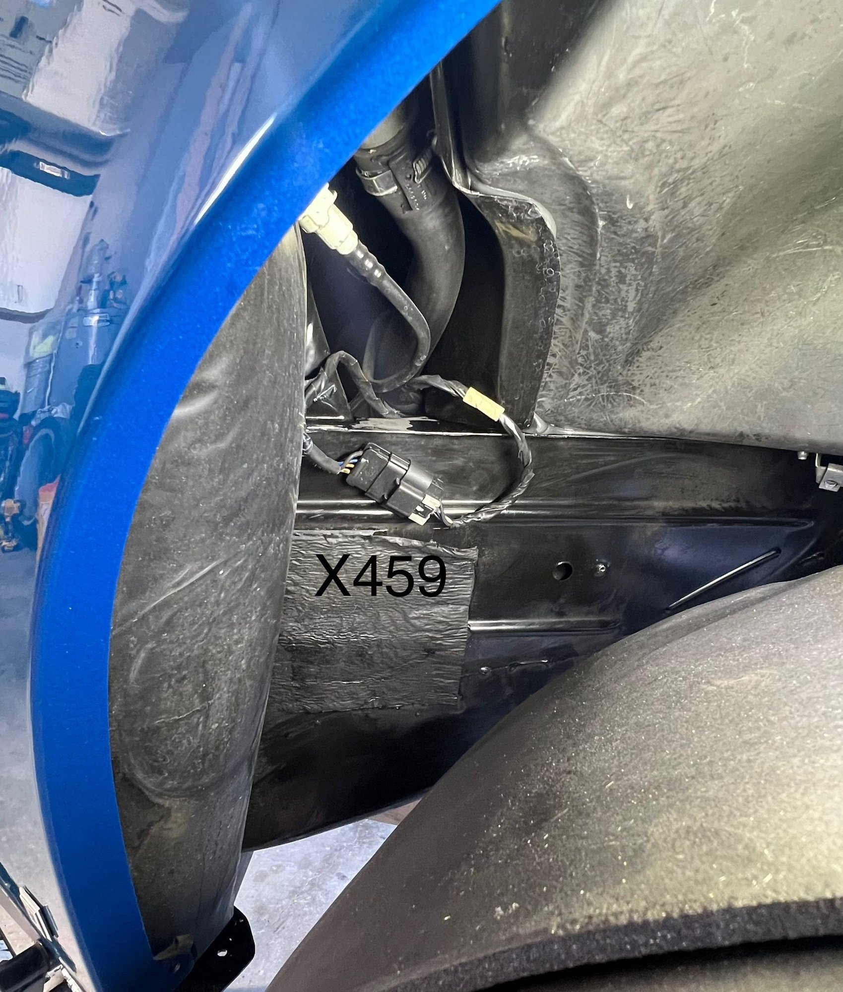

First thing the airbag module has nothing to do with the ECM telling the fuel pump to turn on…don’t know where you read that…have you removed the fuel pump relay and jumped terminals 30 and 87 which is the load side contacts…the fuel pump should run continuously…if not you need to check for a voltage drop between battery positive and connector X459 which is behind the rear left tire wheelhouse panel…the ground side should be checked as well…there are 3 connectors between the relay and the fuel pump…you can try going to X459 and give the pump power and a ground and see if it runs.

Thank you for the picture! We'll start there. Unfortunately he's out of town for a couple of weeks so it'll be a minute until we can work on it, but I'll update this thread as soon as he gets back!
