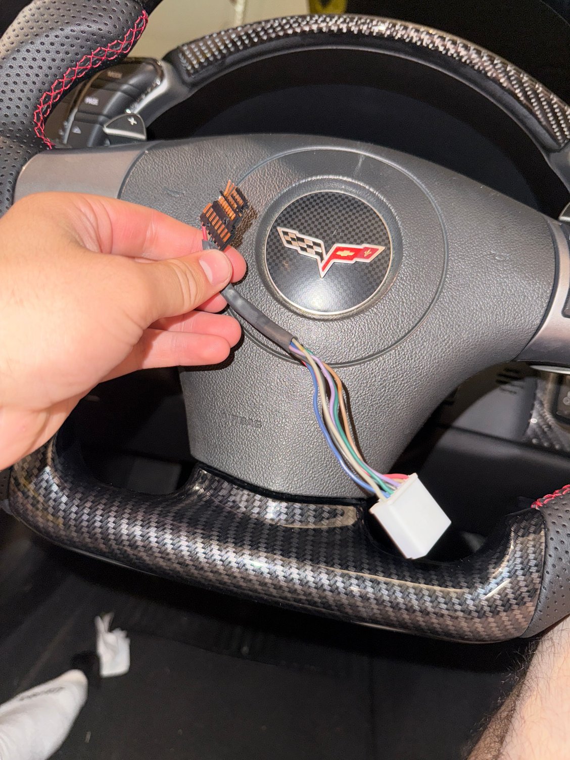

I was replacing my steering wheel and when I was taking the old one off the wiring harness got caught and ripped it out of the steering column. I’m not sure what this harness is called but it’s the one with all the steering wheel button controls and paddle shifters.

Looks like you ripped the wires out of the clock spring.You will have to replace it as the harness isn't replaceable by itself.
