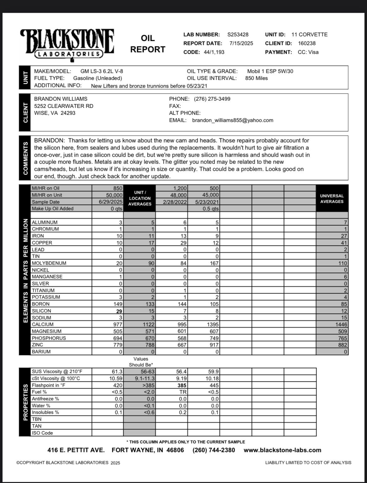

I was really hoping to get some more feedback from some knowledgeable guys about this but I wanted to update with the oil analysis report that I got from Blackstone the other day. Other than a high silicon level everything seems to look okay from the report however I don’t know how much I trust their reports when it comes to visible metal in the oil because they clearly stated that anything visible with the naked eye would not show up in the report.

The only non-magnetic metals that are associated with the engine oiling system are engine bearings and the Alum. pistons that's it everything else is ferrous metal. From the video, it looks like bearing Mat'l. Although it's possible the valve springs could be cutting into the seats but they usually have a steel shim underneath the spring. And not sure on this one, but the lifter bores are probably aluminum too. But I doubt there would be any wear there due to the precision tolerances of the lifter to lifter bore.

I have a suspicion it is aluminum but I’m not positive. I have always suspected a lifter bore issue because of a specific ticking noise I’ve had on the driver side around cylinder 1.
Even with a different cam heads lifters and totally different valve train I had the ticking noise and I can’t help but think I have a lifter bore issue. If it’s not that then yeah probably bearings.
