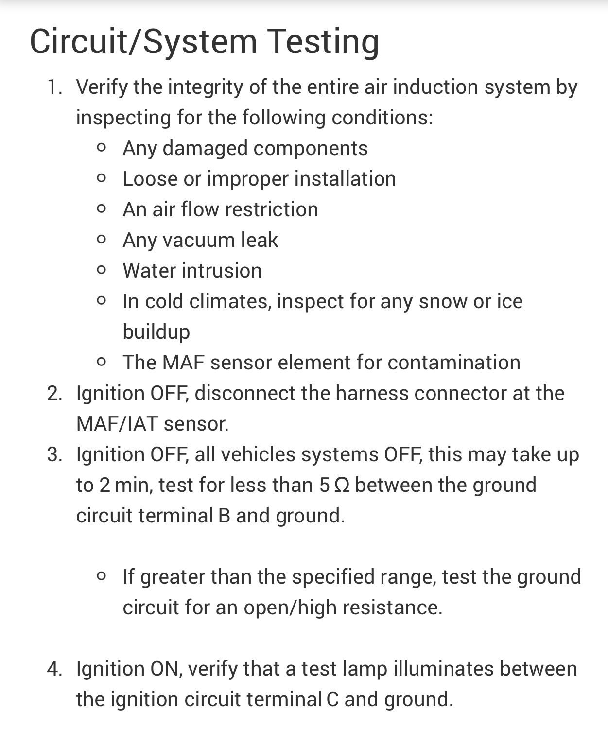

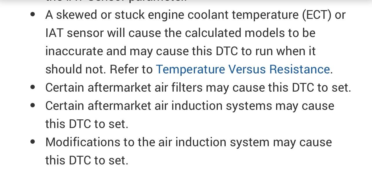

When was this Halltech installed ??…unfortunately we can’t diagnose it for you but you can read the “diagnostic aids”…I’d look at the IAT and ECT for being skewed…if you have a decent scan tool look at these data PIDS in generic OBD2…it’s the little check engine light on your scan tool…no need to enter the car model year, etc…

C5 Diag's Avatar
C5 Diag
Moderator, Tech Contributor
Posts: 15,600
Likes: 4,059
From: Cape Coral, Florida

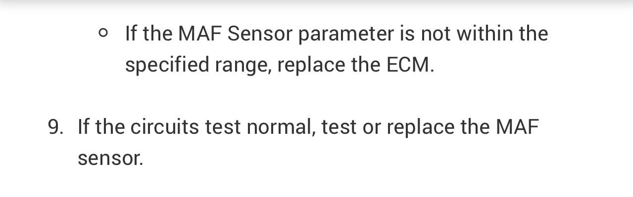

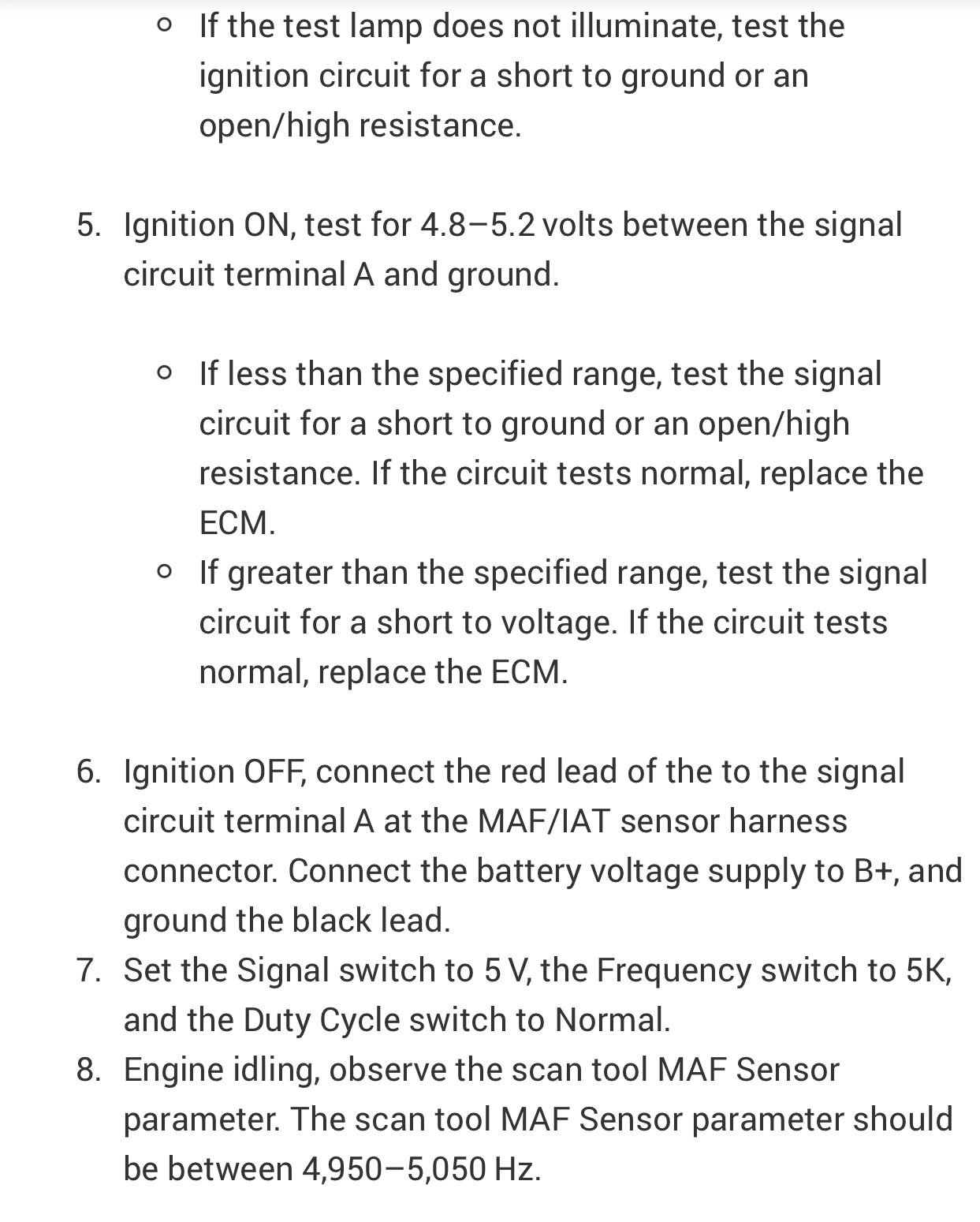

Old Jul 9, 2025 | 07:39 PM

If this wiring looks foreign to you probably best to seek out a diagnostic shop !!
