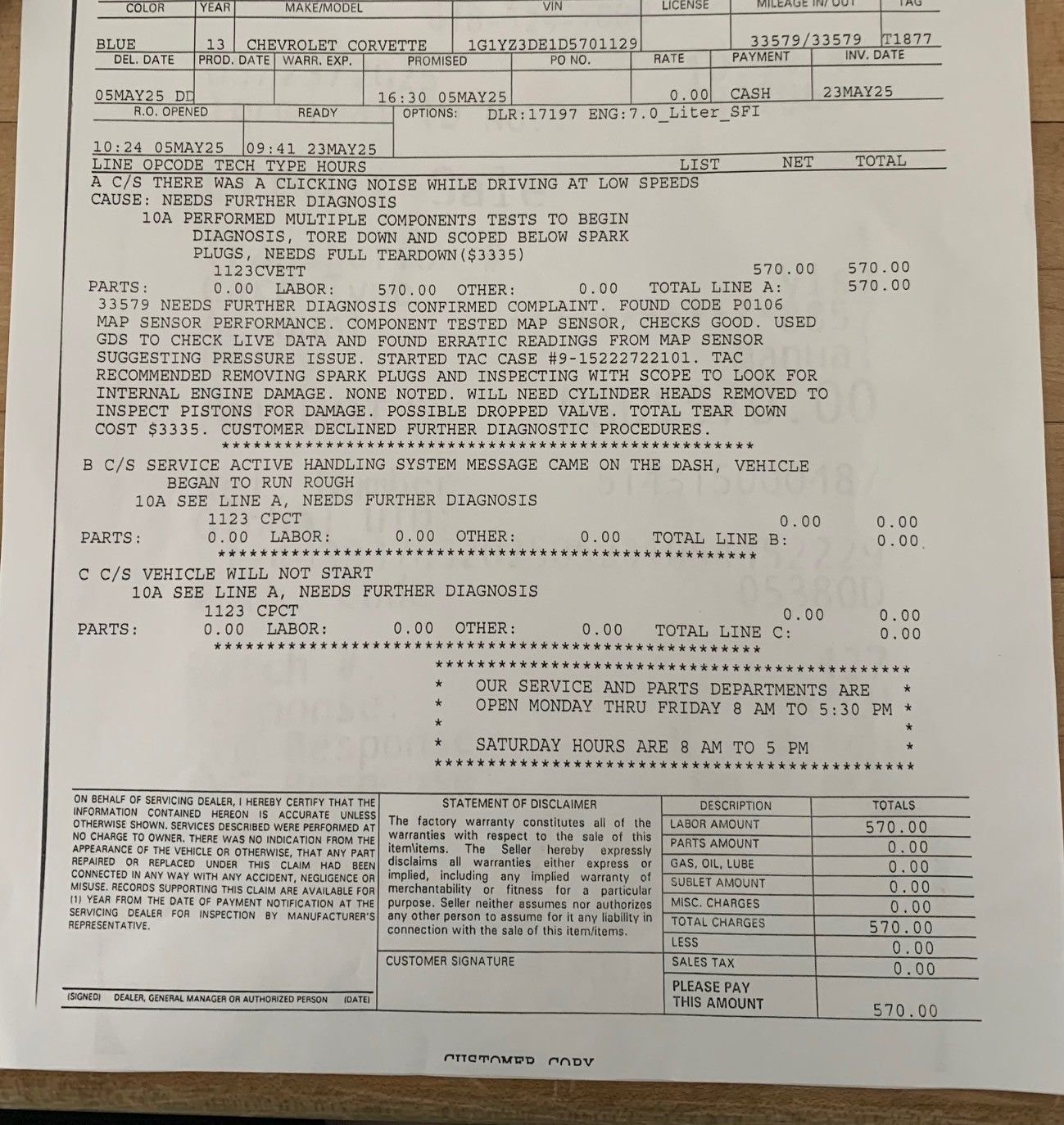

UPDATE: Went with the OP (who happens to only live a few blocks from me) to the Dealership in town where the tow truck driver mistakenly dropped his car off at we talked to the SA who was handling this ticket...below is the ticket for the dealership in Illinois where the car was first taken to. Sounds like the plugs were removed and engine scoped and "NEEDS A COMPLETE TEARDOWN" was noted...a P0106 was noted and TAC Case was opened...if the Tech could not diagnose a MAP sensor issue that he needed to elevate this that is very SAD !!...a scope was done presumably and damage was annotated as "NONE NOTED" and "POSSIBLE" dropped valve...HUH ??... if there was a valve issue that would have been clearly seen during the borescope...well, there you go another reason you should NOT be taking your car to a dealership for a diagnosis...once we get the car back to the OPs house the first thing I'll do is a full system scan after checking the battery and then pull all the plugs and look in there myself with my borescope...had 40 years of experience borescoping jet engines so this shouldn't be too hard to do...will look for any "dropped valves" or piston or cylinder wall damage...if the engine looks OK will do a quick relative compression test with the plugs reinstalled but maybe just to a "clear flood crank" and see if I can hear a low compression cylinder...if there is a low compression cylinder the in cylinder pressure transducer will be used to see what may be wrong and takes but a few minutes...worn cam lobe, broken valve spring etc...no engine disassembly...BTW, the other SA who was there said "you can't do the programming for ECM, TCM, BCM and ONLY GM dealerships can do that "...it would cost a repair shop $120,000 to be able to do that"...it was a lady who has worked there for 30 years so I didn't tell her she is full of S##T and you don't know what you're talking about...I held my tongue...will report back once we get the car out of there....oh, with the "service active handling" coming on and the car running rough sounds like a misfire...maybe that is all that is wrong with the car.

Shame, I never had anything bad to say about that dealer when I was down there for college but that's a pretty **** poor diagnosis effort for the price in my opinion.
Well if I find that this is something simple I'm going to give that dealership an earful !!
