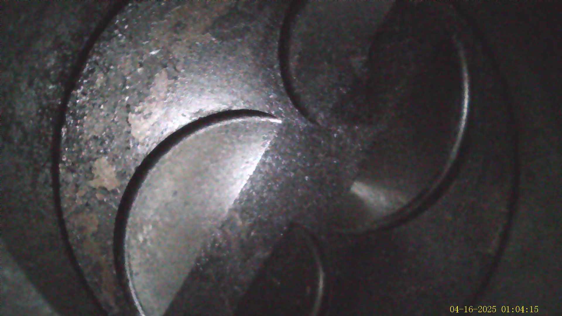

OK, so here's the story...performed a relative compression test but during cranking heard an uneven cranking cadence so was thinking things weren't going to be good....scope was synched to #1 cylinder and found low compression on #8 cylinder...did a running "in cylinder" capture with the pressure transducer in # 8 cylinder and basically no compression of 1.57 psi...since there was a P0106 for MAP sensor “performance” and dealer said the MAP reading was "erratic" I was thinking this may be related to an intake valve possibly....removed the valve cover and quickly noticed a broken valve spring along with some roller rocker needle bearings present on # 8 intake valve...there is a TSB if any are found in the oil pan during an oil change...the diagnosis took less time then posting this...LOL !!…so no “dropped valve” or new engine that the dealer said this car needed…INCOMPETENCE !!
Relative Compression with Low Compression #8 Cylinder
Relative Compression with Low Compression #8 Cylinder #1 Cylinder Sync
Running Compression - 1.57 psi
Piston Dome No Damage Observed
Broken #8 Intake Valve Spring

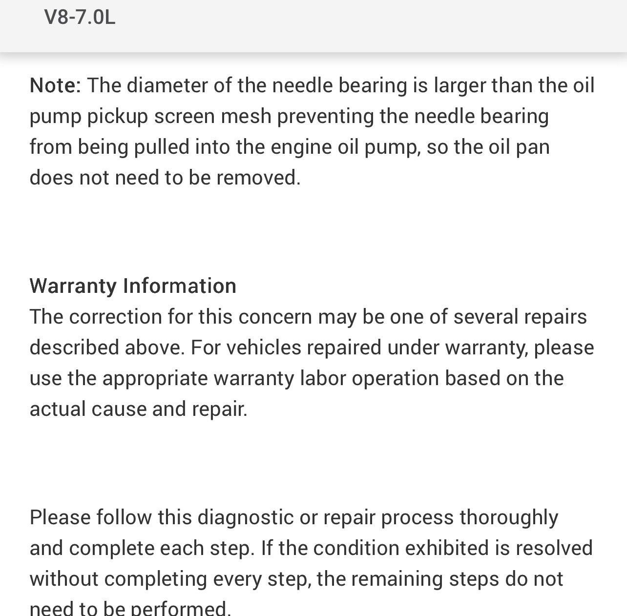

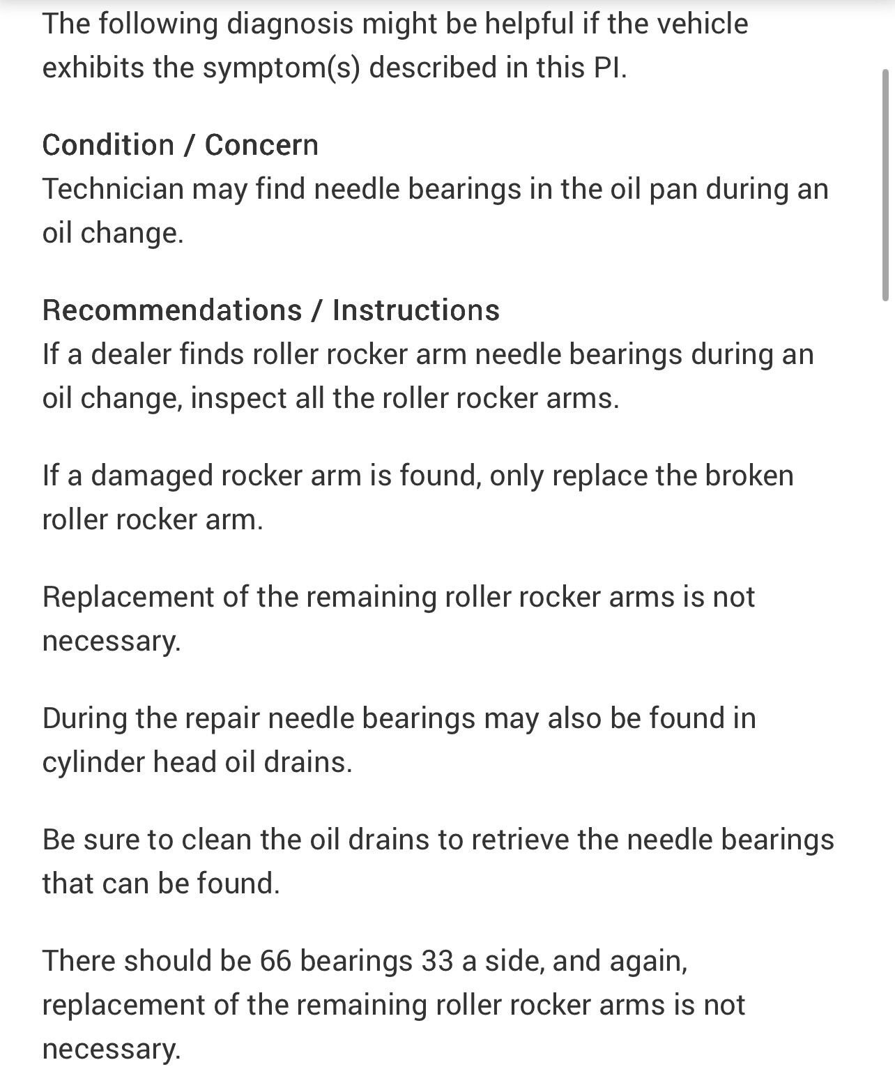

Needle Bearings
Needle Bearings
TSB For Needle Bearings Found in Oil Pan during Oil Change
