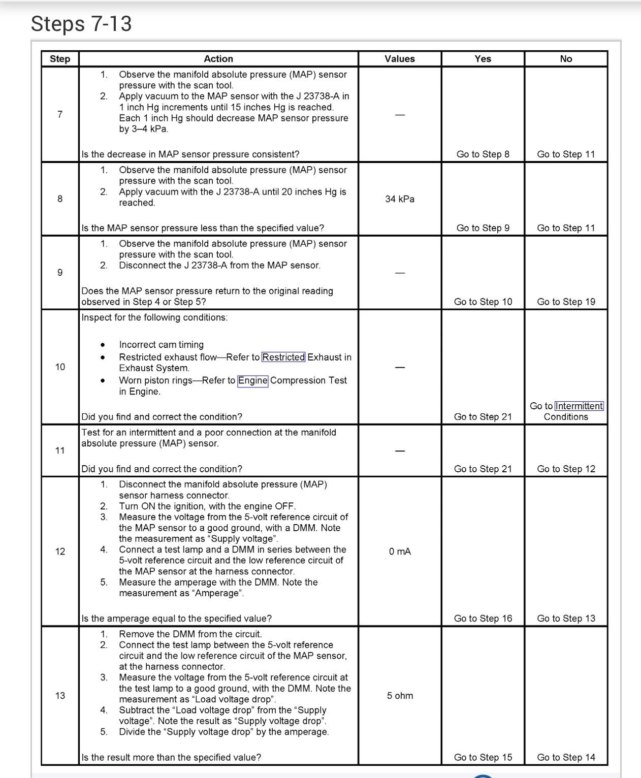

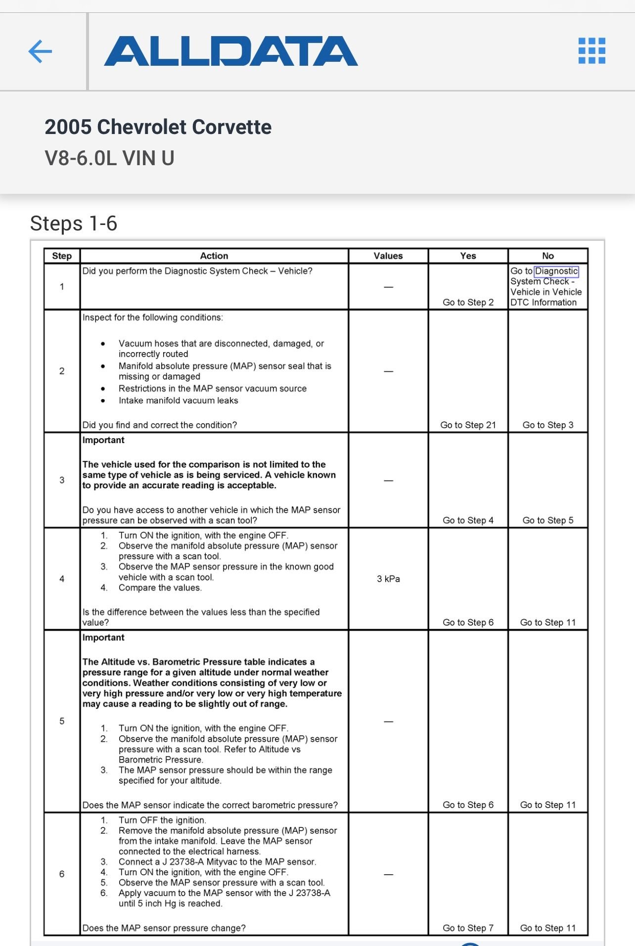

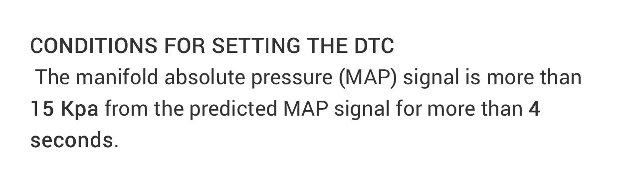

From: Cape Coral, Florida
A P0106 is a MAP DTC and yes the fuel injector “on time” will be altered which is not far off from fuel pressure and will make the car stumble and die…15 kPa is a little over 2 psi…to make sure your MAP sensor is not “skewed” the MAP/BARO with the Ignition ON should read 101kPa/ 29.9 inHg/ or 14.7 psi…if your scan tool can graph the MAP sensor reading I would do that while you ride around in the car…so the car dies for 10 seconds suddenly and then comes back to life ??…need a little more info…what is a “reliable source” that you are looking for ??…a shop ??…I know of an excellent diagnostic shop but they are 3 hours north of you outside Tulsa…BTW, the battery is what powers the ECM “keep alive” memory…all modules have an ignition feed or “wake up” signal and the KAM or keep alive memory…it’s a big difference between working on car for 50 years vs diagnosing them…2 different skill sets completely…also thinking maybe some intermittent communication issues…gotta test and not shotgun parts…are you using a “code reader” or a good scan tool that can read ALL modules ??

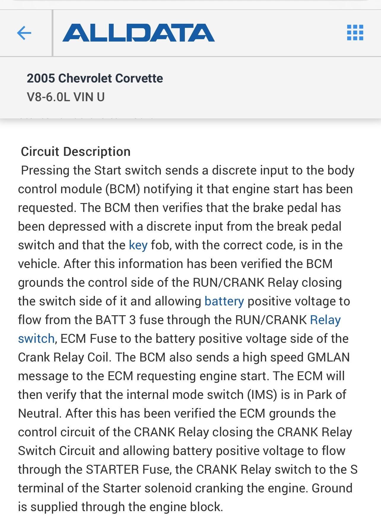

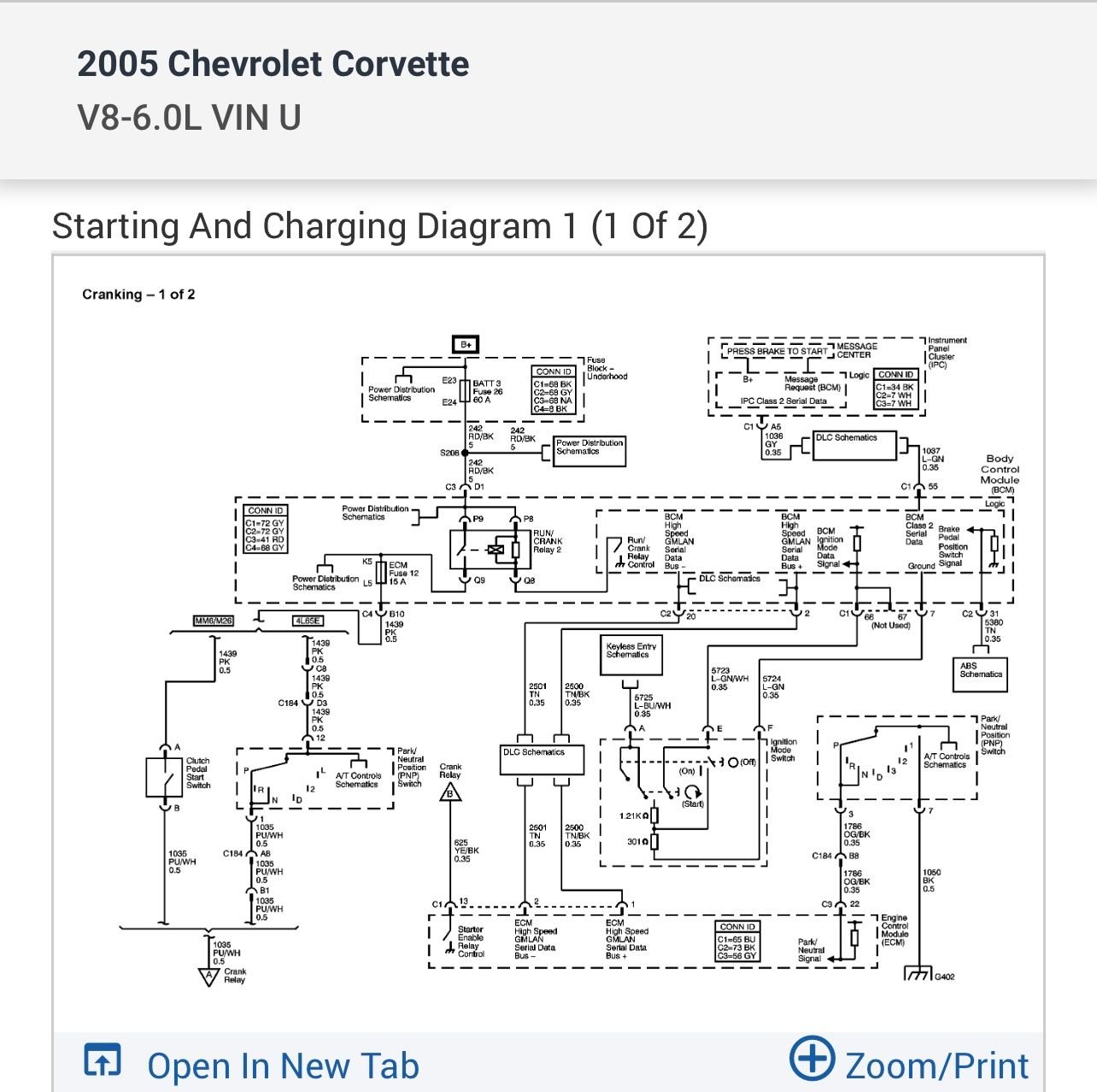

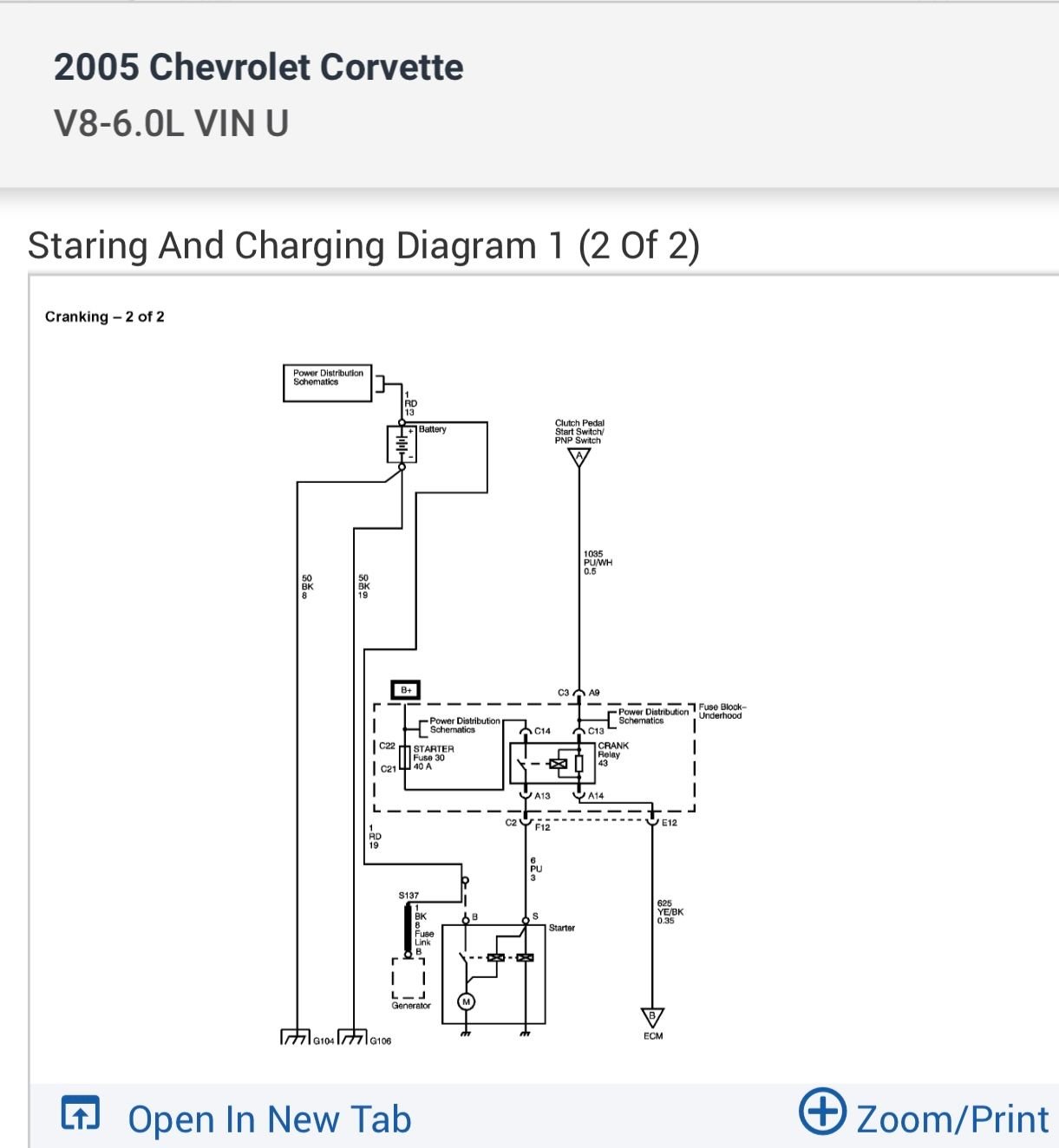

To answer your question there are companies that bench test ECM’s like Flagship One (not recommended) and other companies but Google is your friend…I seriously doubt your ECM is bad…there are 2 relays…the RUN/CRANK Relay which you changed and the CRANK Relay…different inputs which will activate both of these…starting description below…I would go back and check all the connections you had disconnected during your transmission repair…when you say you “checked your grounds, battery connections” etc visually checking is not the best way…you have to test with either a DMM, test light or load light…let us know if you find a fix…there is no “silver bullet” here unfortunately…you never did say if you looked at that MAP sensor since a skewed MAP will cause the car not to run…if the car thinks it’s at 20,000 ft in altitude or 20,000 feet below sea level it’s not going to run right.
