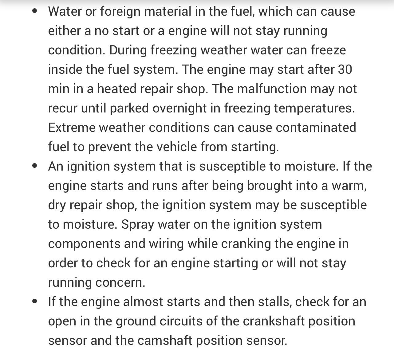

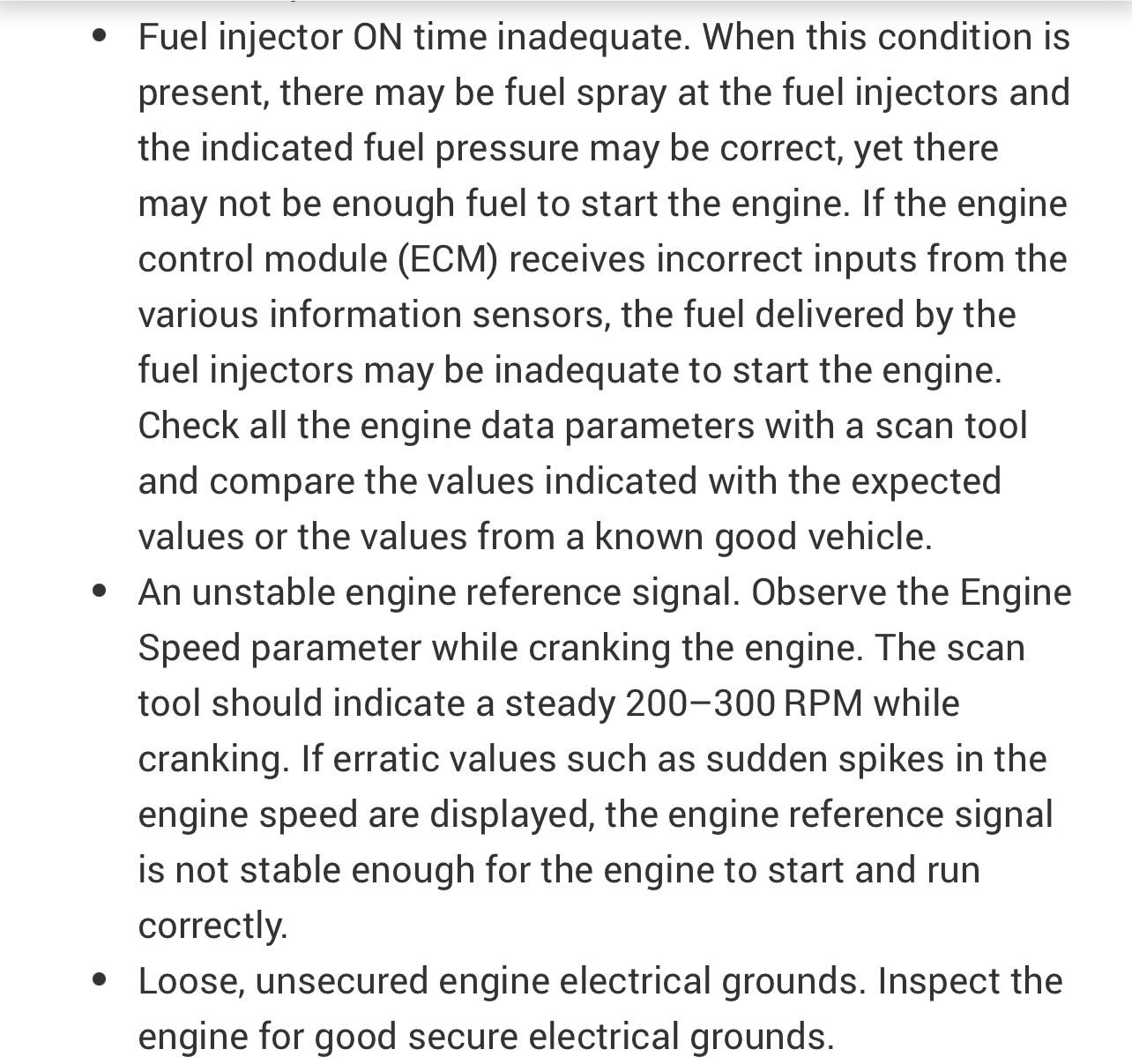

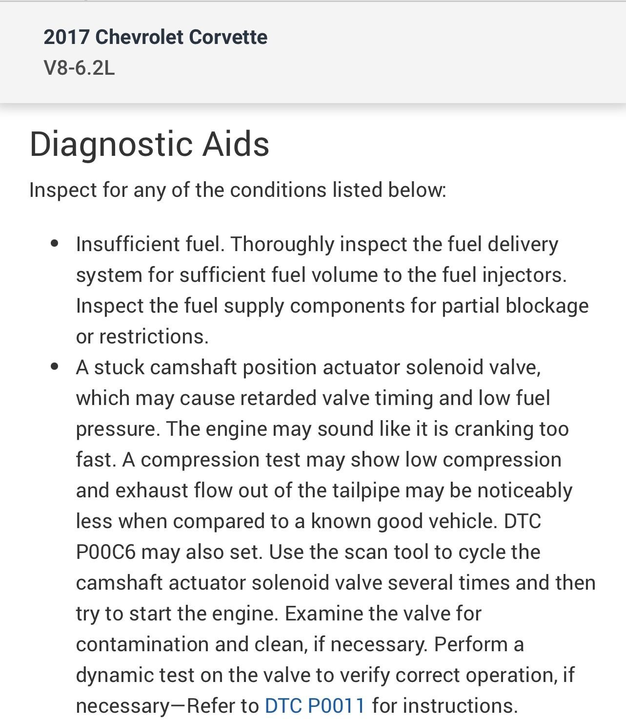

Old Jul 31, 2025 | 12:56 PM
C5 Diag's Avatar
C5 Diag
Moderator, Tech Contributor
Posts: 15,604
Likes: 4,060
From: Cape Coral, Florida
Here are some diagnostic aids if you are attempting to diagnose this yourself…moving this to C7 Tech for discussion !!…OP, do you indeed have a 2017 ????

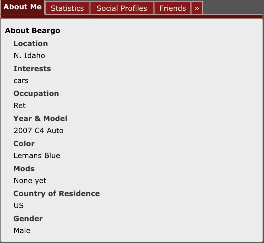

Originally Posted by Beargo
I have a 2017 C6 base model 6L
this morning it turns over when I push the start button , turns over good no start. Let off the start button and the starter keeps turning over the engine, push the stop button and it quits.
First thing I try is disconnect the battery for a while...No help. Check all fuses....no help . switch around relays of same part #. still no help.
There has not been any electrical work of any kind prior to this. I welcome any ideas that anyone may have.
Do you have a 2017 OR 2007 ??????…I moved this back to C6 Tech…can you enter the correct year.

Great !!…To avoid confusion down the road can you edit your profile ??

Don't know how 2007 c4 got in there....It's a 2017 c4 base model.
If Corvettes are new to you the 2007 is a “C6”….a 2017 is a “C7”…what is a model “6L” ??
