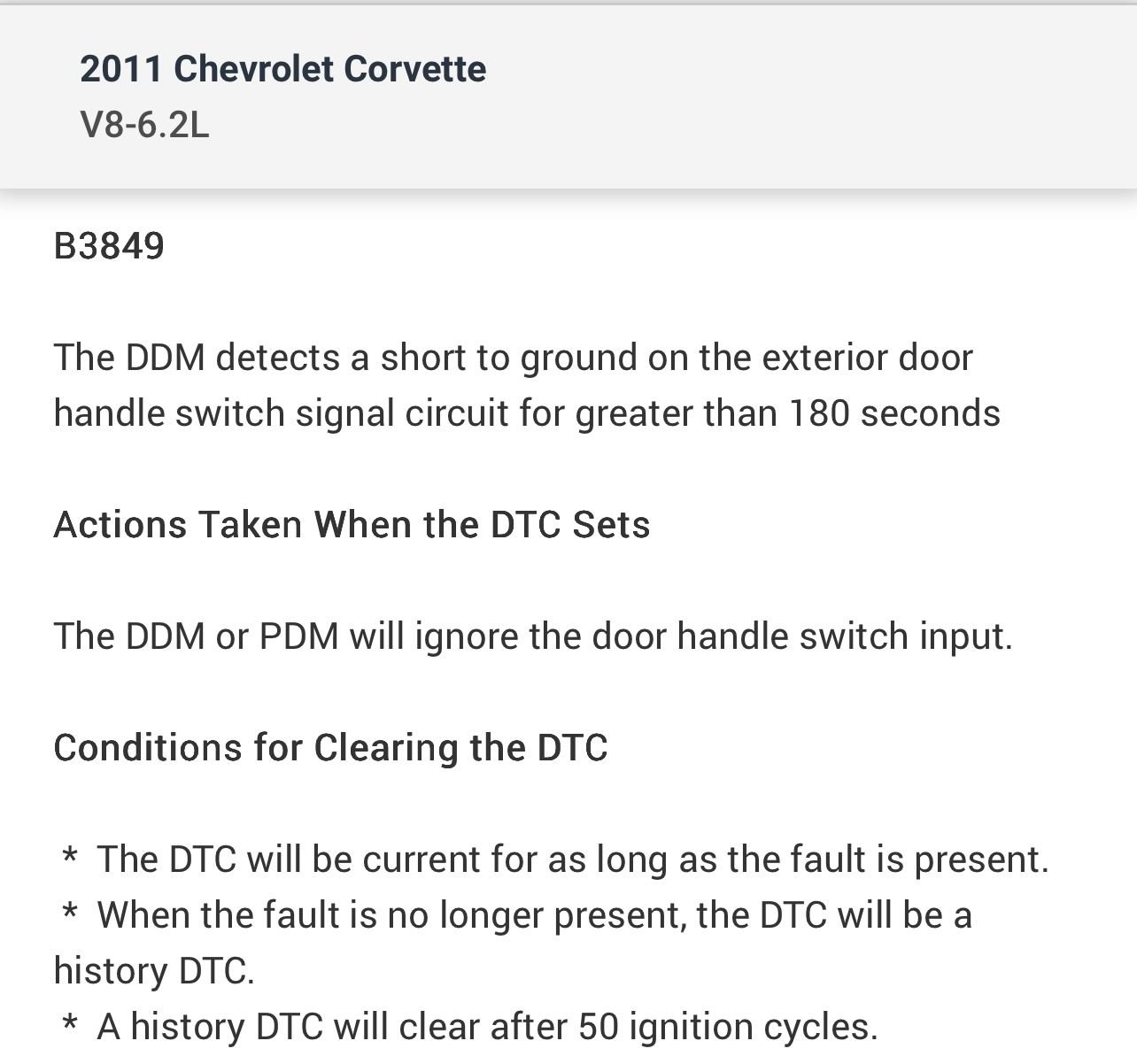

The code I’ve gotten a few times is B3849, which seems to indicate a ground issue. I’ve cleaned the grounds in the engine bay, cleaned the driver exterior door pad and di-electric greased it. Would my next test be to take off the interior door panel and check the interior door switch connections and module connection (I hear it’s in the door panel)?

A B3849 is a ground issue but it’s a “short to ground” issue on the signal circuit in the Driver Door Module so cleaning engine grounds or cleaning the door pad won’t fix this…do you have any electrical diagnostic experience beyond changing a fuse ??…if not I would seek out an auto electric shop in your area…you have to know what sets that trouble code before trying to diagnose it.

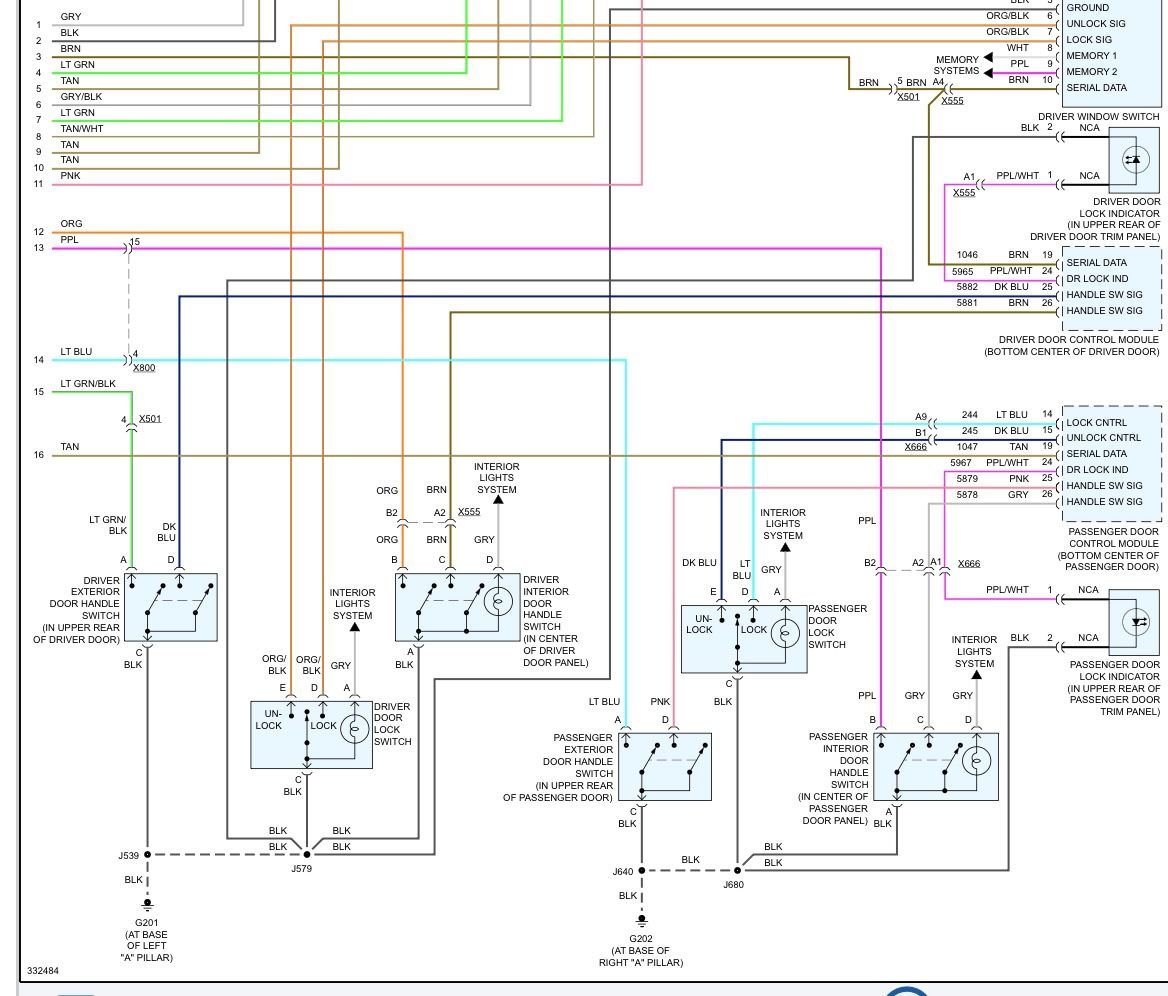

You may have a “short to ground” on either exterior or interior door switch from the DDM circuit 5881 or 5882…dark blue or brown wire…this may also be a bad switch or door module.

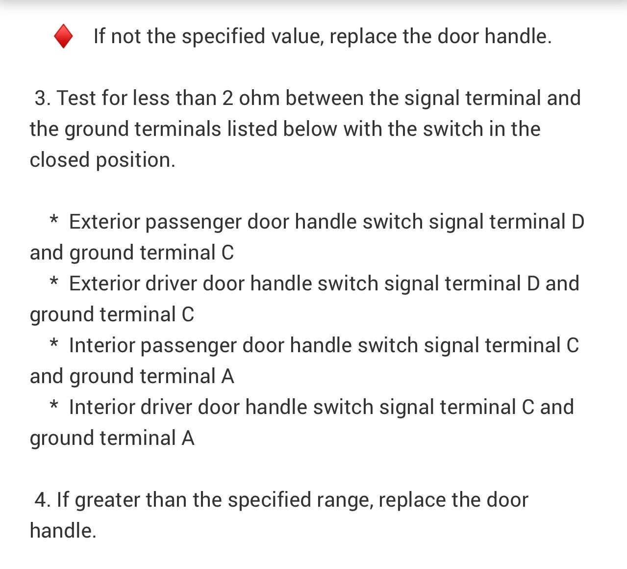

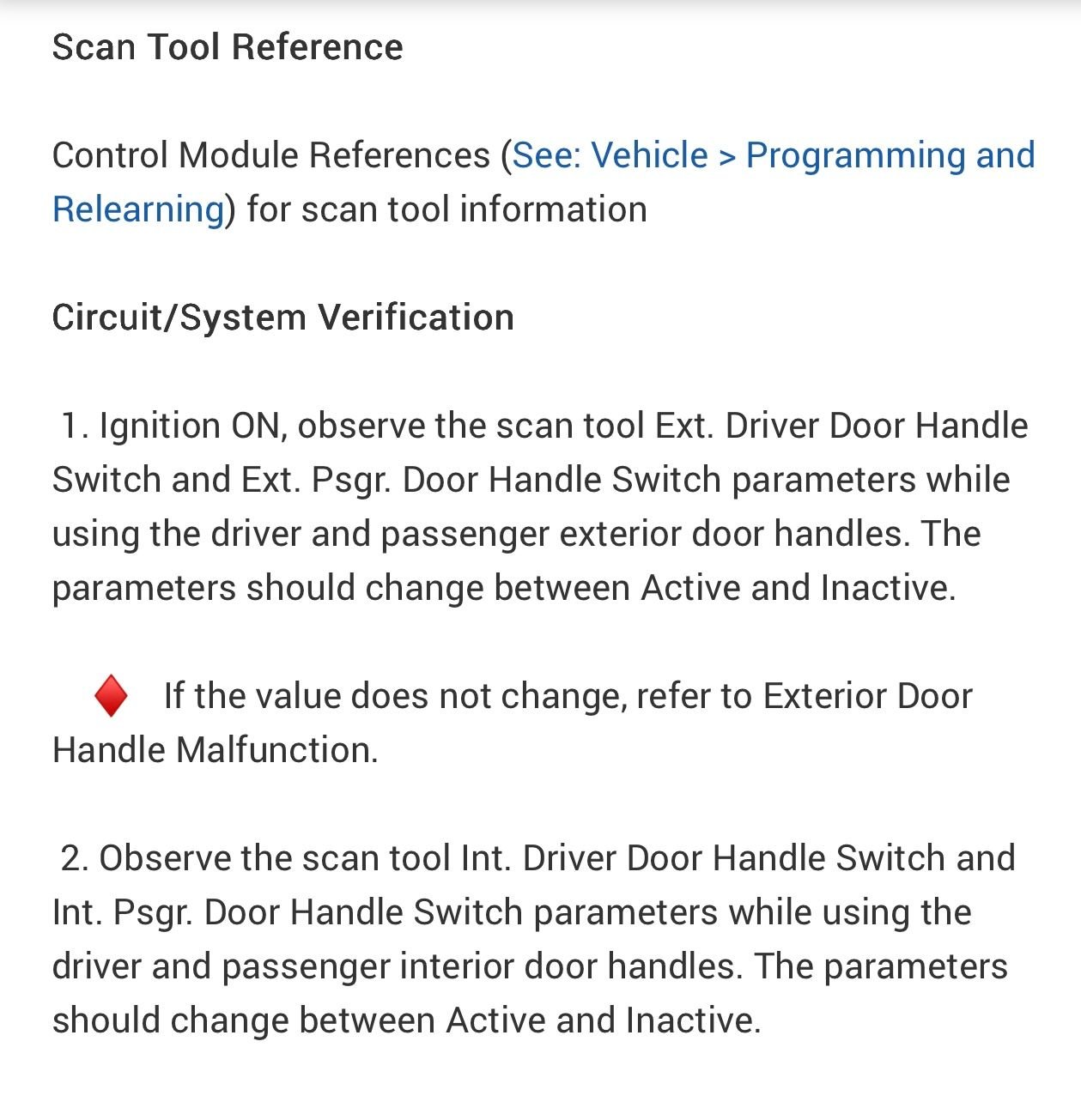

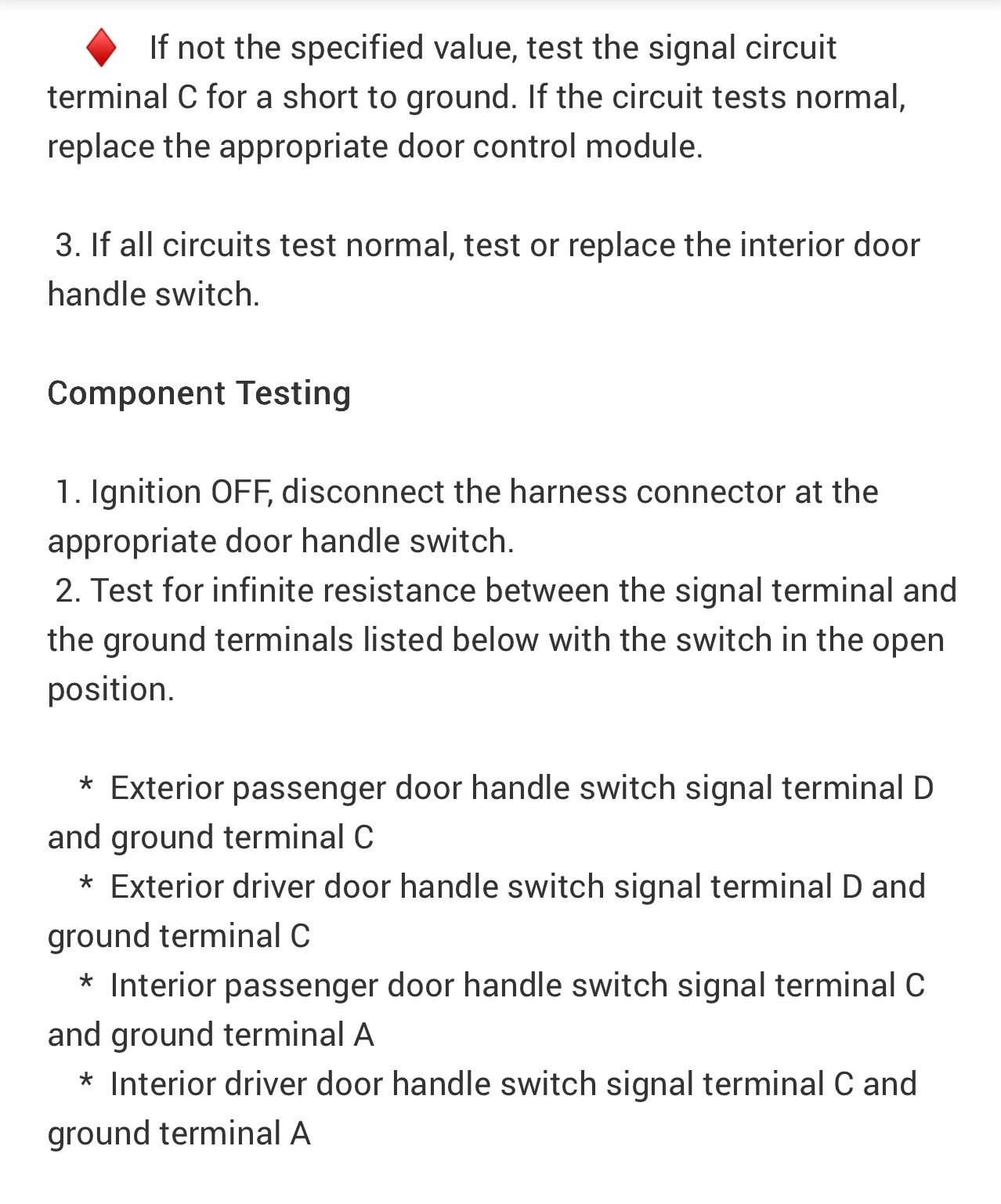

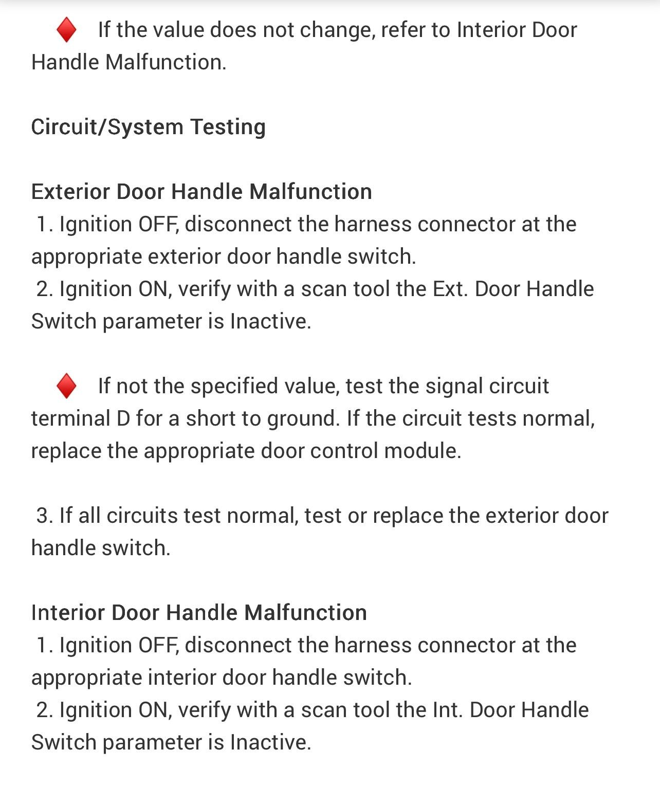

With your scan tool you should be able to observe the inputs as shown in this flow chart…you don’t need to worry about cleaning and dielectric grease for now.

I used the tool to check both the interior and exterior door handle active/inactive. And they both worked properly. So I couldn’t get them to mess up in that regard. I will go through the rest of the steps as well though. Thanks for sharing this.

I guess now it’s down to tracing wires to see where the short is. The fuse for the driver door switches seems to be in the passenger footwell. Would I need to pull that BCM to see the pins on the back and follow the wiring?

I have no idea what testing has been done but have you tried unlocking the door on the "OUTPUT " side with the scan tool ??...that bypasses all the inputs...you should hear a “click” coming from the BCM when doing this driver door unlatch…I don't know where in the flowchart you are now but if it says check the signal circuit BOTH ends of that circuit have to be disconnected...door switch and Driver Door Module...disconnect the module and switch and with a test light connected to battery POWER touch the test light to the brown wire (terminal C)...if the test light illuminates you have a short to ground...if you have a bare wire the test light will find a ground through that bare wire and the test light will illuminate...this isn't a fuse issue so just try to read the wiring diagram...this is just for an interior switch issue.
