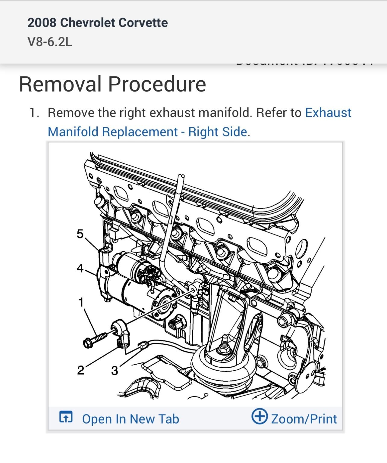

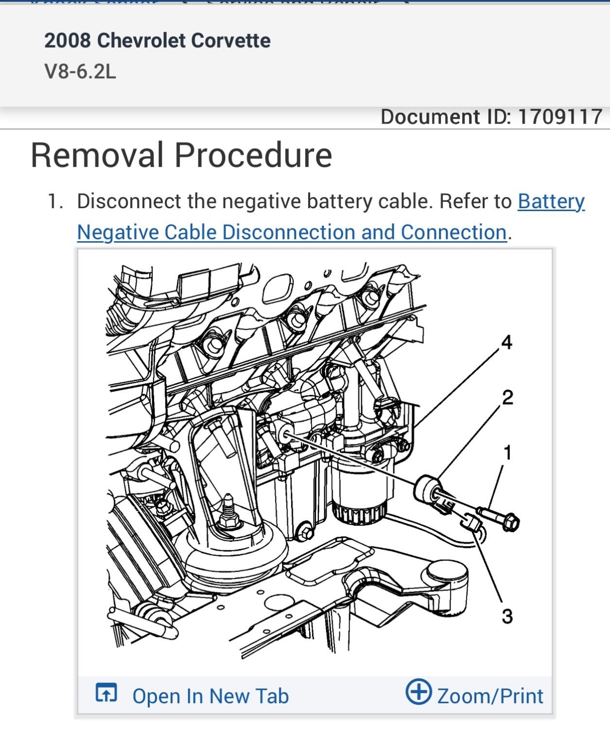

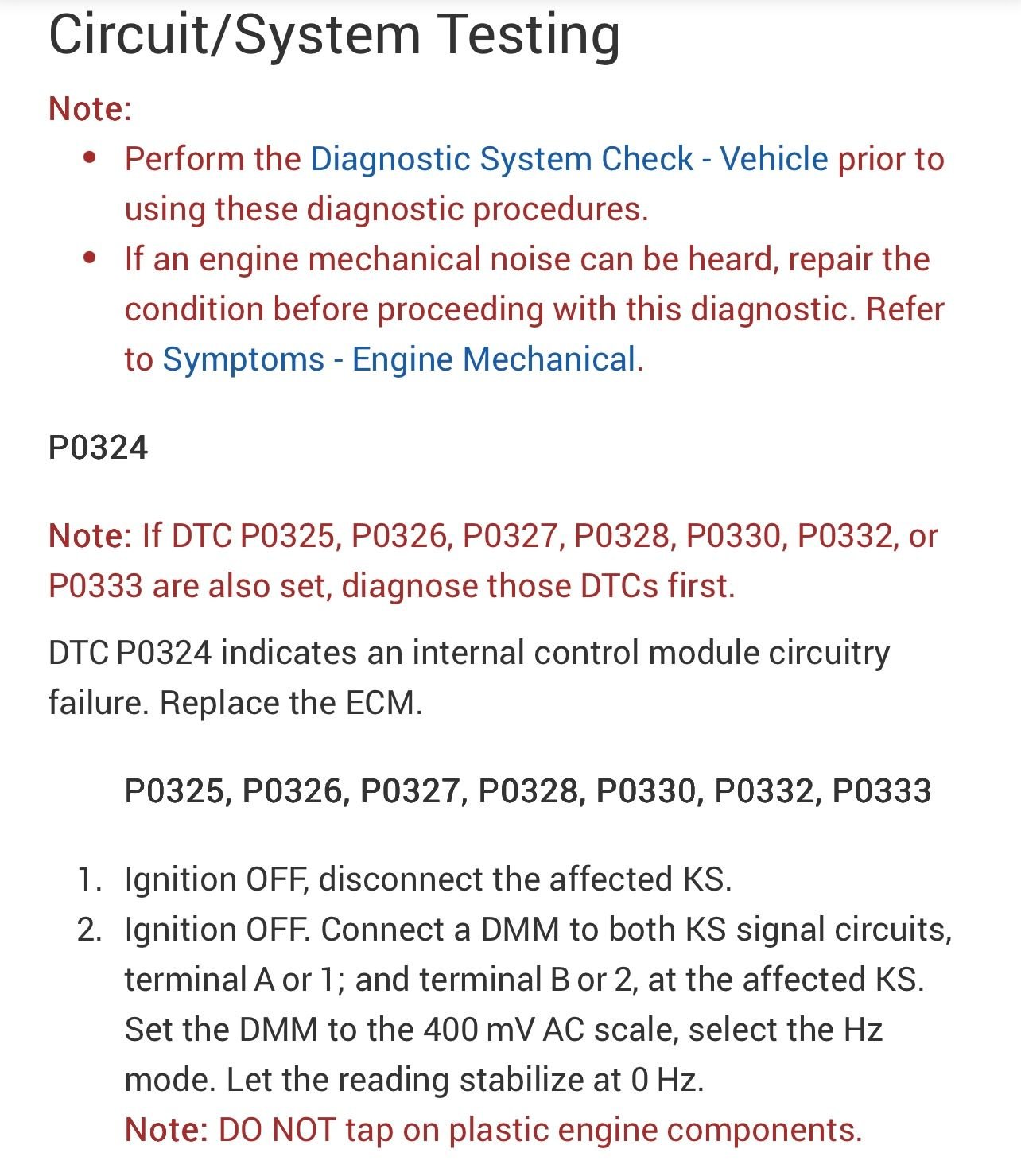

I regularly get a knock sensor error (P0325). Where exactly is the sensor located on the LS3? I want to locate it and check it.
