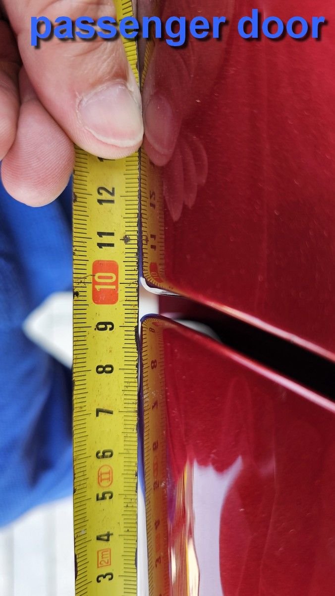

I tested the door switches and swapped them between the left and right doors, but unfortunately the problem is still on the driver’s side. After taking a closer look at the doors, I noticed that the driver’s door is not aligned properly (it sticks out a bit and there’s a slightly larger gap between the door and the fender). The car hasn’t been in an accident, so it’s probably just an adjustment issue — but how do I go about fixing it?

To adjust the door, you have to loosen the door hinge bolts on the upper and lower hinges and shift the door around as needed and then retighten the bolts. It is pretty much a two man job. You could just take it to a body shop and have them do it. They will probably do it while you wait and it won't cost much.

I understand that I can adjust the position of the door by regulating the hinges, but can the door sticking out also be adjusted with the hinges? They are clearly sticking out (not closing properly), as you can see in the third picture.

A new problem appeared: if the door doesn’t close properly, it can open while driving. I can also open it by hand without pressing the handle. If it latches well, it’s OK and holds. I’m still looking for a way to adjust the door that sticks out by the rear fender; it’s all visible in the video.
