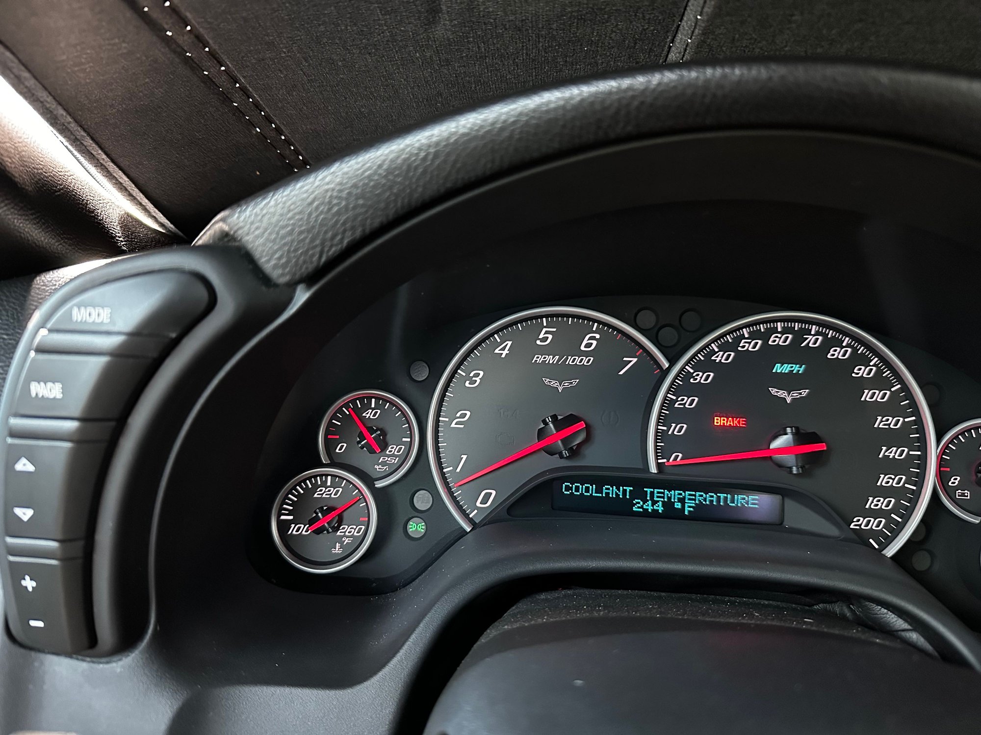

so my first vette, and I need to know if I am reading into my company temps or if there is really an issue here. I know they like to run hotter.
Base c6 auto. Had the engine rebuilt earlier this year, new heads, cam intake, shorty headers stock cats, all engine accessories, belts, hoses,TB, intake, coils, fuel injectors were all new. Did a dewitts fan with internal trans cooler, and an external oil cooler.
got the car back during the winter and didn’t notice anything temp wise. When driving the temps are ok hovering around 195-205. Come summer (Houston area) temps would climb up to 220 is city traffic. I got caught on the highway at an accident where no one was moving and after 10 minutes the coolant temp was over 245. The heat index was 103 on this day Luckily traffic started moving. I was able to replicate this in my driveway to verify. Replaced the thermostat 160, and it got better, after 10 minutes at idle it got up to 227 but the heat index was only 93. After 20 minutes, it was pushing 237. Had a combustion test done, checked for leaks, and no issues there. So in my mind the only thing left is the water pump, correct?
and yes the condenser and new radiator fins were cleaned out with air and water for any debris.

100 degrees out, stopped, with the A/C blowing -- it doesn't sound like anything's wrong. Thermostat will only prevent your car warming up.

Strongly disagree. 245 is not normal under any circumstances for a non-boosted engine in Houston, even with 103 heat index stuck in traffic.
To the OP, are you running a Dewitts radiator or just their fan setup? I'm guessing the radiator but want to be sure. How much have you driven the car since the rebuild? Any change the coolant system wasn't bled properly?

Agreed. Even here in ATX, I hover around 210-220 in traffic. I think that the only time I saw 240+ was when my water pump failed and my rad had a leak. In fact, back in July, doing some troubleshooting and had the car running in the drive way for about 10 mins. No issues with temp.
OP - coolant level good? Did they actually use coolant and not straight water? Could be an air bubble somewhere as well. Going to PCMusicGuy's last comment about the system not being bled properly, this would be a good place to start.
