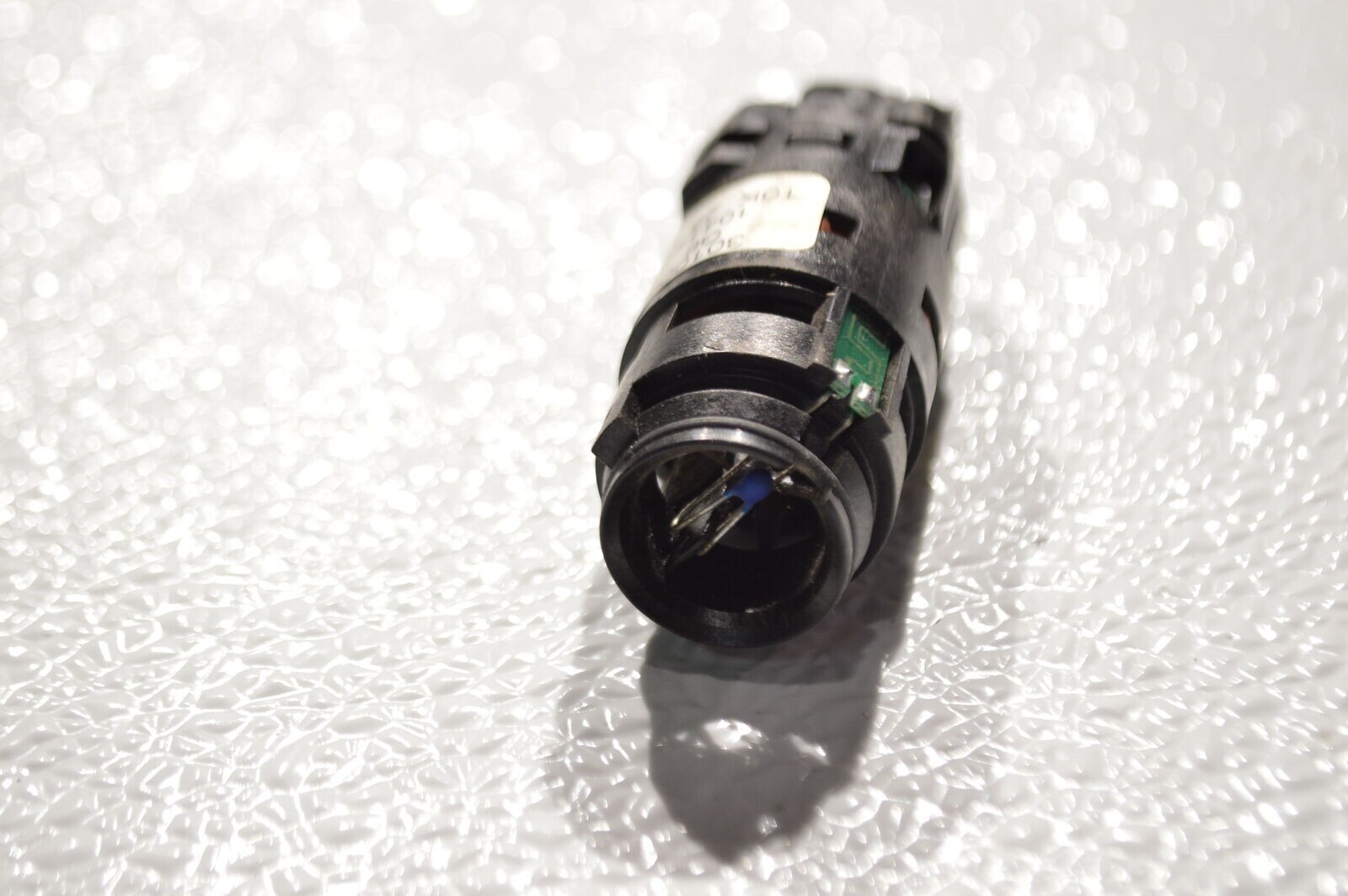

The cabin temp sensor is located to the left of the starter button, behind the slots.
https://i.ebayimg.com/images/g/UioAA...Py/s-l1600.jpg
So for starters, break out a flash light, shine into the slots,and see if you can see the end blue thing on the sensor just behind the slots.
If no, then the rabbit hole of pulling the bezel to pull the sensor out of the bowels of the dash, snap is back on to the bezel, and when you are snapping the bottom of bezel back in, make sure ot does not pop back out.
Skip down to post 10.
https://www.corvetteforum.com/forums...ton-start.html
Also, the sensor has a fan in it it to draw air, so if you do need to pull the bezel, canned air is a good way to blow the dust off the fan so it can draw more air in the first place, or just replace it if you can find one in stock. GM10444273 or SMP AX104.

THANK YOU for this write up. I've have some things to checkout and pull out that sensor to check it out and it clean up.
But with so low mileage on this car it doubt its clogged with dirt.
Unfortunately, that temp sensor part is discontinued, so if it's pooched, then i'm screwed
