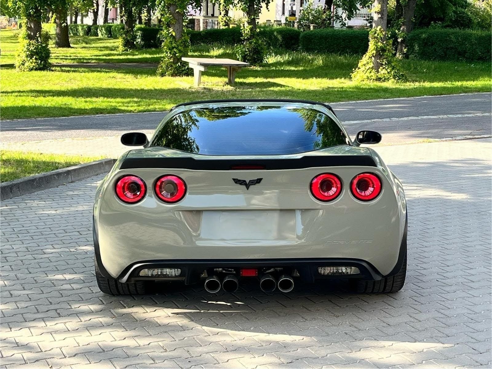

Hello, my name is Tony, i'm 34 years old and i come from germany and i hope i can get help here. I love 2 seated, american cars and because of that i drive a 2013 C6 GS with AT since over 2 years. Now i need new catalytic converters and i heard from green catted x pipes. Is there any experience or does anyone know whether I can pass the emissions test with the catted x pipes here in Germany and if so, are all of the x-pipes 3“ or are there 2,5“? My C6 has the Euro5 standard, which i need for general inspection and emissions test. Here are some pictures from my C6

I believe your tail lights are not all in the correct locations. Swap your inner right and left lights.

That is correct.
it is fixed.

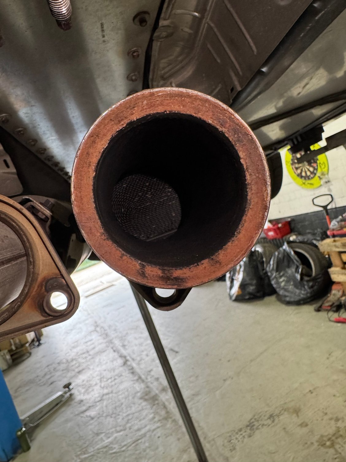

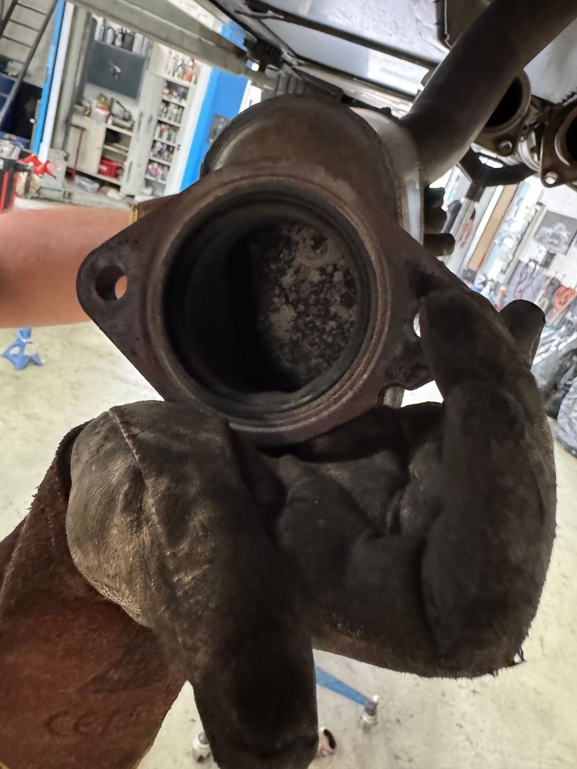

So, this is how the pre cats look like. Now they are empty and i wait for the Z06 parts.

Is that a GM color for Europe or a wrap? I've never seen a C6 painted that color.

From: Germany
Thats a wrap. The brand is Arlon and the color is khaki green gloss.

Nice! Are those the Infirai tailights? (Red with dark center)

Yes, the light smoked and in the correct position now

As for pre cats, looks like someone ran leaded fuel in the car to cause the build up on them, which could have take out the post cats as well.

Yeah, i ordered everything for it, Z06 manifolds, H-Pipe, downpipes with cats, all gaskets and reducers from 3“ to 2,5“. I don‘t know, since i have the car, about 2,5 years, i fill up V-Power from Shell. The mechanic said the inside of the cats were crumbling… now they are empty and i wait for the z06 parts. But the sound is so damn good now and 100-200 in 9.2 sec. Thats good for a stock GS i think. Ok, without pre cats.
The posts cats are ok i think.

My first thought was, that car is Gorgeous!
My second thought was, I do not recall having seen that color.
Did I mention your car is gorgeous?
Glad you got your problem sorted out.
