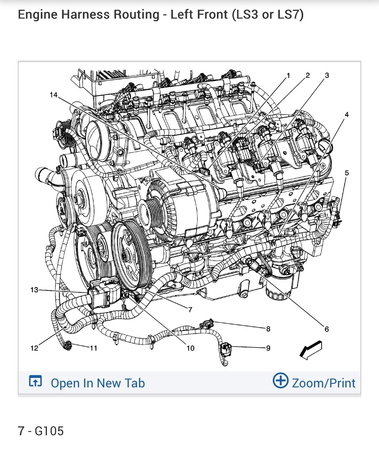

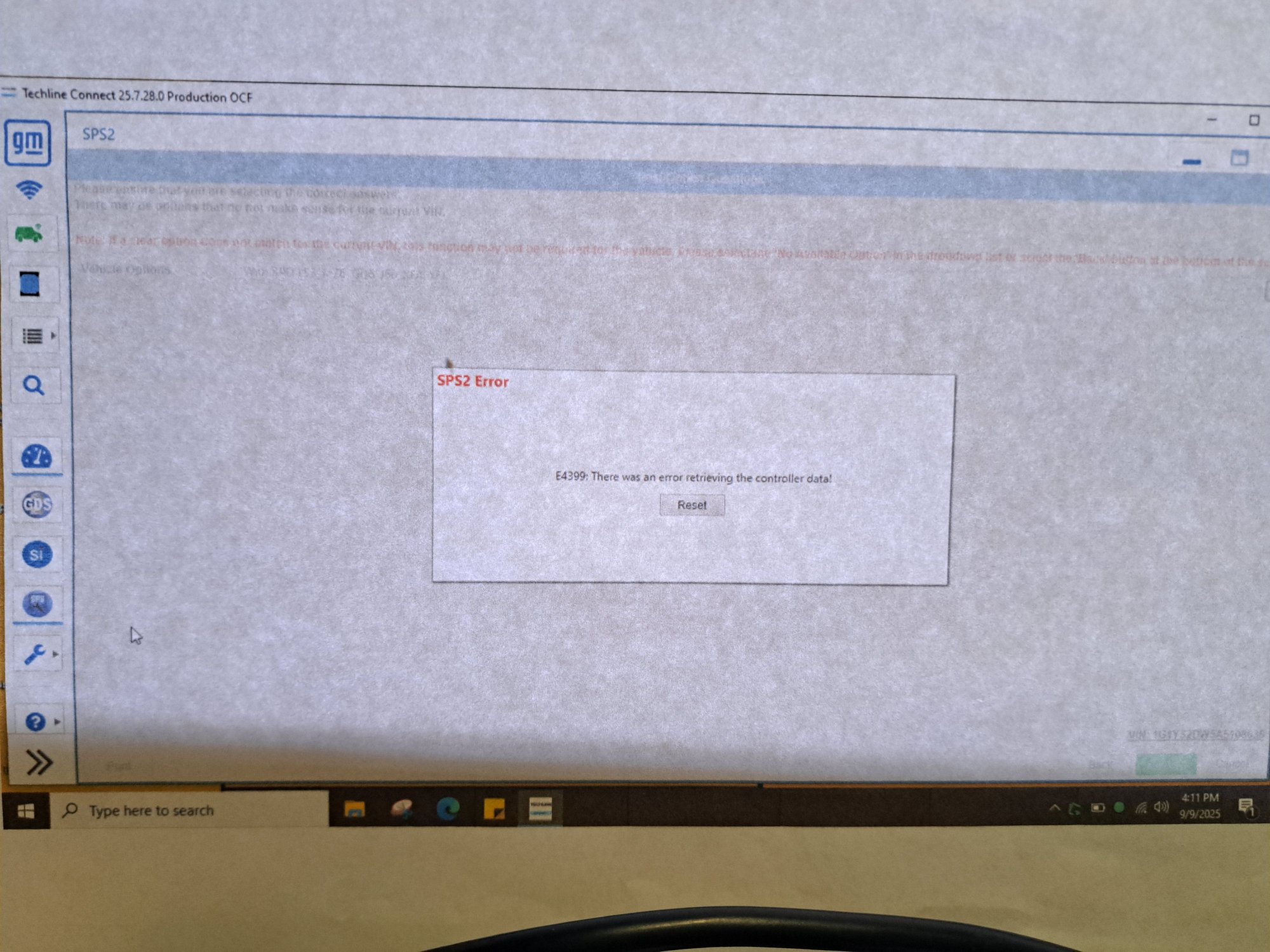

The shop changed my power steering pump and brake pump, which fixed some of the issues I was having, but they were unable to clear the code entirely. They brought a specialist in to scan the car and found all the fuses to be fine, but for some reason the ABS doesn't want to communicate with the car. Their best deduction was that it was a ground wire located in the back of the engine labeled G105 (I've attached the info they gave me about this). Any ideas where this is at? Or, any ideas what else may be causing all of the lights to come on? I planned to get it tuned soon to level out the kinks, but I would like to clear these lights eventually, just for peace of mind if nothing else.

For ANY module "no comm" the first thing is to check all the power and grounds to that module...was that done ??...and yes, that sounds about right...these idiots just replace parts and hope for the best...is this something you are going to try and diagnose yourself ??...if this testing is over your head find an auto electric shop in your area....was the new EBCM programmed ??...it's not plug and play.

Check the G105 ground—it’s on the rear driver-side cylinder head near the firewall. Make sure the ring terminal is clean, bare metal, and tight. Also verify ABS module and wheel-speed sensor connectors, plus the main battery grounds to frame/block. Pull the CEL code when you can; a U- or C-code will confirm a communication or ABS fault. Those three lights often clear once G105 is cleaned and tightened.
Where did you get your service info saying G105 is on the rear drivers side cylinder head ??…also just checking that a ground is “clean and tight” is not how a ground is checked…what if that ground wire is broken 1 inch from where it’s bolted to ??
Okay, I'll get back there this weekend and check it to make sure. If that clears everything up, I'll be in your debt, lol.

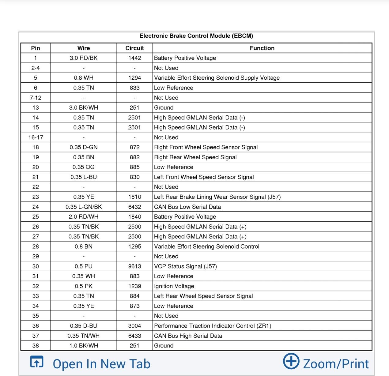

You need to checks both powers and grounds…you can check these with a headlight bulb and NOT a DMM…below is EBCM pinout so you check anything that says battery positive voltage and ignition power and both grounds…if you are not familiar with how to test these and how it is done with a bulb see a specialist.
