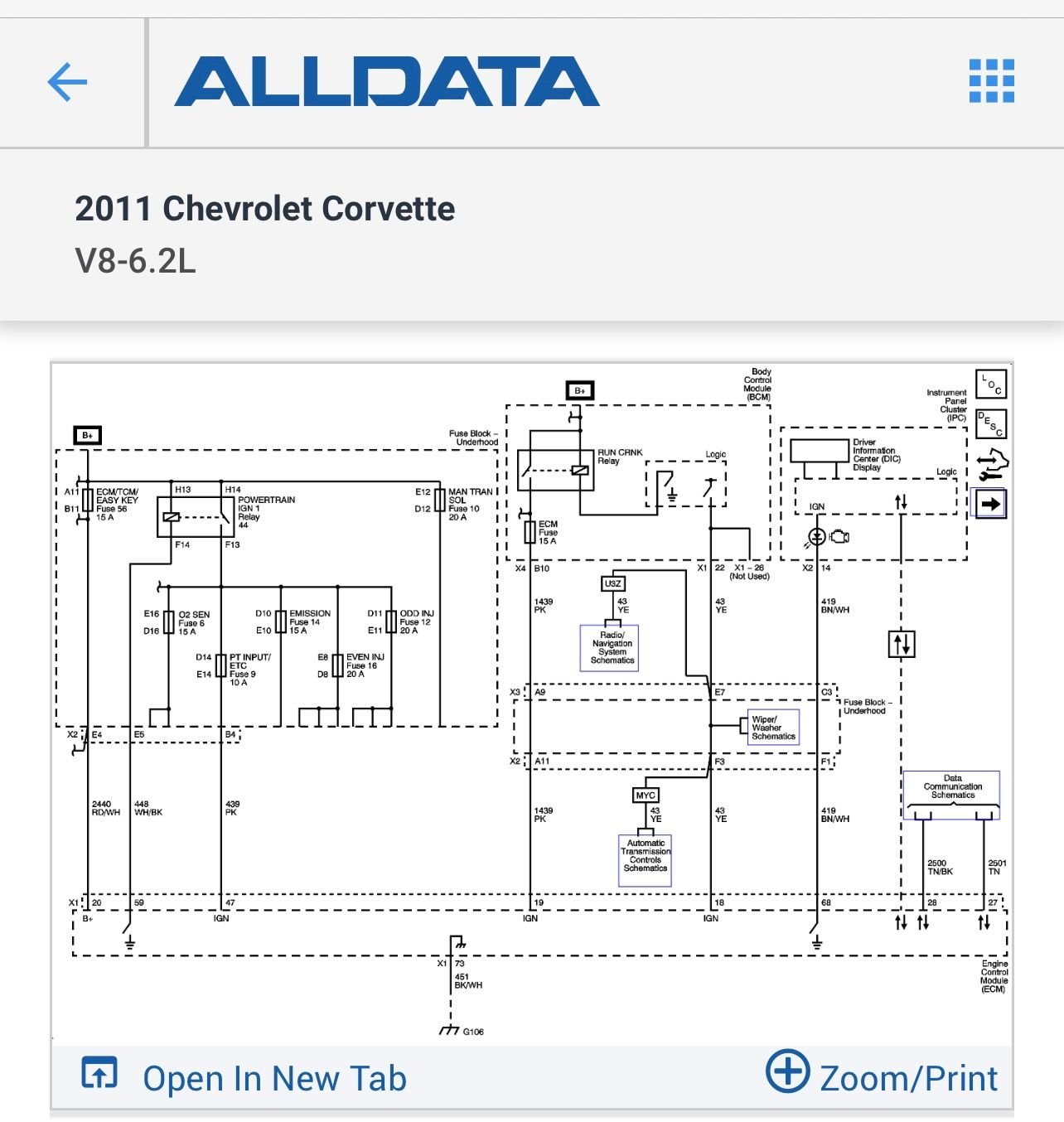

I’d let those 2 mechanics stick to oil and brake changes…they don’t know how to diagnose cars…99.99% of them read a trouble code and will replace a part and that is not how we do it…the upstream O2 sensors are supposed to switch between 200-800 mv’s and the downstream O2’s remain fairly constant at 600-800mv’s…was it stuck below 100mv’s for a period of time ?? …was there a DTC stored ??…you may have a dirty throttle body…this would not affect your voltage…I’d use your code reader as a chock and invest in a better aftermarket factory level scan tool…can that code reader graph data PIDS ??…just looking at the numbers isn’t the best way to look at live data…if you want to bring the car to a sharp diagnostician I know someone in your area…you can try voltage dropping the injector circuit from the battery to the injectors and see if you see a drop…if you don’t have a DMM and know how to use it then forget about this test…a lot of circuits like O2 sensors, coil packs and injectors go through the Powertrain Ignition 1 Relay…that may be something to look at.

You think replacing the relay or you mean looking into the harness?
