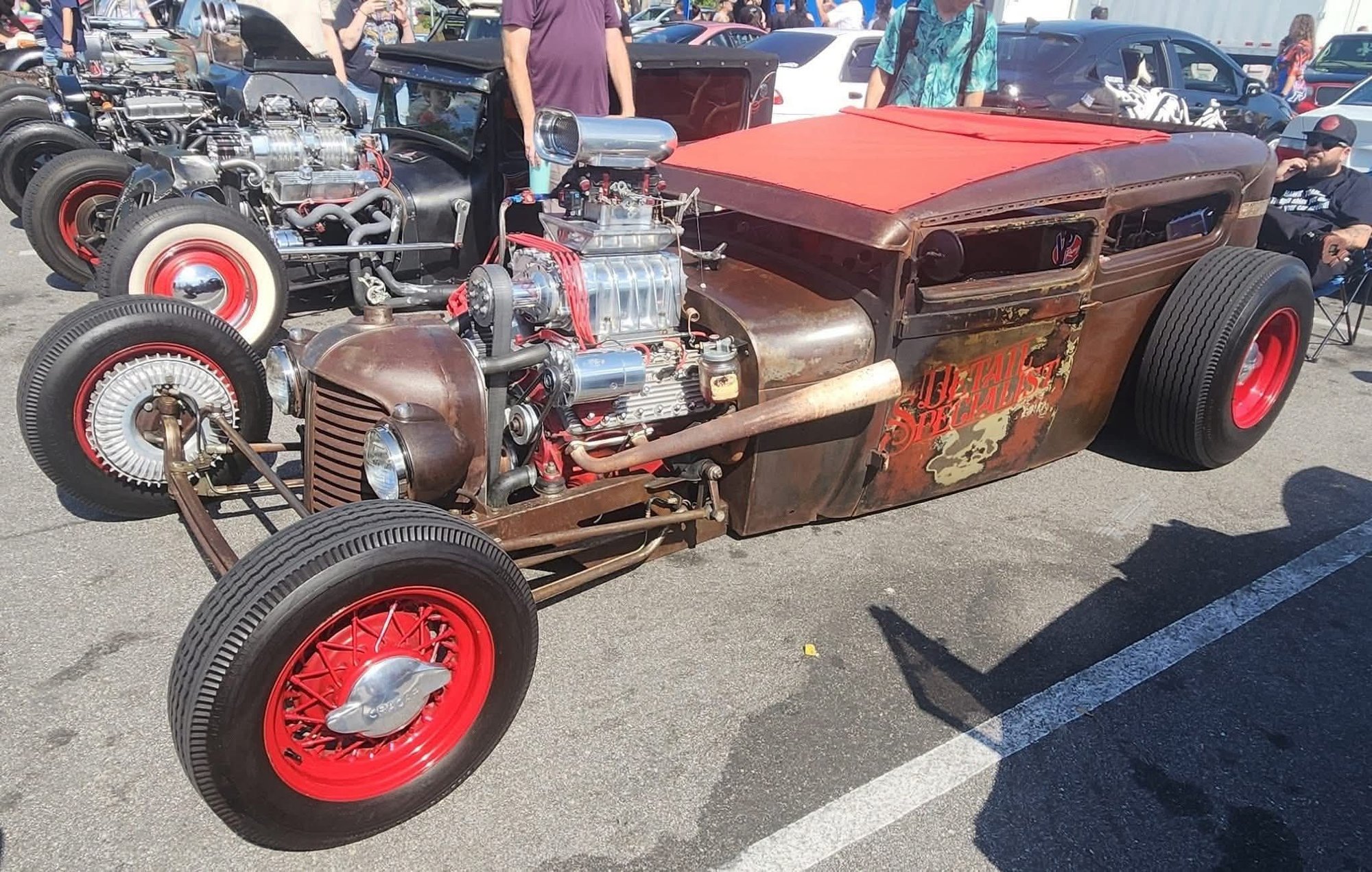

Roots are also best to just look REALLY cool! Lol
A buddies rat rod.
A buddy's rat rod.
