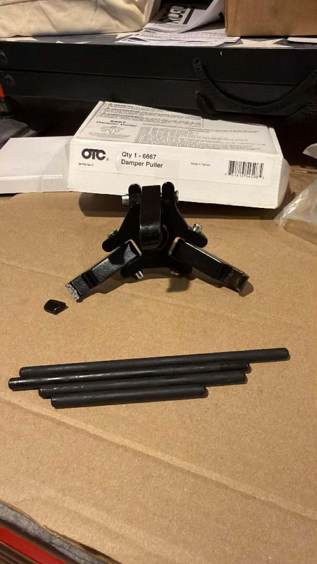

Got most of my engine torn down and tried removing the balancer today only to have my OTC 6667 balancer puller break. I tried use a normal 3 jaw puller and it got no where. The puller was under a lot of strain, to the point where I stopped since I have 2 new pullers coming, in 2 different styles. I even tried some heat and a small impact. No luck. Advice? 2010 base model 6MT 27k miles, OEM balancer.

They're tight as hell but a 667 should pull it. Where did the 667 break? The center rod bend/break or jaws?

Maybe a poorly made version 667? Looks like the arms are cast looking at the break crossection... You bumping it with an impact shouldn't break the arms IMO. I'd try again with another version. Definitely make sure the jaws are making good contact/squared up with the damper contact points and crank on it. Should start moving off
That broke with hand tools.

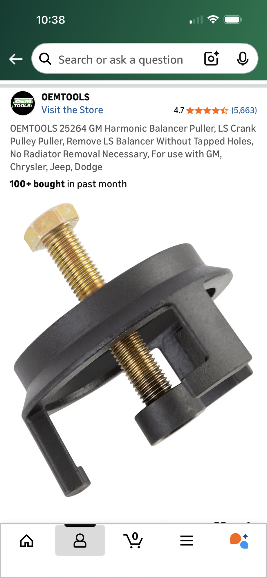

Here is the removal tool that I used. Worked very well and very easily removed the balancer. It's shorter than many other types so well-suited for the narrow space in a Corvette.
https://www.amazon.com/dp/B0DC6G95N2
I have this one arriving tomorrow.

Nice. That looks identical and should work very well. Make sure you also have the install tool.
