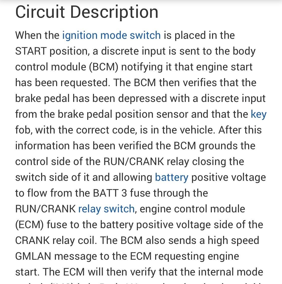

Hi,
I am looking for information about the ignition signal on a 2008 C6 LS3 instrument cluster.
I have a couple I want to test on the bench before I fit them.
I have a wiring diagram, I can see ground & bat+, no mention of an ignition signal.
Is ignition communicated via CAN and that's why its not marked in the diagram.
Any information would be greatly appreciated.
Thanks

Here is info on the ignition mode switch if that is what you are looking for…if you need more info just ask.
