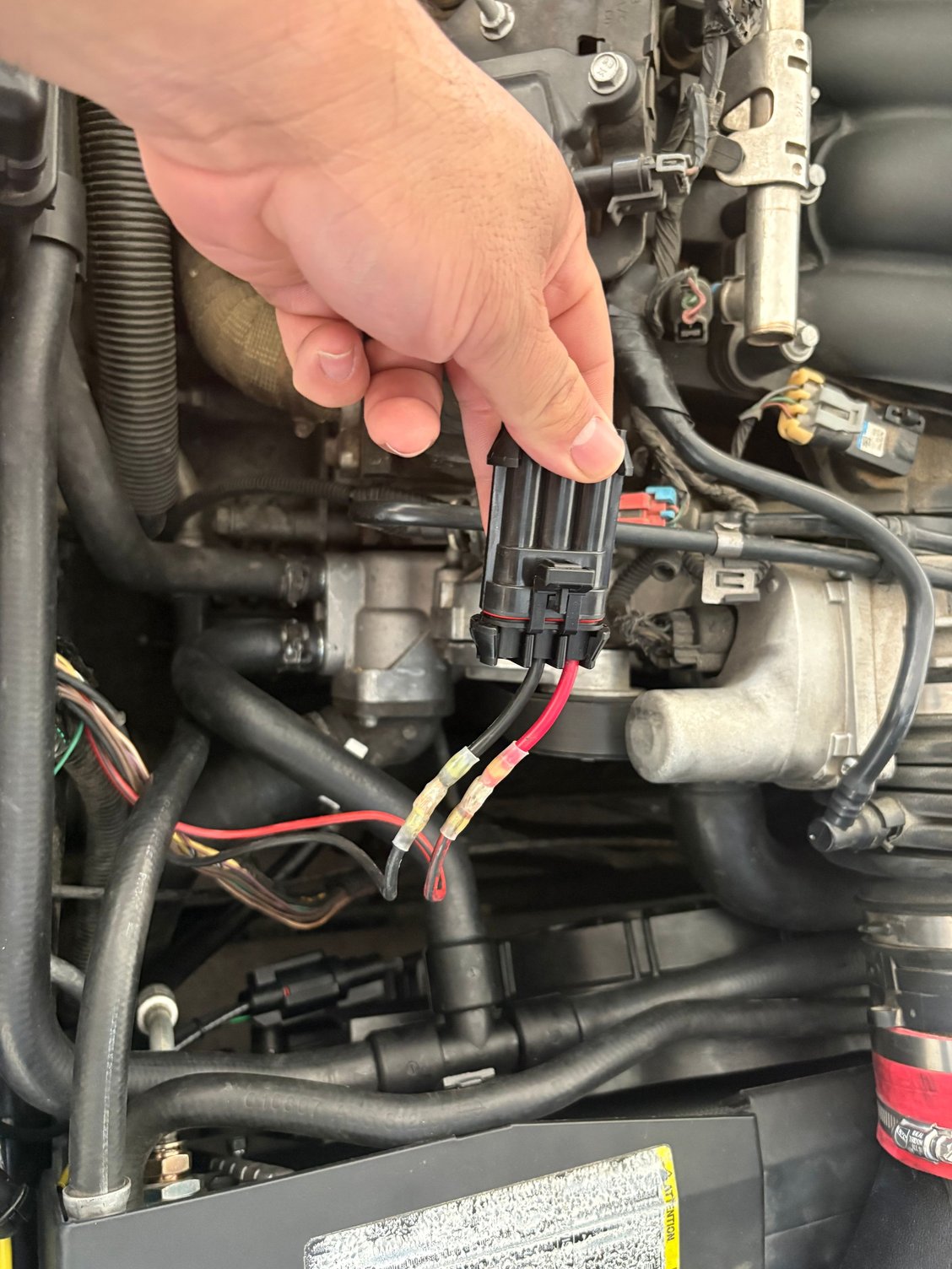

here is what it looks like, also I just disconnected the coolant temp sensor and fan did not kick on, and they do spin freely

You are getting a lot of bad advice about this fans operation. This is a Spal brushless fan (same style as the C7 and up Corvettes). The controller is built into it. Its' operation is similar to the OEM C6 fan except than the fan controller being built in verses the C6 fan which had a separate controller. If you put 12volts to the large red wire and ground to the large black wire......nothing will happen. This type of fan needs the PWM wire (white small gauge wire) hooked up to the C6 Corvette ECM PWM wire to function.
The other small wire from the fan(yellow wire) is not connected. This fan/shroud is sold by Dewitts 32-SP480. It requires a 50amp fuse on the red power wire.

the green wire is connected from the engine harness to the fan via connector, I’m going to order a Casper switch and see if i can force it on

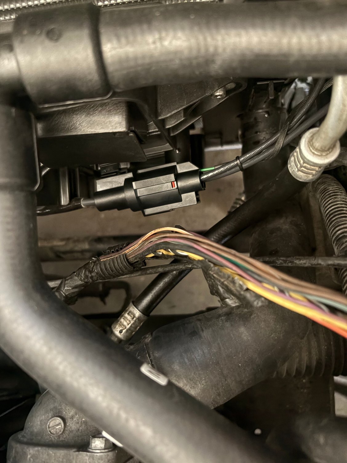

Here’s a picture of the plug that goes to the radiator fan

I presume your C7 fan is plugged into the hot lug by the fuse box there and is grounded to the frame somewhere. There should be an in-line fuse or something there to protect it. Can you see if that is in good shape and not blow or tripped?
Old Jan 31, 2026 | 04:28 PM
Paulmg1986's Avatar
Paulmg1986
Joined: Jan 2026
Posts: 22
The fuse block looks ok
