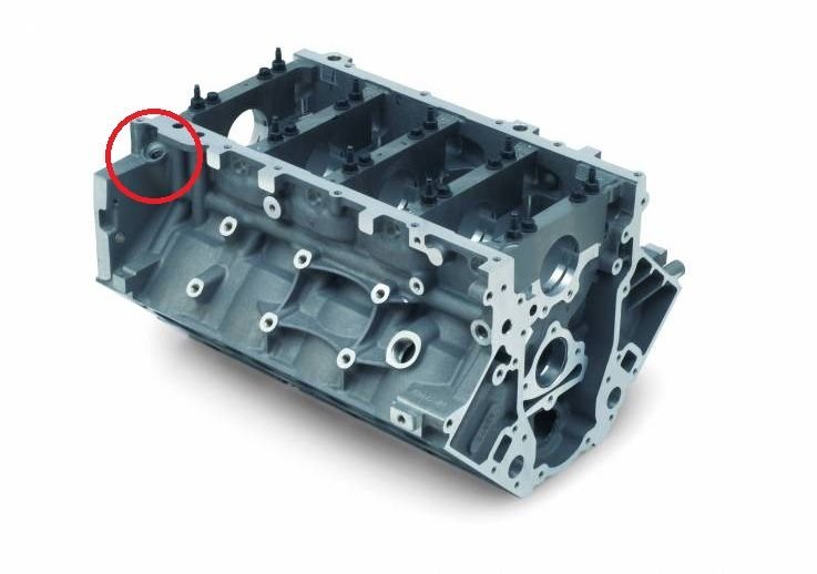

I found this picture of an LS3 block and circled in red the galley plug that I think is the correct one to view the presence of the barbell. I hope that helps.
Yes it does, thank you

I have a possible explanation for your problem. The barbell may be missing. The purpose of the barbell is to direct oil flow through the oil filter. If the barbell is missing, oil will not go through the filter, but merely circulates throughout the engine without ever being filtered. That would explain why you have particles in the oil, but no particles in the oil filter. Unfortunately, you have to remove the rear engine cover to see if the barbell is there or not, and that is a big job any way you look at it. I wish I had better news.
I did a little looking around to see if there was an easy way to detect whether or not the barbell is present in your engine. I found this on the LS1 fourm:
You can pull the oil plug in the back of the block that goes in at a 45 degree angle up on the drivers side and see the shaft of the barbell if it is in place.
You should find that plug just above the oil filter. It should be a simple matter to remove that plug and have a look. A small inspection mirror may be required. Good luck!

is this access point "window" on all LS engines (LS7)?
See post #27 for the location of the plug for viewing the barbell on all LS7 engines, and I believe the same goes for all other LS engines.
thats the front drivers side correct? i think this is where my oil fed blower hooked in on my last vette?
