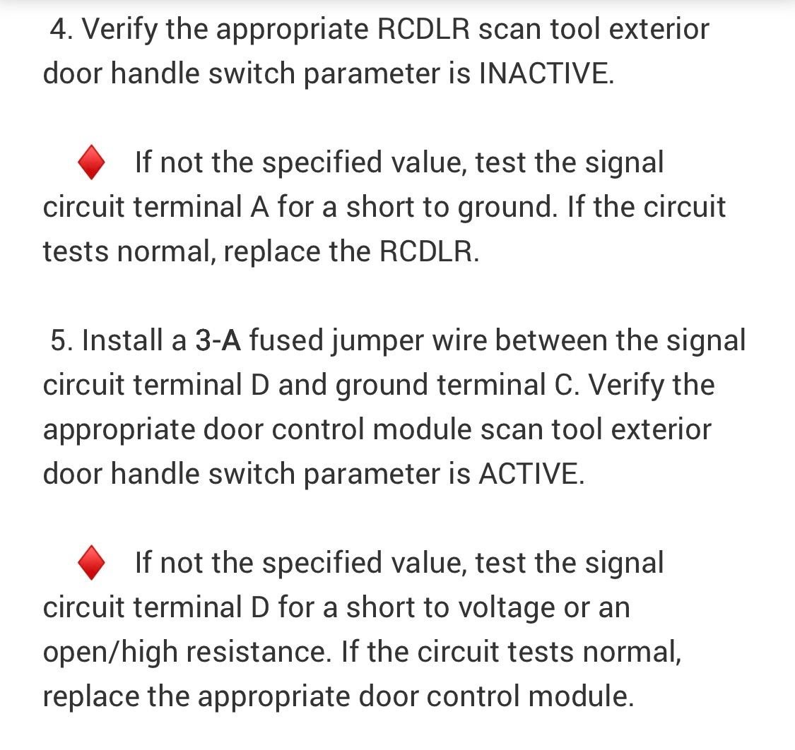

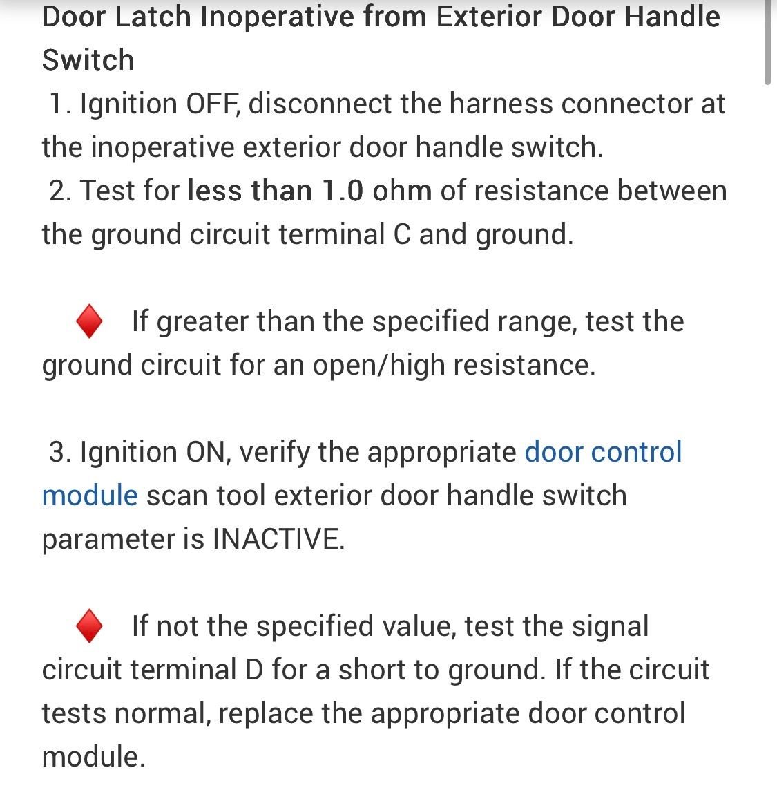

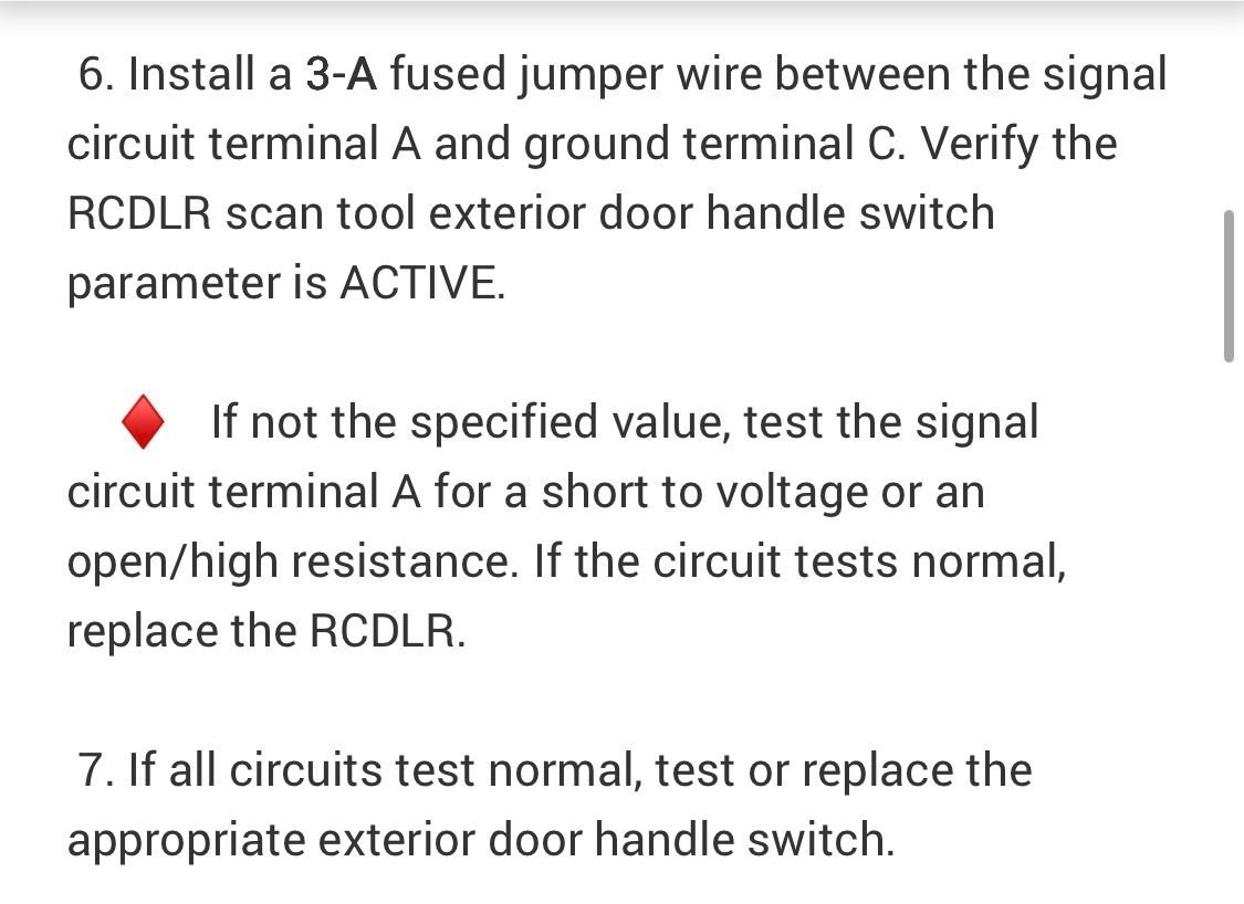

Well have you done any electrical troubleshooting ??...seems like you changed a bunch of parts only...which parts ??...helps to have a factory level scan tool to check the door inputs...if you can't follow the factory flow chart below seek out an auto electric shop in your area...unfortunately there is no silver bullet repair !!!
