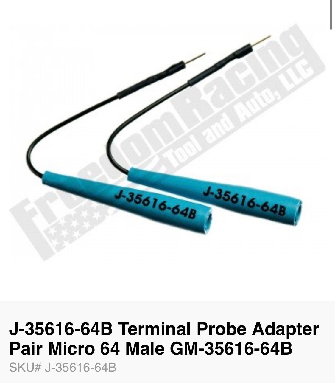

Sounds more like a "connection" issue possibly...if you know how to do a "terminal tension" or pin drag test as it's commonly called I'd do that first...you may also try to do a "wiggle check" of that connector and see if you can reproduce the issue..the BCM terminals are "micro 64" and VERY small so you don't want to be shoving anything larger in the terminal than that or you'll have more problems...you can buy the correct size terminal tester J35616-64B...sounds like you have a parasitic drain going on... battery goes dead in 2 days ??...that is a pretty decent drain...you should diagnose that FIRST !!...if this electrical testing is over your head seek out an auto electric shop in your area.
