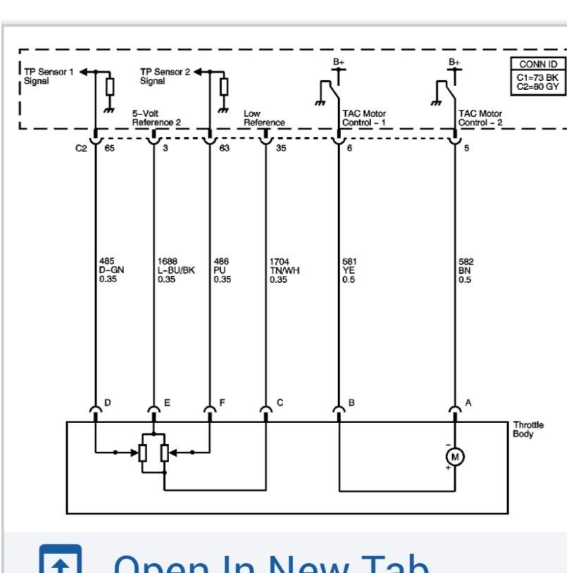

Below is the flow chart for the P0121...unfortunately we can't diagnose this for you over the Internet...a smoke machine is the preferred tooling for an EVAP leak...the MAP sensor ignition ON if at sea level should be 101 kPa, 29.9 inches Mercury or 14.7 psi...MAF at idle NO LOAD and at operating temp should be no less than 6.2 grams/second....and YES you have a TPS sensor...a simple 3 wire potentiometer....what are your fuel trims at idle ??...a Blue Driver not the best scan tool for a diagnosis...I keep one in my glovebox for my 08 in case I need to read Powertrain DTC's.

Old May 3, 2026 | 06:20 PM
C5 Diag's Avatar
C5 Diag
Moderator, Tech Contributor
Posts: 15,595
Likes: 4,055
From: Cape Coral, Florida

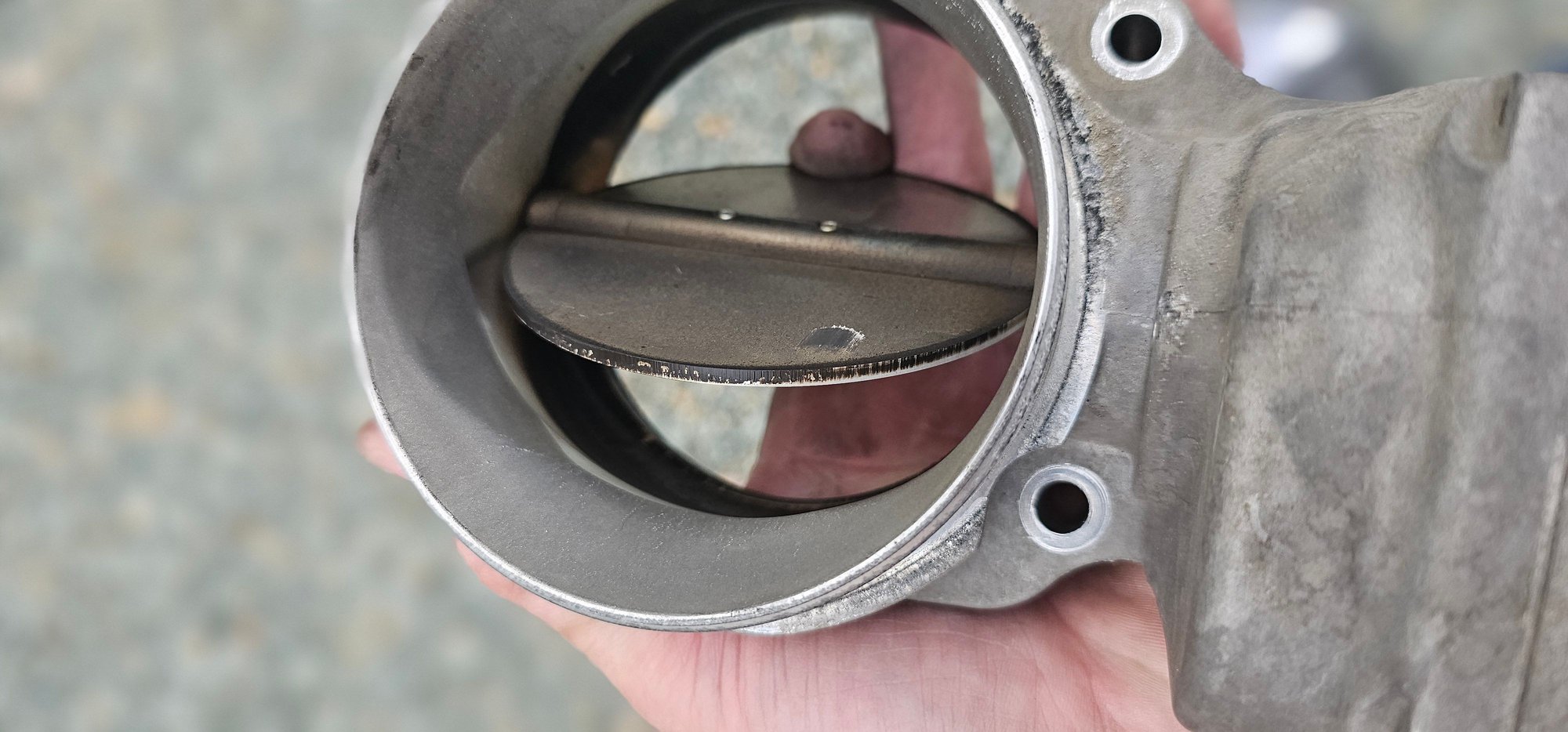

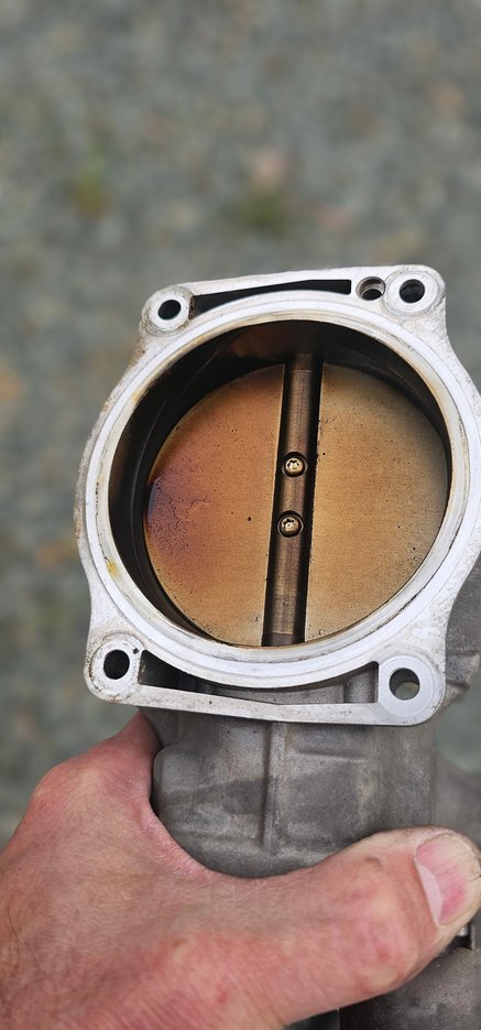

I appreciate the diagnostic instruction!
I purchase throttle body spray cleaner and removed the throttle body. During the examination it was obviously dirty so I cleaned it sparkly clean. I also cleaned the MAF with MAF cleaner too. Reinstalled everything and left it disconnected from the batter over 12 hours.
The hesitation issue is completely gone! I thought I had a vacuum leak somewhere but a dirty throttle body was my issue.
As for the evap error I will wait to see it the check engine light comes back before I attach my smoke machine to find the leak.
Thanks again for your support and help.
crusties on the edge
just plain dirty
just plain dirty

You didn't have to remove the TB to clean it...a scan tool has a data PID which can tell you if it may be dirty...I clean mine every other year as preventive maintenance along with the MAF...just the area where the throttle blade rides on the bore needs to be cleaned.

ah.. understood. BUT it is very clean now.
