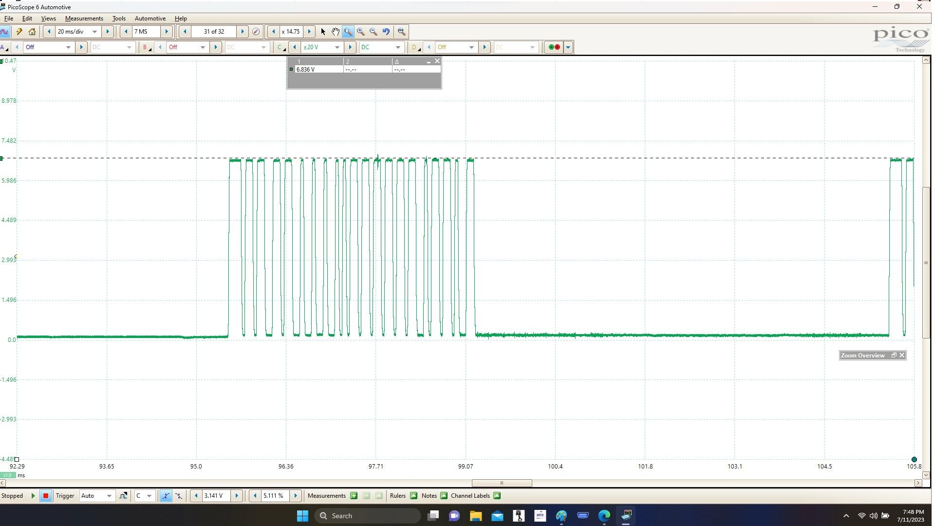

I have a Verus Pro D10 and that has a scope so I'm sure your Triton has one but if you've never used it that is a different story...unless you can de pin each module wire one at a time or use that tool shown in the video it might not be so easy...many YouTube videos on Snap On lab scopes if you don't know how to use it...all your issues most likely related to the low speed bus.

Well if it shows basically 0 volts or flatline that would be a short to ground...plug in both combs and turn on the ignition (green start light on) and put the one lead on pin 2 at the DLC and the ground lead on the door hinge bolt...you should see what my low speed bus looks like...0-7 volt square wave...I'm on a 20 ms time base and I'm showing one "data packet"...the scanner and scope are 2 separate tools...I can't remember if you have ignition function and what modules can you or can't communicate with...if you can look at the modules on the low speed bus and if you can look at live data that means you are communicating !!
