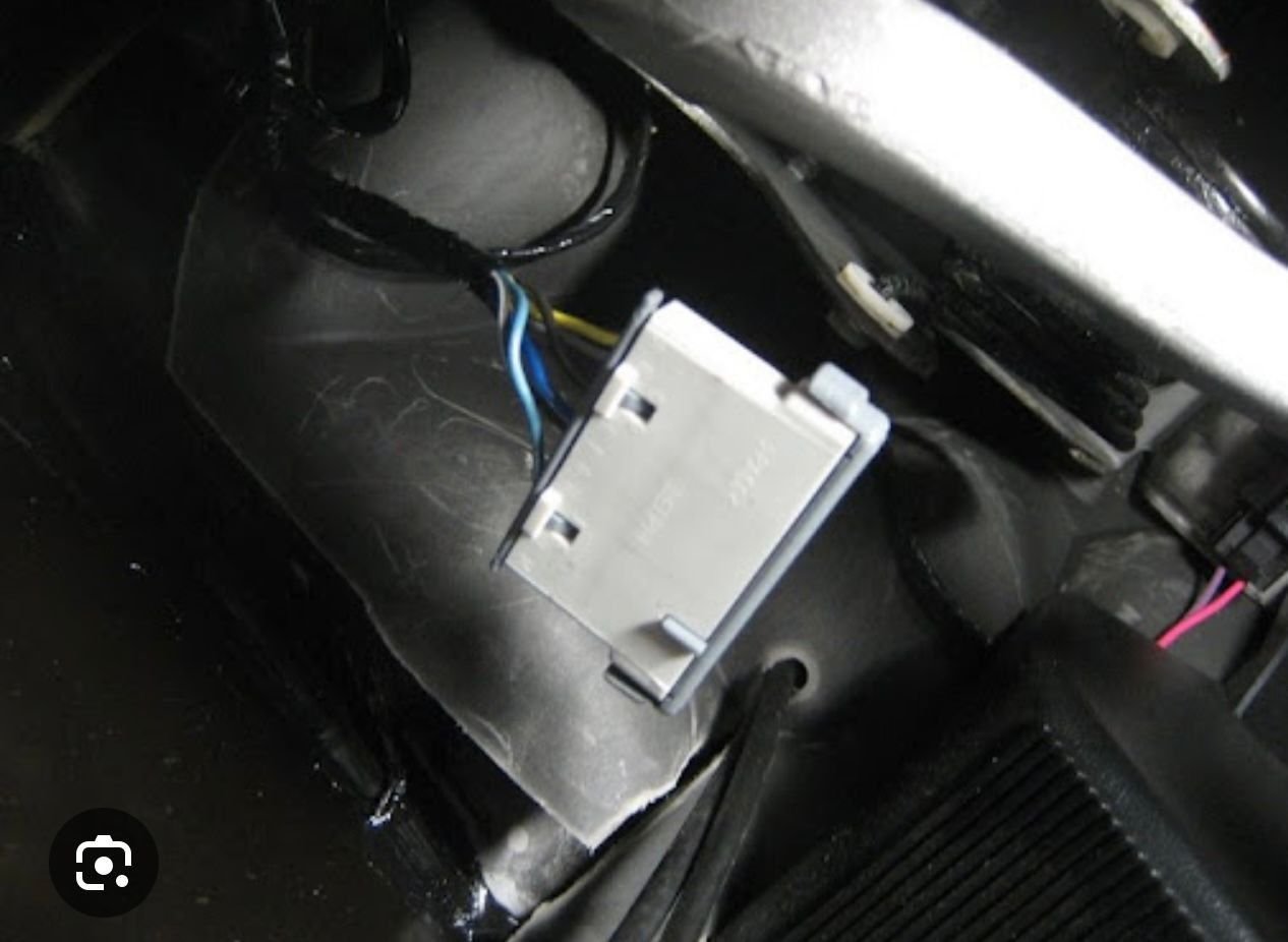

Try putting your fob in the slot next to the glove box next time you have this problem.

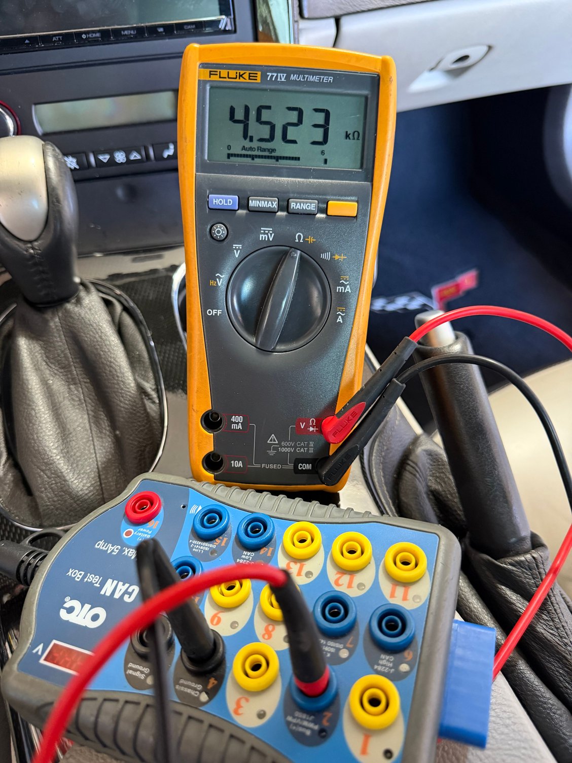

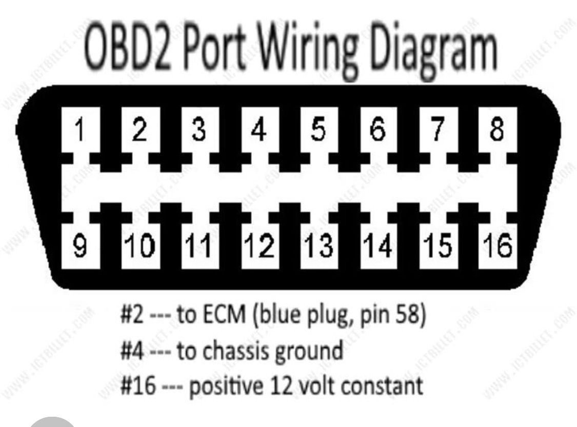

Well let's just start with terminal 2 at the DLC (OBD2 port)...with the battery disconnected checking between terminal 2 and terminal 4 which is chassis ground you should see around 4.5 kOhms...4,523 ohms which I see on my 2008....if you had ignition function you can check voltage which will be fluctuating with ignition ON between 0.2 to 0.7 volts...with a labscope you should see a 0-7 volt square wave....humor me and check fuse 11 in the under hood box...ECM/TCM/EASY KEY...and don't check the fuse VISUALLY...check with a 12 volt test light !!...is this part of the issue you posted a few days ago ??...TRY TO KEEP EVERYTHING IN ONE THREAD !!

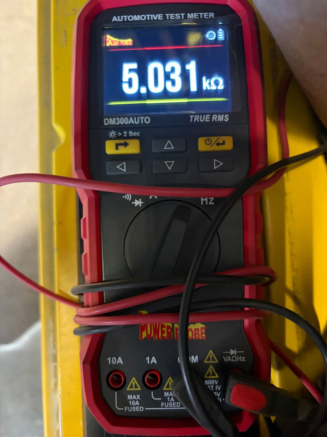

this was with battery disconnected and pins 2 and 4 at the DLC.
battery on and in ignition mode it fluctuated from 0.1 to as high as 2.8 volts. Most of the time it was .2-1.0 volts

Resistance from pin 2 to 4 (ground) is good...with ignition ON and red lead of DMM to pin 2 and black lead of DMM to pin 4 or a clean ground you should see 0.1 to maybe 0.7 volts and fluctuating...as I said with DMM you will not se it going to 7 volts since DMM refresh rate is to slow...you will see a 0-7 volt square wave with scope...if you are seeing 2.8 volts on pin 2 it may be shorted to power !!

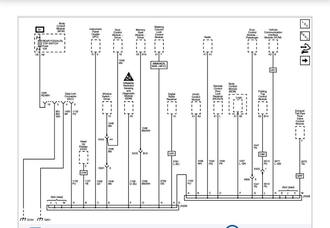

okay, would I jumper both splice packs d to f? Or just one. It looks like both splice packs have a d and a f?
In the video he did the driver steering column one and inserted a pin one at a time to see which one brought the communication down, then traced it to the module and put the pick on the wire that ran to the splice pack, and unplugged the module to see if it brought it down.

D to F on SP208...they connect the BCM and RCDLR together...208 is on the passenger side...BCM and RCDLR need to communicate with each other for ignition function...the ECM needs to be added in for the car to start...you will get a bunch of U codes on all the other modules that are now off line.

It's best if you let us know what those letters or wire colors are...do you know how to read the wiring diagram I posted in post #3 ???...checking the voltage on only one module may not result in good voltage readings or if the module is not always communicating on the low speed bus.

I believe C and G didn’t work on 208. (I know they were The pin above and below the 2 that were jumped)
F was the ONLY one that worked on 205. ( I know it was the 2nd pun tested after the 3 not used)
