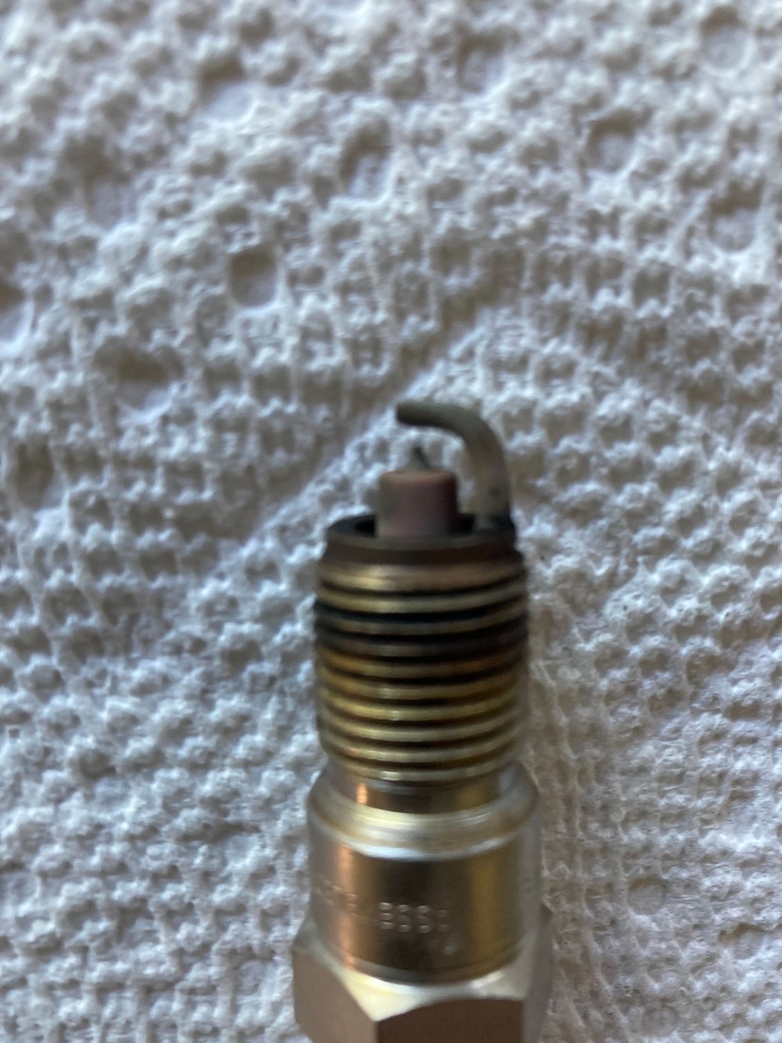

Owned this car for two years with no issues. About 18500 original miles. A couple of days ago engine started to misfire under load and at idle after warm-up. No codes or messages on the DIC. I'm suspecting plugs, plug wires or coil packs. Plugs are Part number 12571164 AC Delco and may be original to the car. They look like they could use a clean-up but otherwise look ok. No cracks I can detect in the porcelain. Plug wires look good.
Owner's Manual says to replace at 100K miles and I'm way under that. Should I go ahead and replace plugs anyway or is there something else to check first?

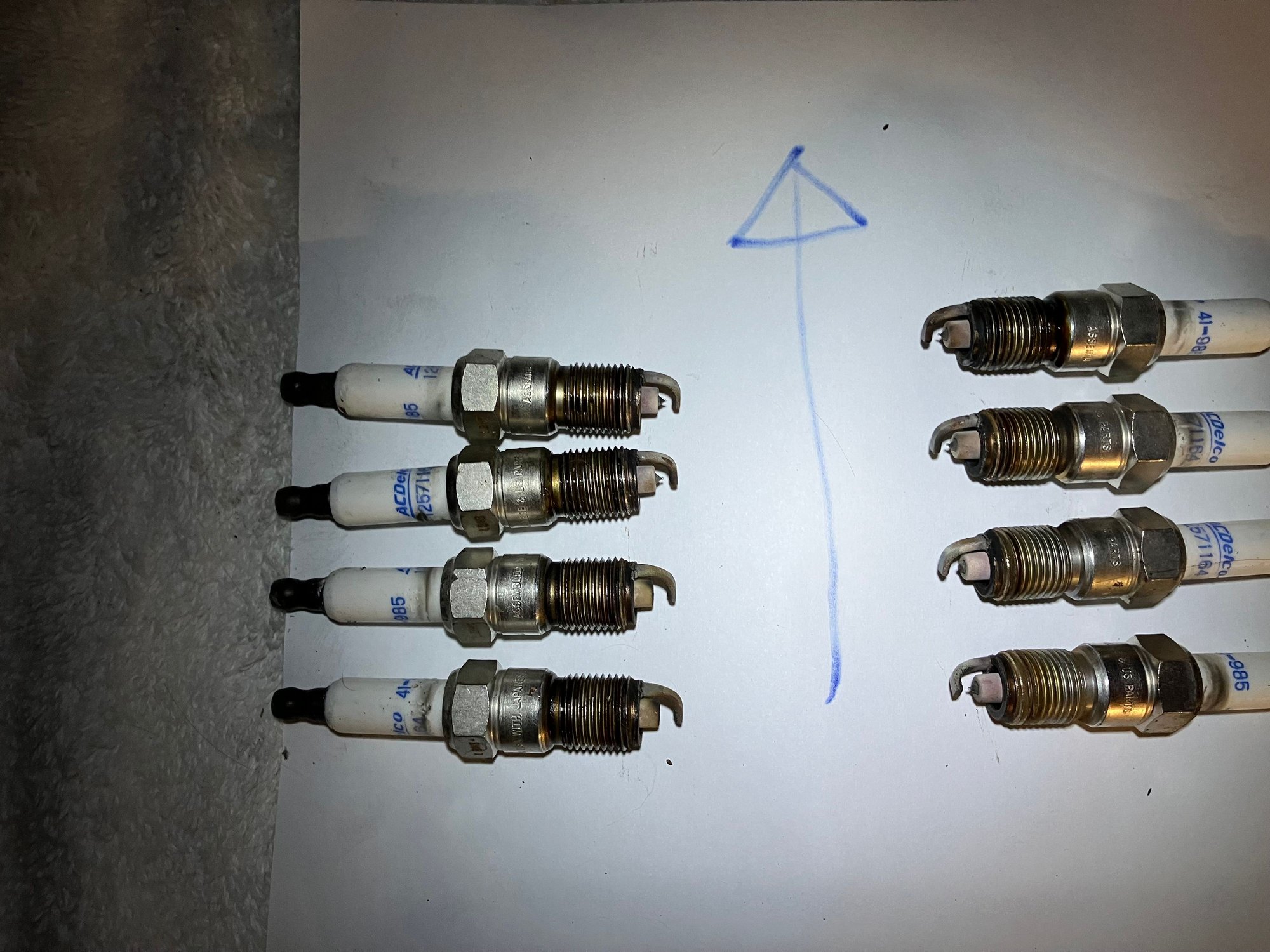

R & R the plugs and wires. Even with only 18,500 miles, it's the 19 years in service thing you've got. Besides, if you still have the mis-fire, you can keep searching as the plugs/wires should be ruled out.
Here's what plugs (OEM) look like after 94,XXX miles (and 20 years.) And I had no mis-fire, and it passed smog!
A couple of those have some serious wear!
the bottom left 2
