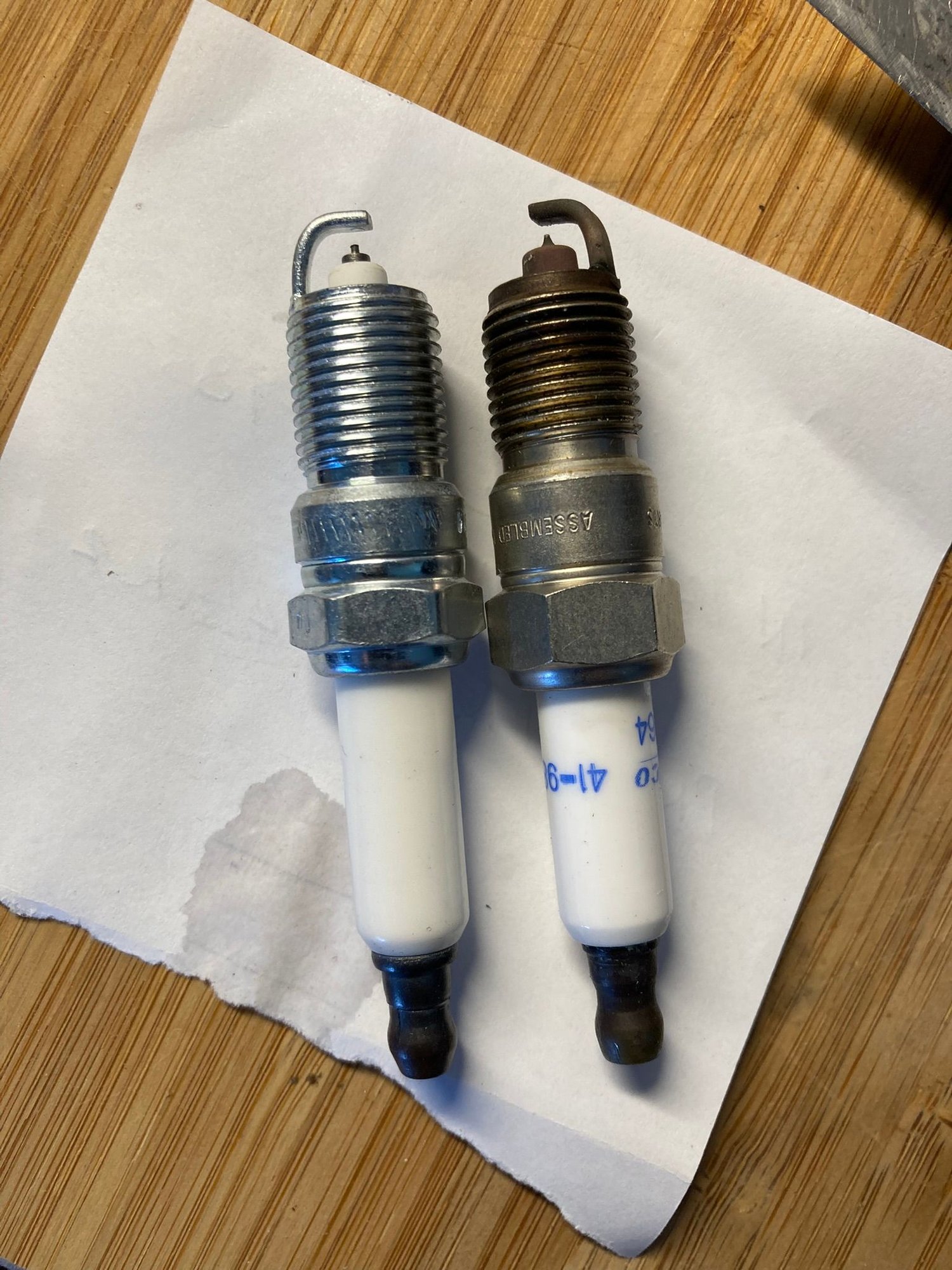

Got the new 41-162 plugs today. Here’s a side by side pic of them with the original 41-985 plugs. No country of origin or assembly stamped on the new plug.The differences between the two are obvious.
