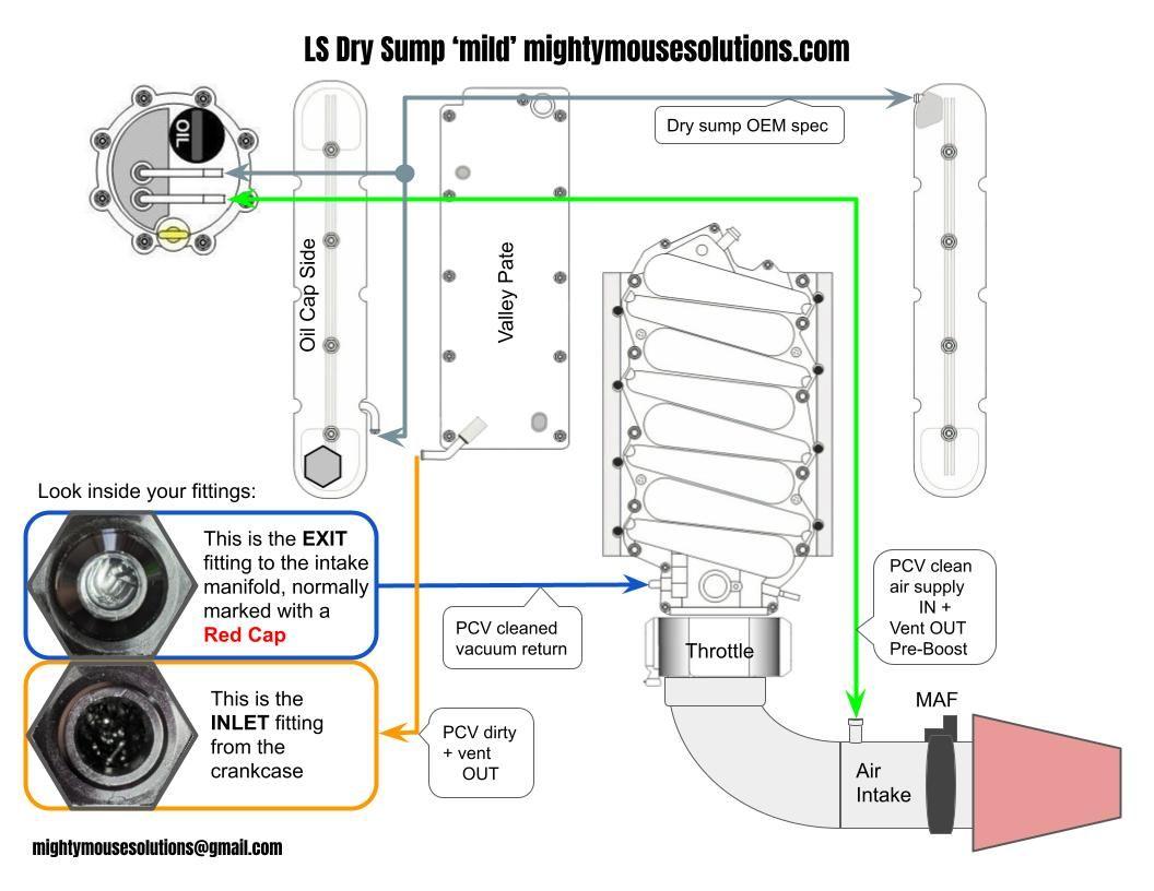

Have you contacted us to make sure the hose routing is correct?
If you had a pcv system on the car, and went away from it (race system) then you may need to add idle air that formerly was supplied by pcv.
If you had a delete on the car (pcv tuned out), and have changed back to pcv, then you may need to remove idle air now being supplied by pcv

as long as the inlet and outlet are pointed correctly
and the breather check valve is in the breather
and the drain is closed, connectors are tight
you should be good
