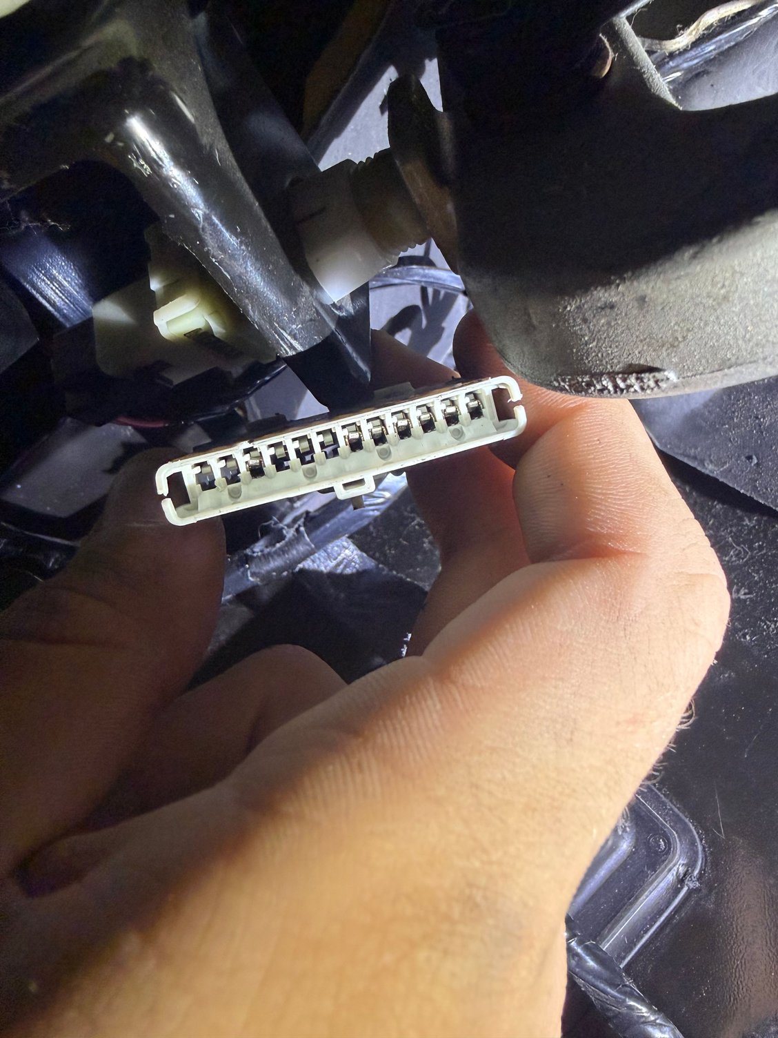

Hello,
is there a reputable source that sells the terminals for the splice pack SP205 and SP208 for a 07 Z06?
I don’t need the connector, just the terminal with some wire.

Do these have a part # on them or a picture (I haven't been that far into the wiring on this car) and what style of terminal does it use?
Delphi pa66 is the only characters I see besides the alphabetical a (a-l) for the terminals.
If it only comes with a connector as a whole package that’s fine too.
hopefully I don’t have to buy the whole wiring harness because you’d have to take the whole interior apart

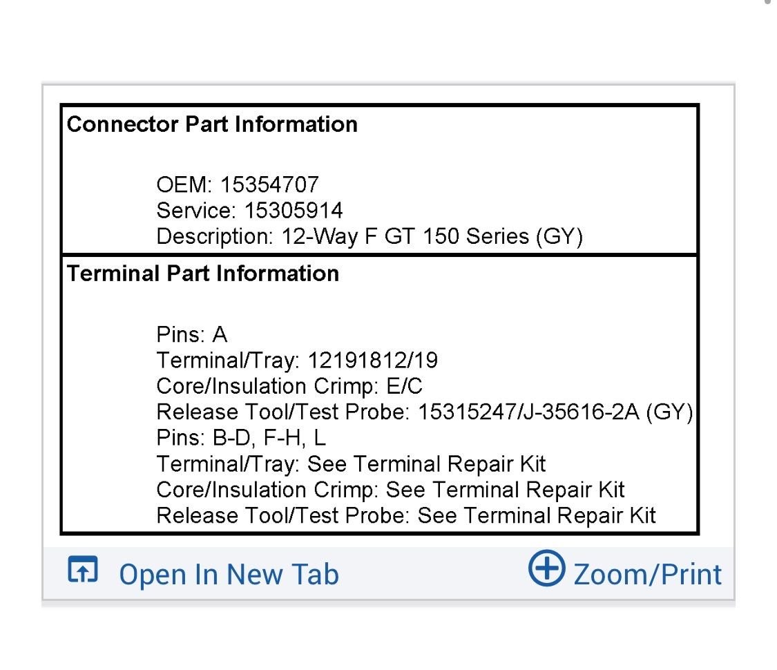

You can pick up these terminals at a dealership if you want...Mouser Electronics is a website I sometimes use for connectors...you also need a tool to remove the terminal from the connector.

That 12191812 part# should be the terminals you need, shows a Delphi GT 150 series. I'm sure you could find a pack off that.
