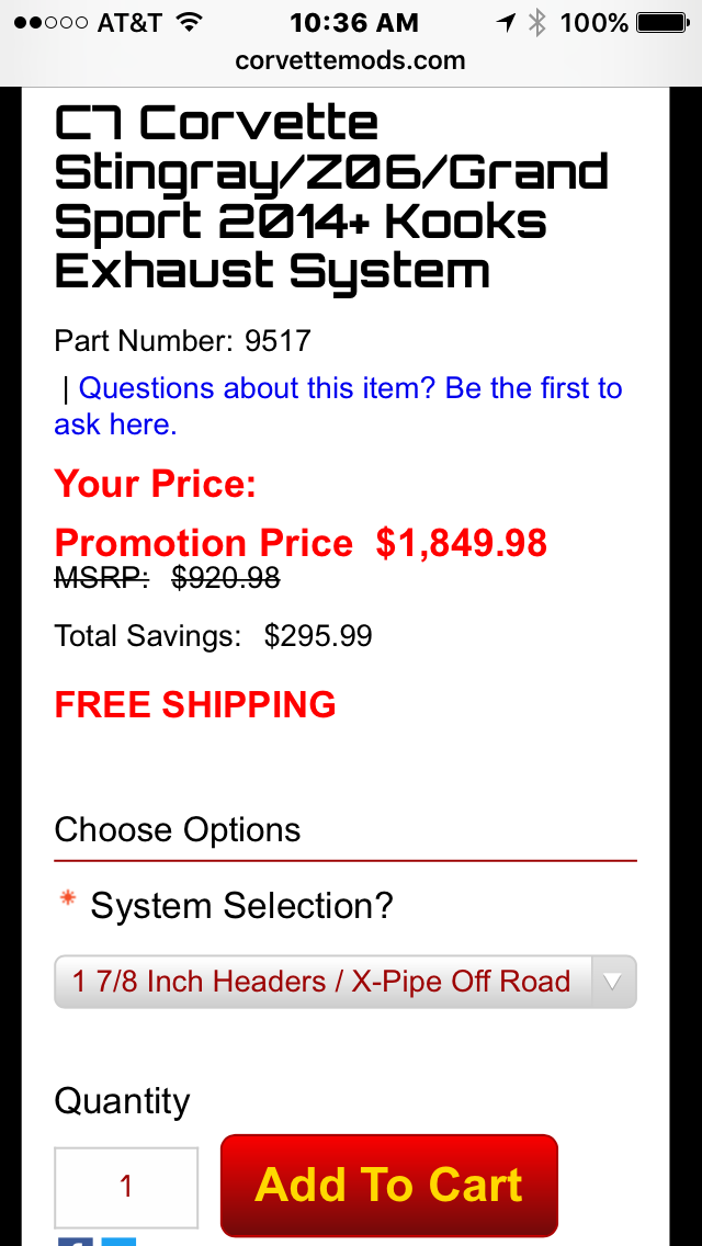

If you type in the google search c7 corvette headers.
click on the link you will see.
https://www.google.com/search?q=c7+corvette+headers&prmd=svin&s ource=lnms&tbm=shop&sa=X&ved=0ahUKEwixqY 7H9anWAhWl5oMKHWJSBggQ_AUIESgB&biw=412&b ih=766
Kooks for 650 even
https://www.google.com/search?q=c7+c...iw=412&bih=766
Kooks for 650 even
That is just for the X pipe. When you change the "selection" pulldown you see the real price. Selecting the headers and Xpipe adds another $1300.. see below. As I said, you aren't going to find a "real" set that cheap. Most are over $1,000+
