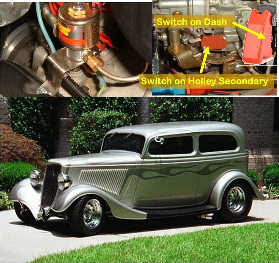

Would appear to me that a controler is essential for any kind of NOS power addition. Would think you need more than a Tune to retard timing enough when it's activated.
Since my 17 year old ProStreet Rod mostly goes to Shows now and I have to compete in ProStreet category as it's tubbed, I am competing with folks having 8-71's etc!
Added this NOS system and all the right hardware BUT can't retard the timing nearly enough without a controller! Never added! So unlike my usual feelings of not adding for "looks." It's there for Looks. Have not missed at least a class trophy!

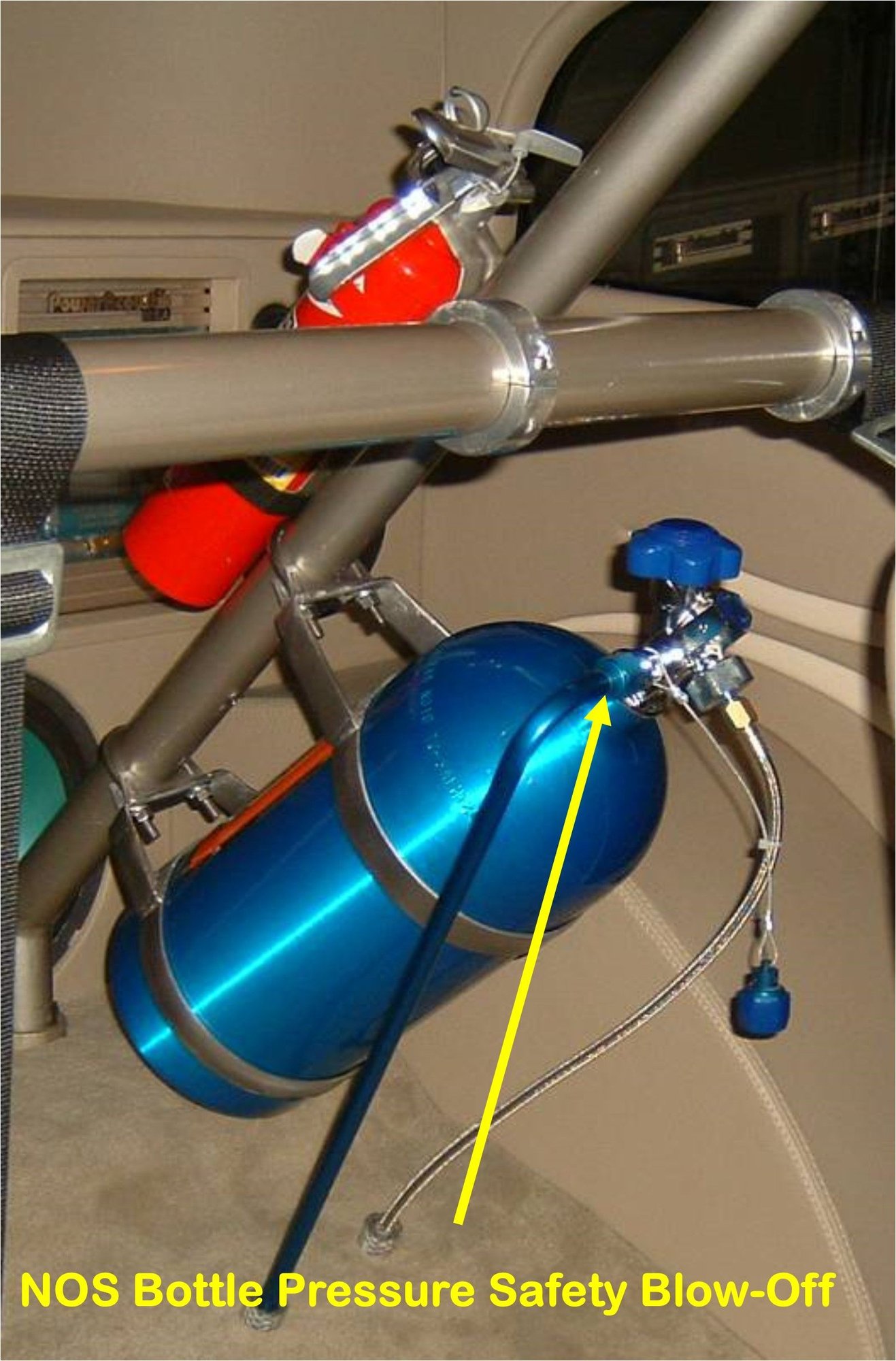

Would also think you need to connect a blowoff tube in case on a hot day the bursting disk lets loose! Would not want to be driving with a passenger compartment filled to Nitrous!. Do you have one?
Added a blowoff tube "Just in Case!" Gets hot in the sun!
Have the 502 cid Chevy all set for nitrous BUT never added a needed controller!
