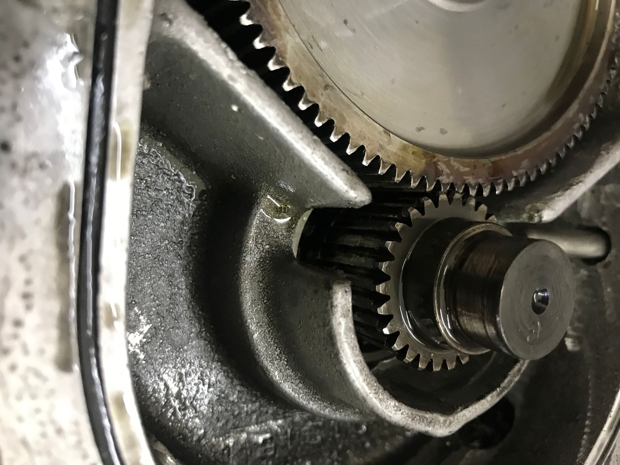

Be carful dont over tighten it, it will break your bearings and then your blower will be f***ed up, that exactly what happened to me, had less than 4-5k miles on my ysi and it shattered everything. Try and get a griptek pulley, try to coat your lower ring with Carbinite coating, good luck

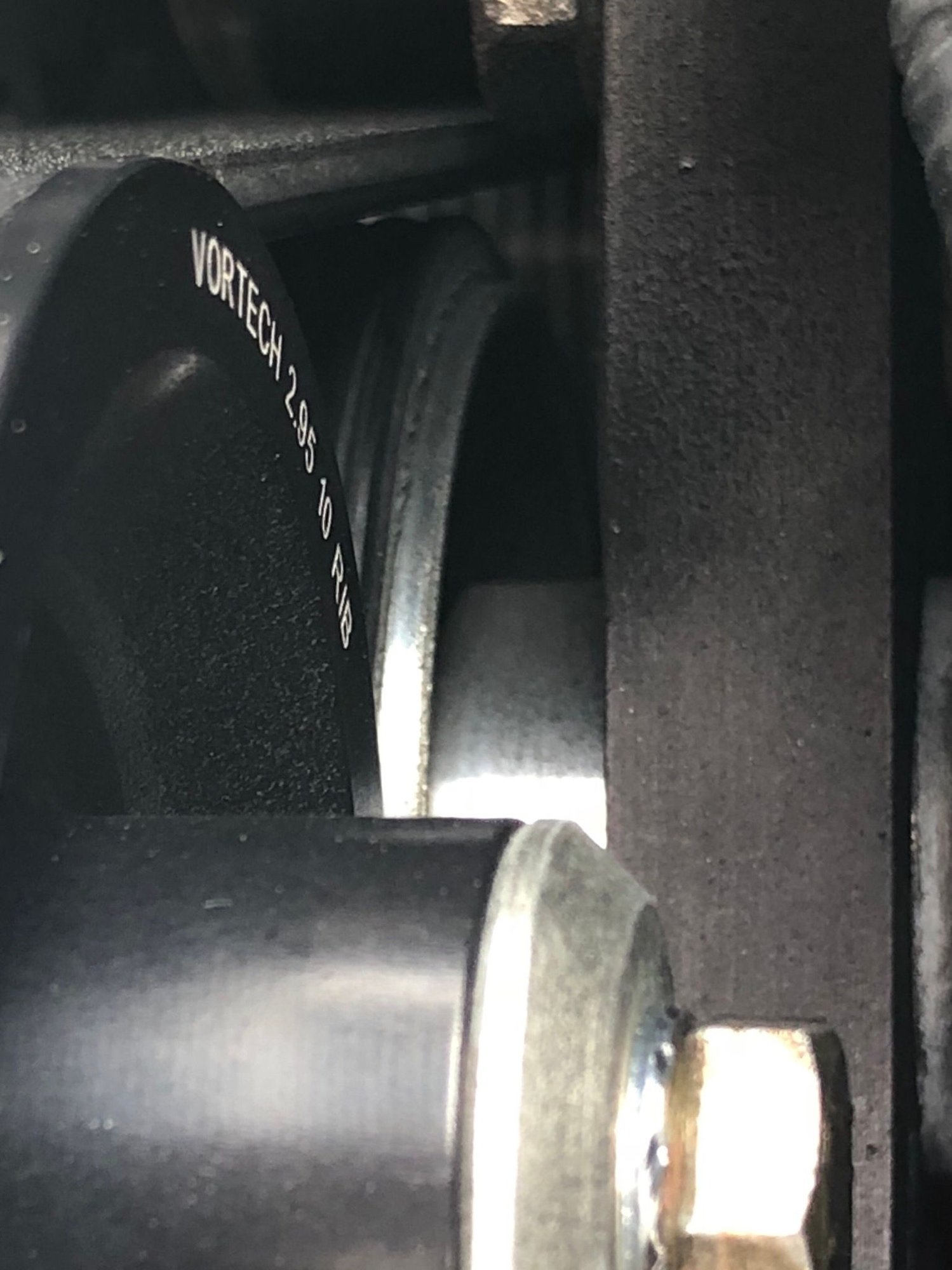

This belt Doug.
And this is how tight I have it!
Old Mar 22, 2018 | 12:34 PM
black_c7's Avatar
black_c7
Joined: Nov 2015
Posts: 1,160
Likes: 40
From: Kuwait
Originally Posted by C7&7
This belt Doug.
I think it too long for yor pulley combo, try k100465hd
Old Mar 22, 2018 | 01:00 PM
C7&7's Avatar
C7&7
Joined: Mar 2010
Posts: 7,052
Likes: 945
From: DFW TX
Hmmm... That's a thought. I was just assuming the belt that came with the blower would be the right one. However maybe because I am running the 2.95 upper I should go a little smaller? What do you think Doug? Suggest the smaller belt that black_c7 suggests?
Old Mar 22, 2018 | 01:38 PM
black_c7's Avatar
black_c7
Joined: Nov 2015
Posts: 1,160
Likes: 40
From: Kuwait
[QUOTE=C7&7;1596836575]Hmmm... That's a thought. I was just assuming the belt that came with the blower would be the right one. However maybe because I am running the 2.95 upper I should go a little smaller? What do you think Doug? Suggest the smaller belt that black_c7 suggests?[/QUOTE
See the belt on the manual idler is really close to the belt on the other side, that means the manual idler is tightened all the way, which means the belt is long, i ran that belt on my 8.35 2.7 pulley combo not sure if its will work with yours
Good luck

10 rib belts are limited in the sizes you can get, we like the new RPM belts from Gates but they are not available yet in your size. I'm most concerned with seeing how your tensioner looks, the % that it is off it's stop, than the adjustable idler. That's just there to take up or loosen the belt for different pulley combos with keeping the same belt.

The next size down in Gates is a 25-100465 if needed.
