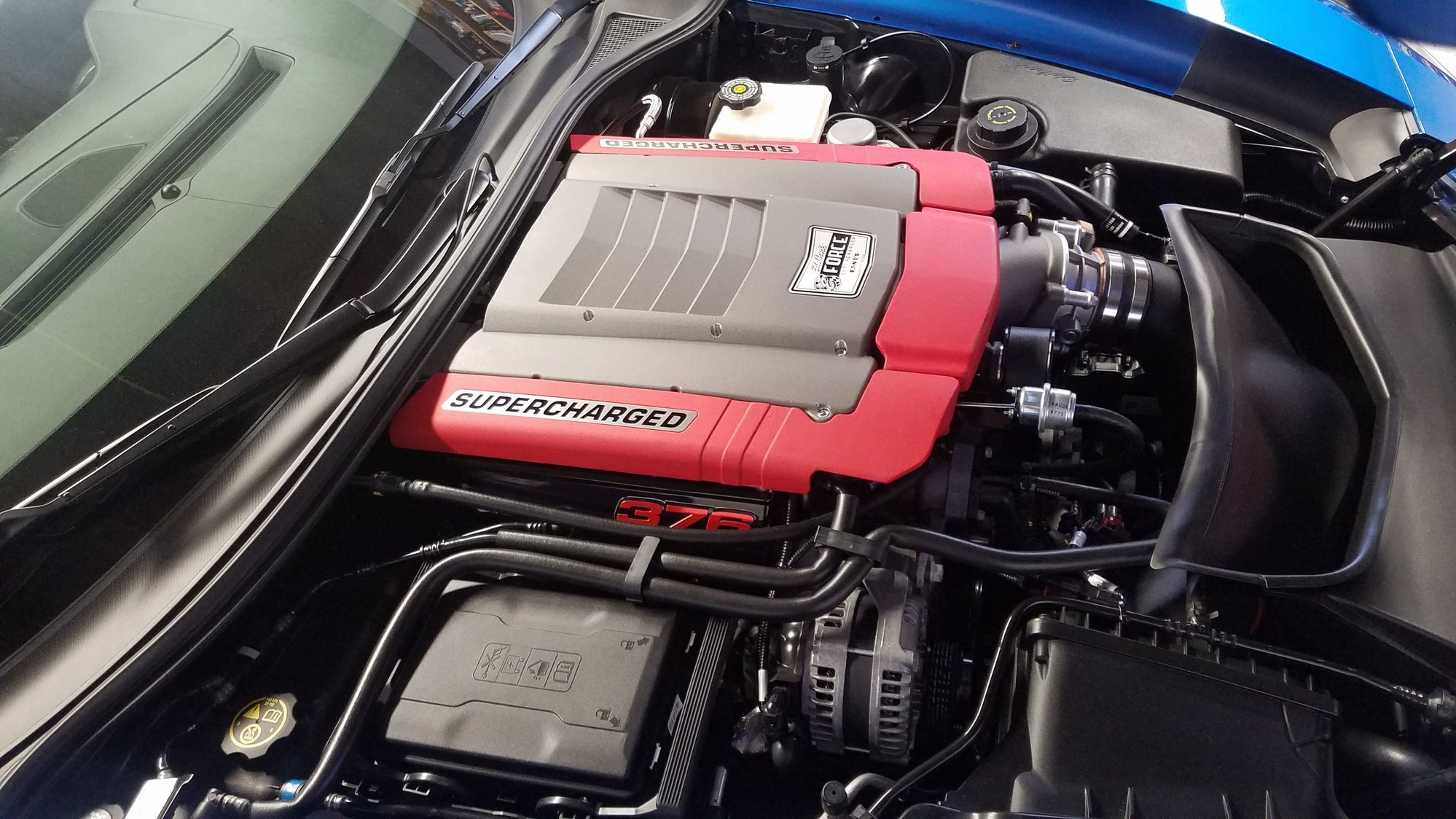

I'm going to be going to the drag strip later this month and was considering using Boostane. I have a 15 Z51 A8 with the only mods being a Katech TB and a Stage 2 Edelbrock E Force with their 93 octane tune. I did have it on a Mustang dyno and the WOT AFR ws in the 10s. I have heard that Boostane leans the WOT AFR out about a half point.
So just seeing if you guys think the Boostane will have any adverse effects if i use it?
Thanks
