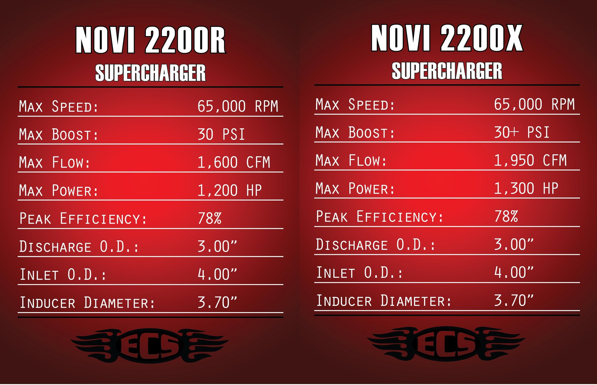

Dude...you're wrong. the X is considerably more blower than the R. It's not all about HP number it's about how much air does it move. The F1A-94 is 1625 cfm so it's more in line with the 2200R and the F1X is 2000 cfm.
Have a look.
Have a look.
i totally understand that, but there is no real life results that show the 300cfm increasment over the 2200r

Ok.... lol.. I'm not going to argue with you. The point is they don't "have the same power limit". They are in fact blowers with considerably different potentials. CFM's don't lie.
However to your point the 300 or so CFM is splitting hairs in any blower setup. Hell the f1a94 to f1x is just 300 ish cfm different. It's not worth the money to change but the X will make more power and have more future potential just like the 2200x would over the R.
