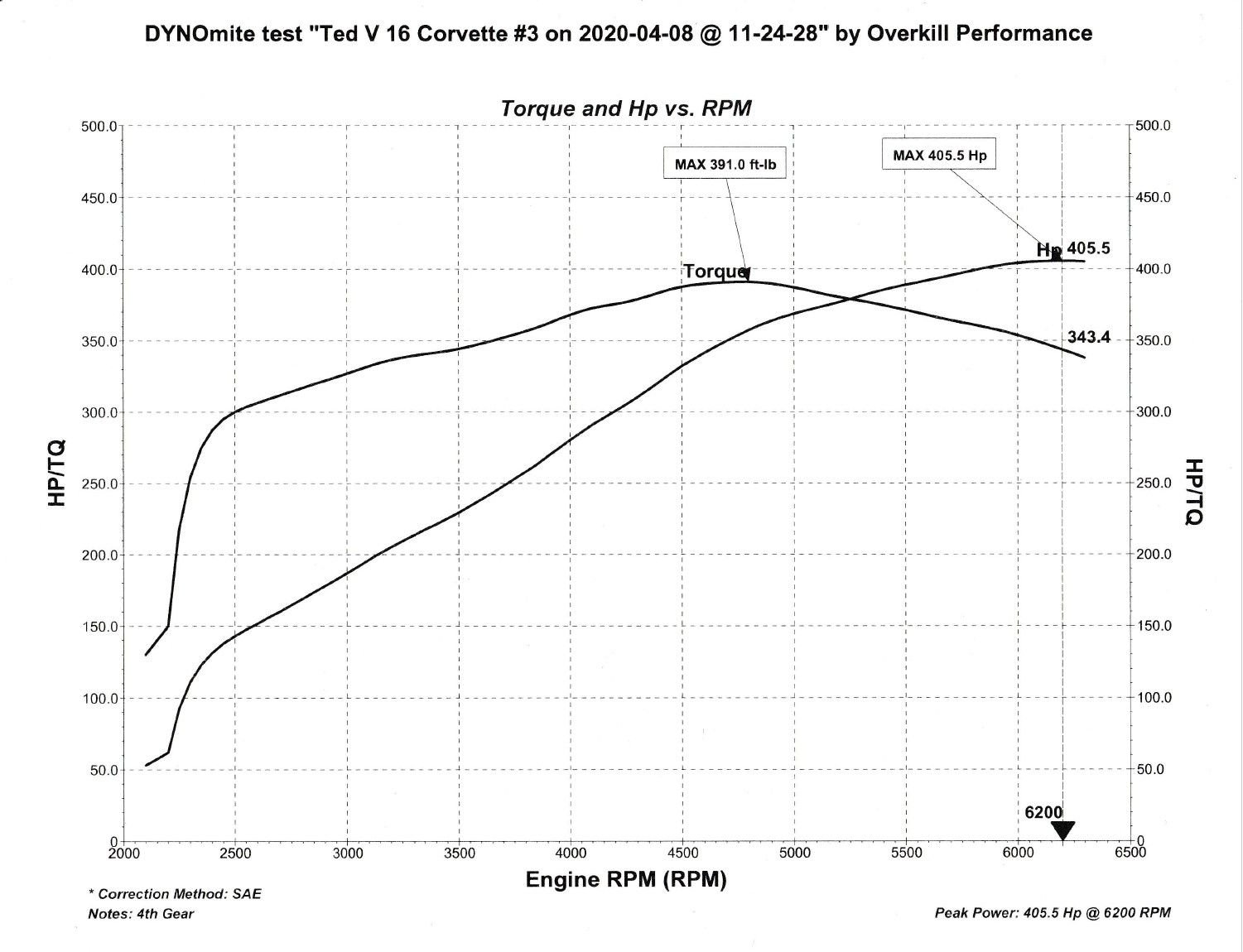

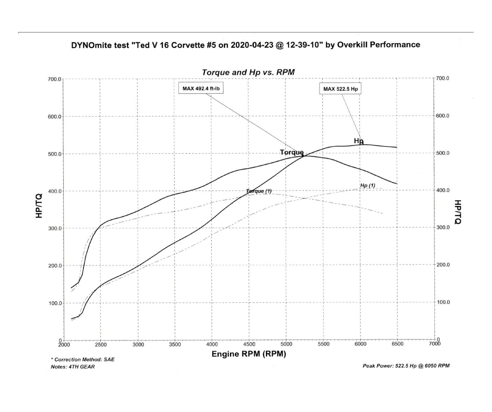

I recently installed an A&A Corvette V3 Si Supercharger on my 2014 A6 Z51 with a conservative tune is what I requested..........A&A Si V3, No Meth/Alky, Carb Compliant, 93 octane, standard 7.65" balancer and 4" pulley, Borla X-Pipe, no secondary cats, ported throttle body are the only mods. As I look at my Dyno, my smoothing is at 5 and you’re at 0, I think the smoothing is the amount of detailed shows as in jaggedness but I am no performance expert and don't know what that really means but just pointing it out. Attached is my recent Dyno.....

I read up on dyno smoothness yesterday and you are right from what I understand. When we were running the dyno, acceleration was smooth all the way to redline, so I’m not 100% sure. I’m going to order TPS headers with X-pipe and get a custom remote tune most likely from PatG Tuning. Was the ported throttle body worth the $$ with your supercharger?
