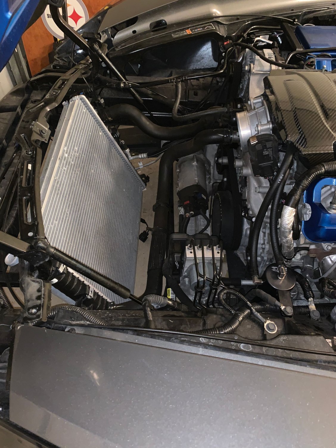

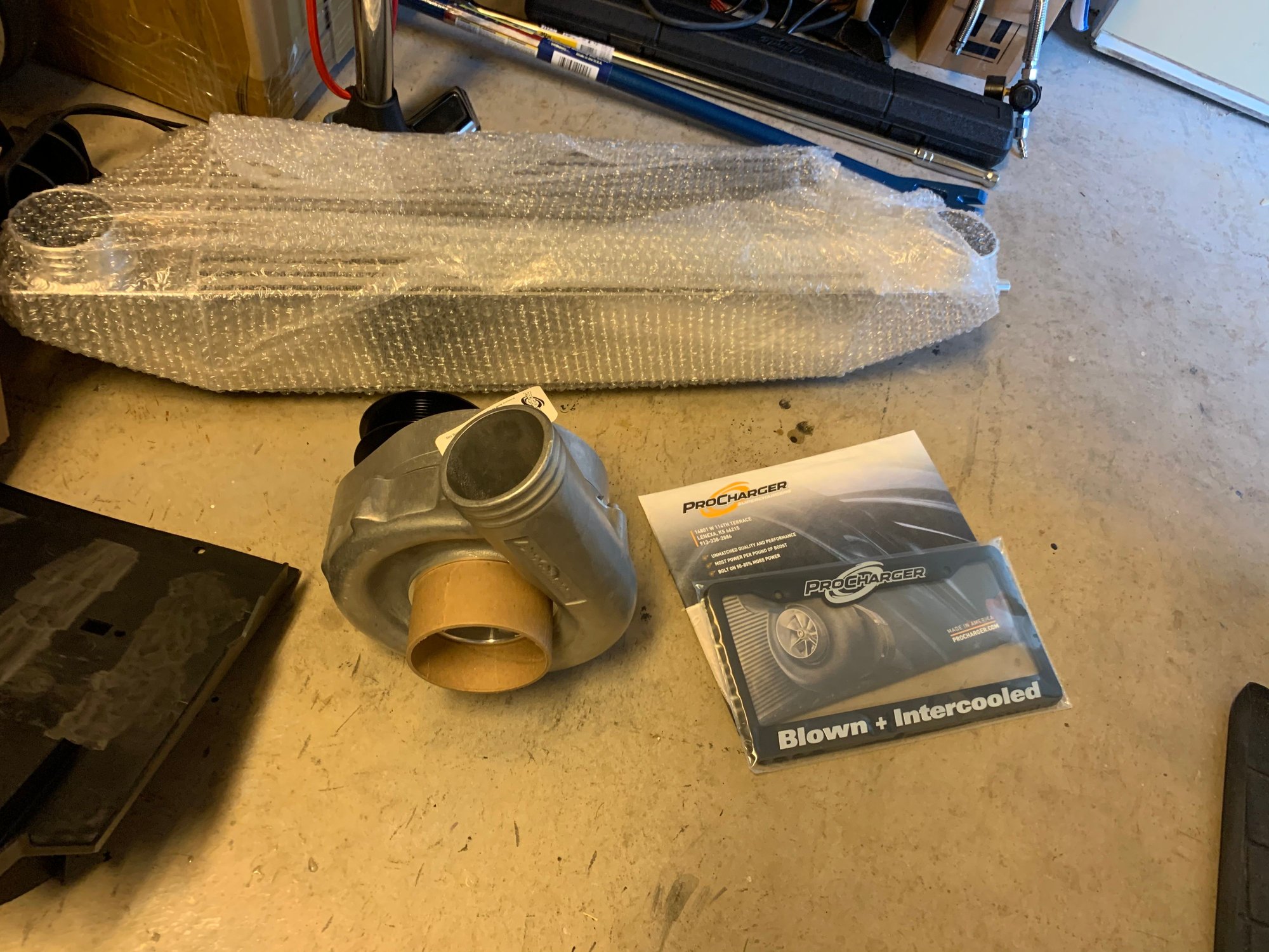

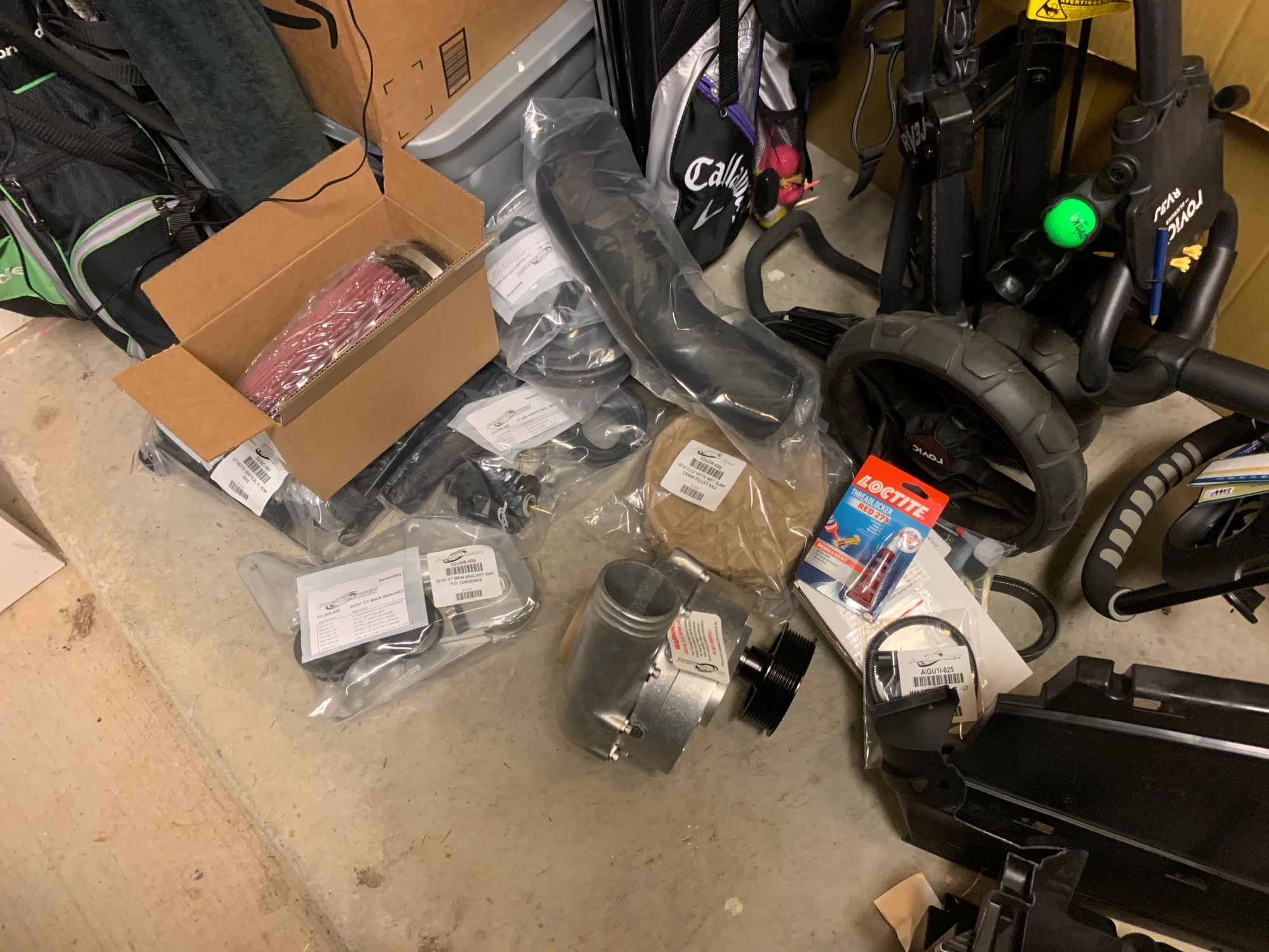

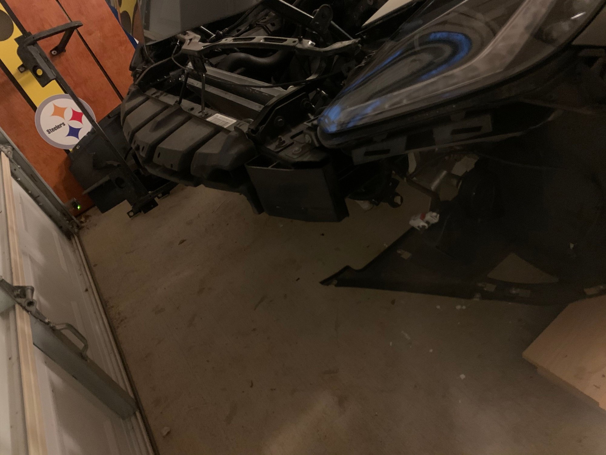

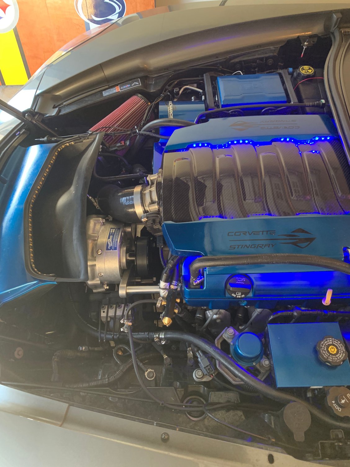

Took the whole weekend working here and there, but she is on and ready to go. Kit fits really well and install was straight forward.

Nice, let us know how it drives.

It’s the 7 psi kit with Procharger canned tune. Hardest part was the crank bolt. Had to stop the flywheel from spinning to get it off. Hopefully will get it on a Dyno next month. Took it for a little drive yesterday.
