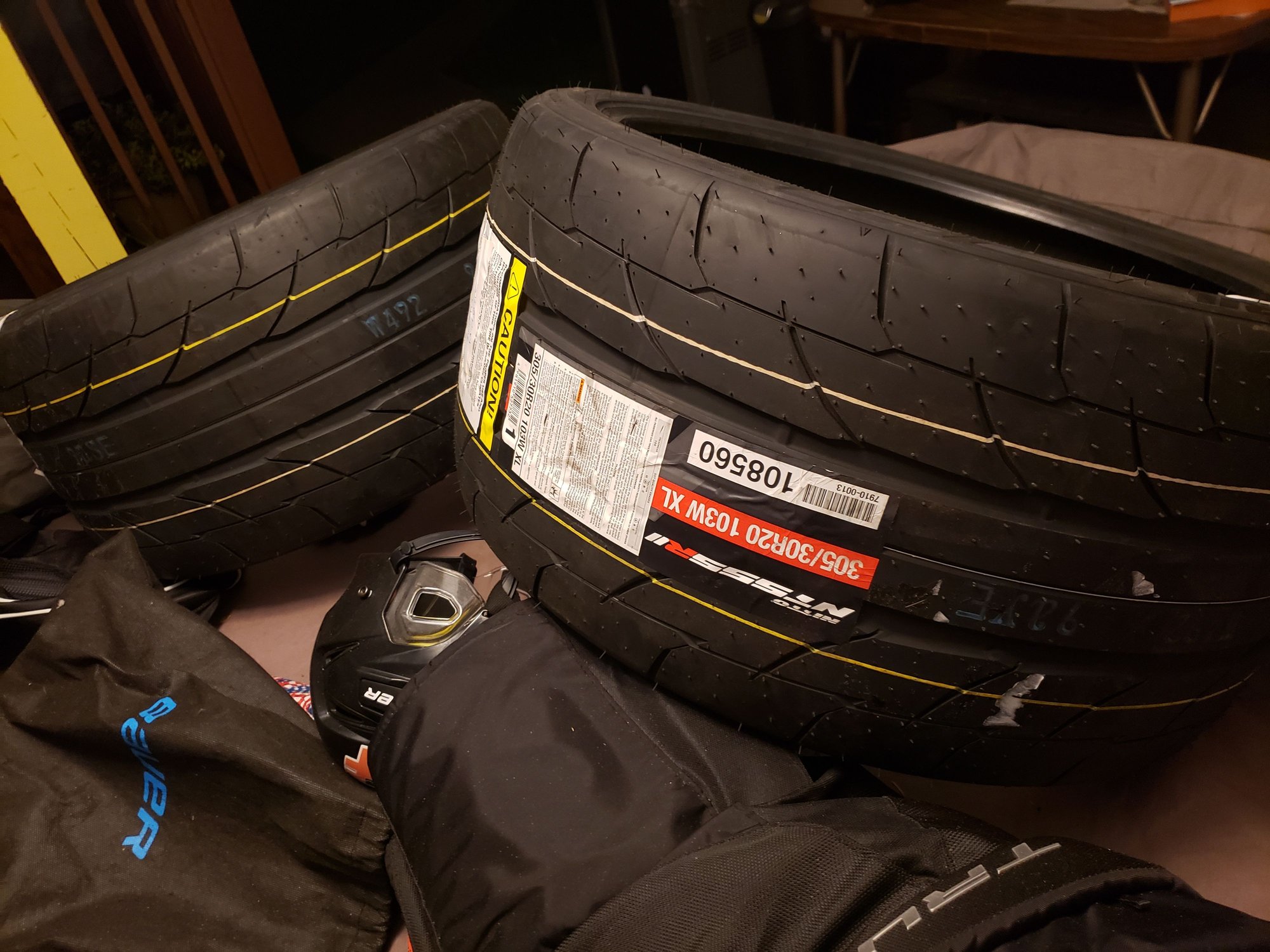

New Nitto tires. Supposed to be the cat's ***. If not I will go with an 18in setup for street and track. My iat's were over 190f towards the end of the pull. That will be lower in street conditions but now I have to worry about that, come summer heat. I refuse to run meth.

what wheels/tires are you running?
305/30/20 in the rear - what size in the fronts?
285/30/19
