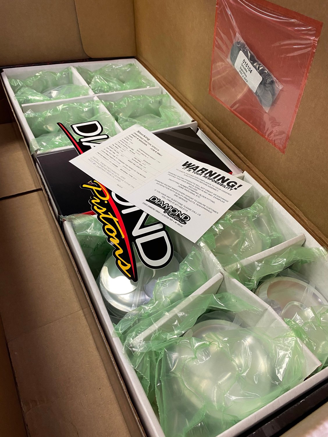

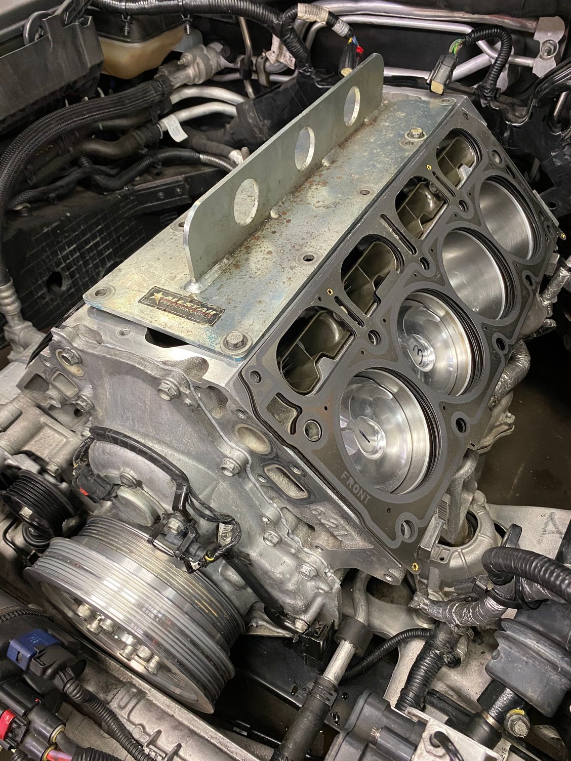

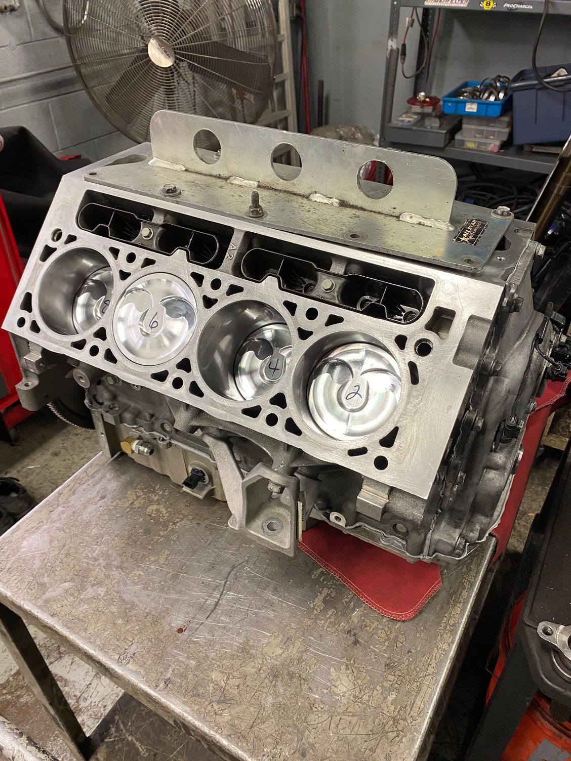

Decided to bullet proof her. Going to a 3.4in pulley. No meth. 10.25:1 compression.

Did anyone do a similar build? I will be on 93 pump gas. What psi boost will I see? Anyone take a guess on rwhp? She was at 680rwhp, no meth and 9psi. 4.0 pulley. Stock compression

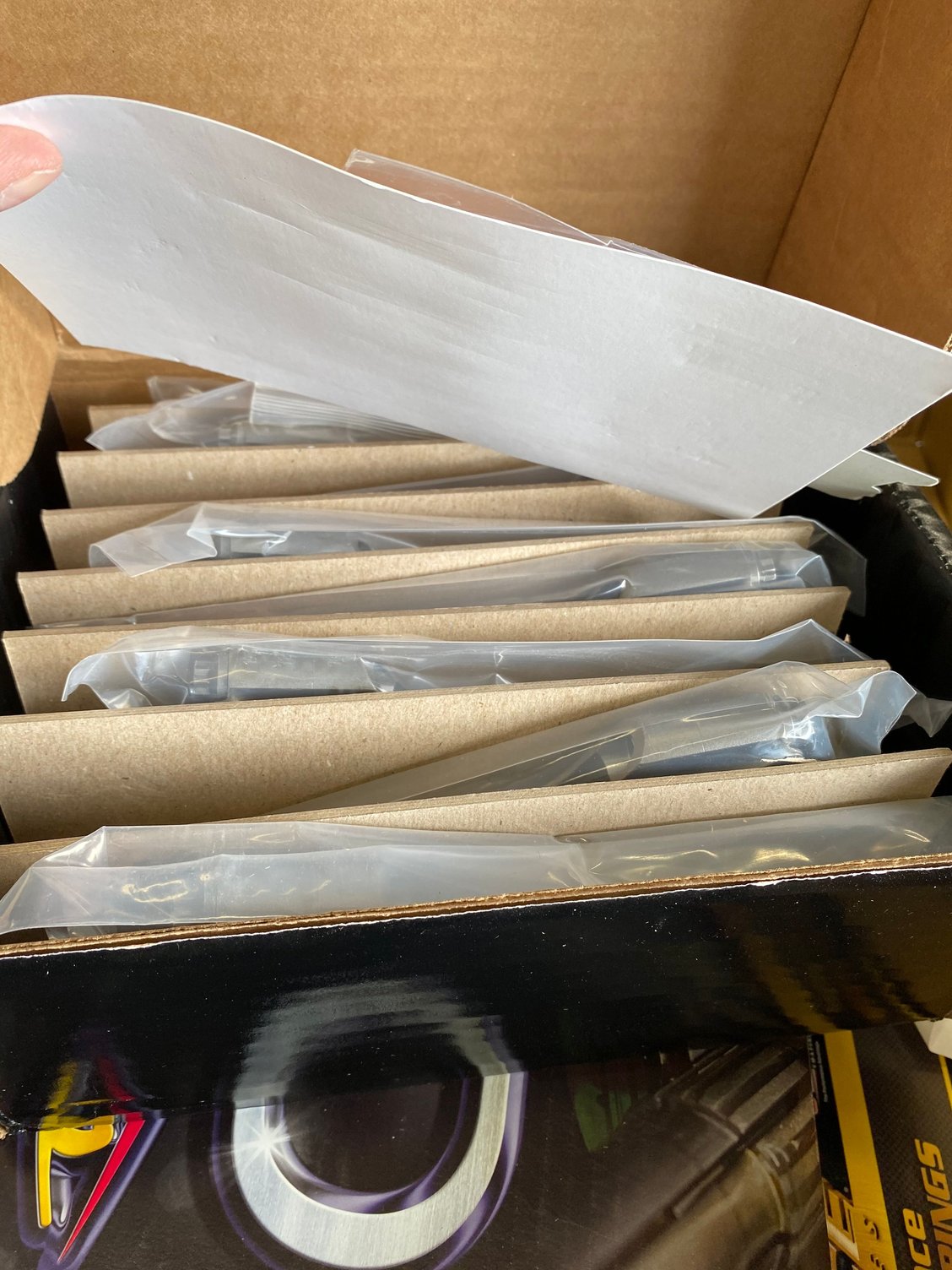

Is that a GPI kit? We've been selling a bunch of the GPI drop in kits and they work great. We've had them up to 800 rwhp without issue.
OP here if me you really need to check are get the pistons & rods balanced together to make sure they are spot on. I did the same set up as you are showing in the box. But I went with the stock comp 11:5:1 and they were off by what the engine builder told me that he wouldn't do these at what was the weight diffs. Robert

Im doing the same but I’m changing main bearings adding main studs and keeping 11.5 cr I have diamond pistons and molnar rods
They were all off. I had everything balanced. As much as 18g

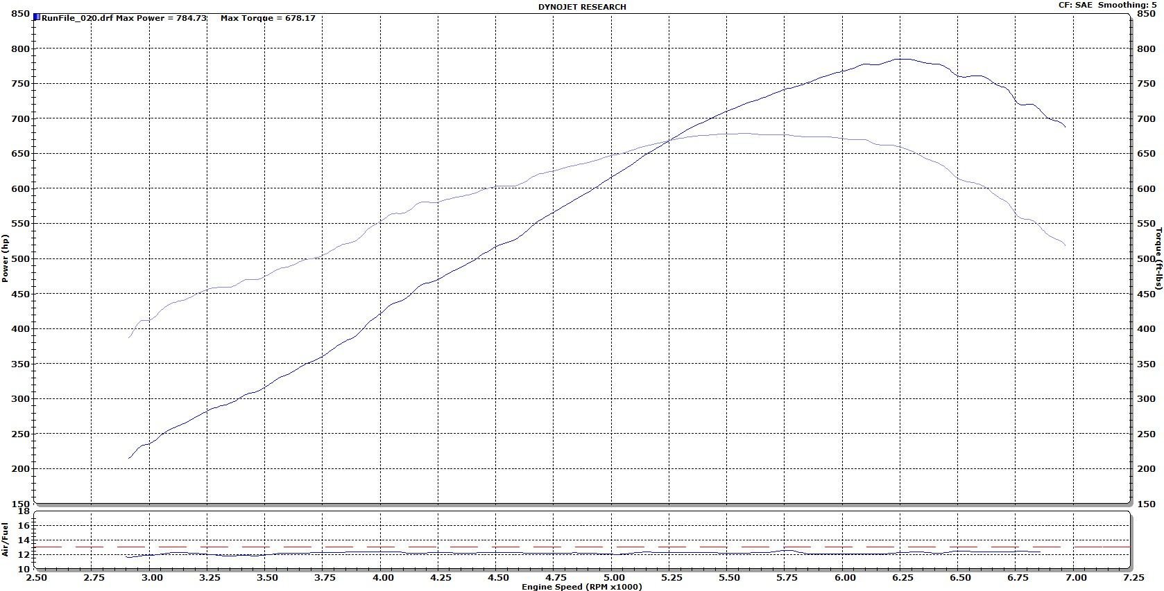

Progress...V2 Ti

13 psi, just as Josh at A@A predicted. 93 octane, no meth. Final build results.
785rwhp/678rwtq.
785rwhp/678rwtq.
Pretty much what I had on 13psi. I made 790/690.
With 100 octane or meth she would be right around 850rwhp
