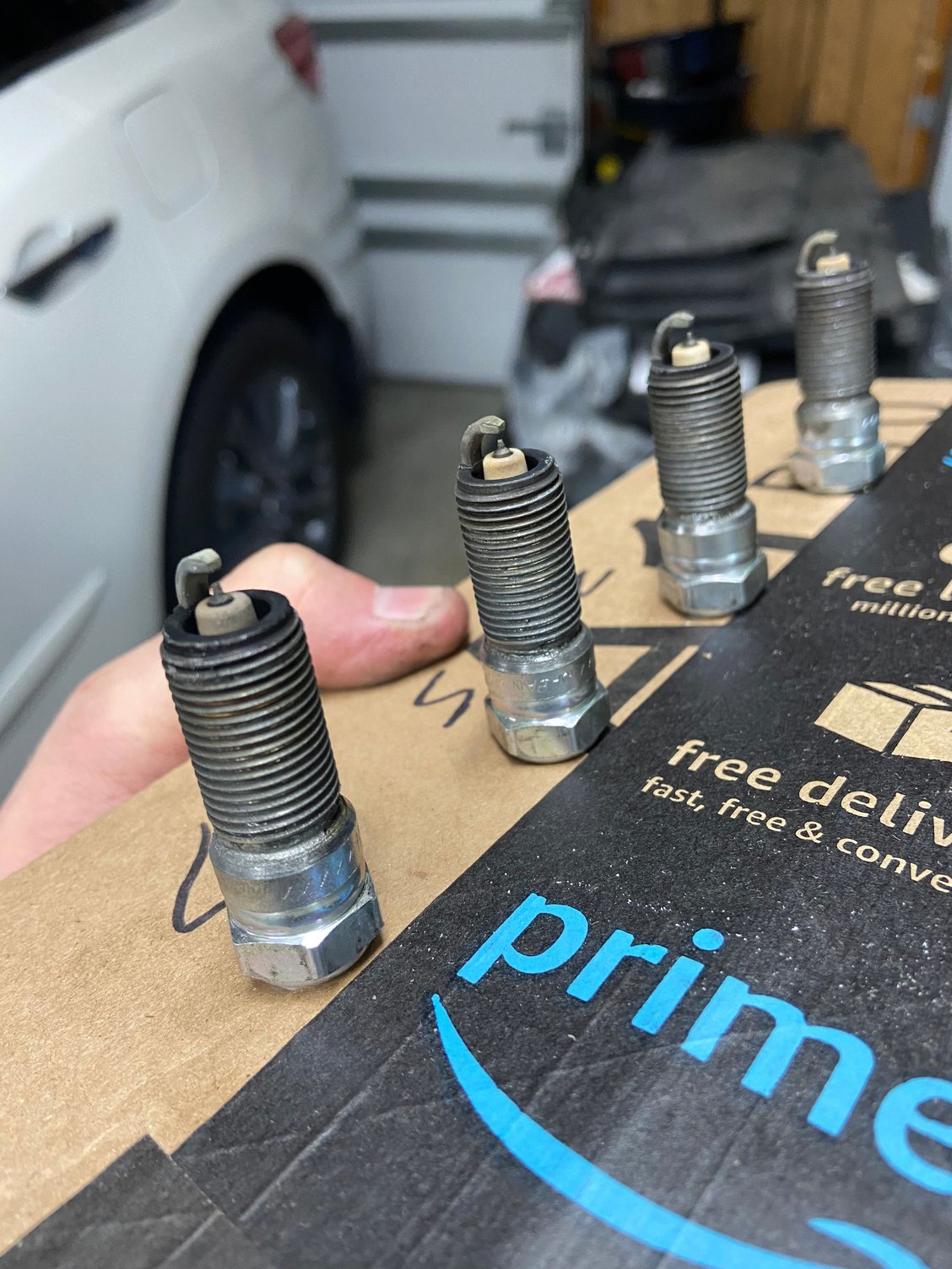

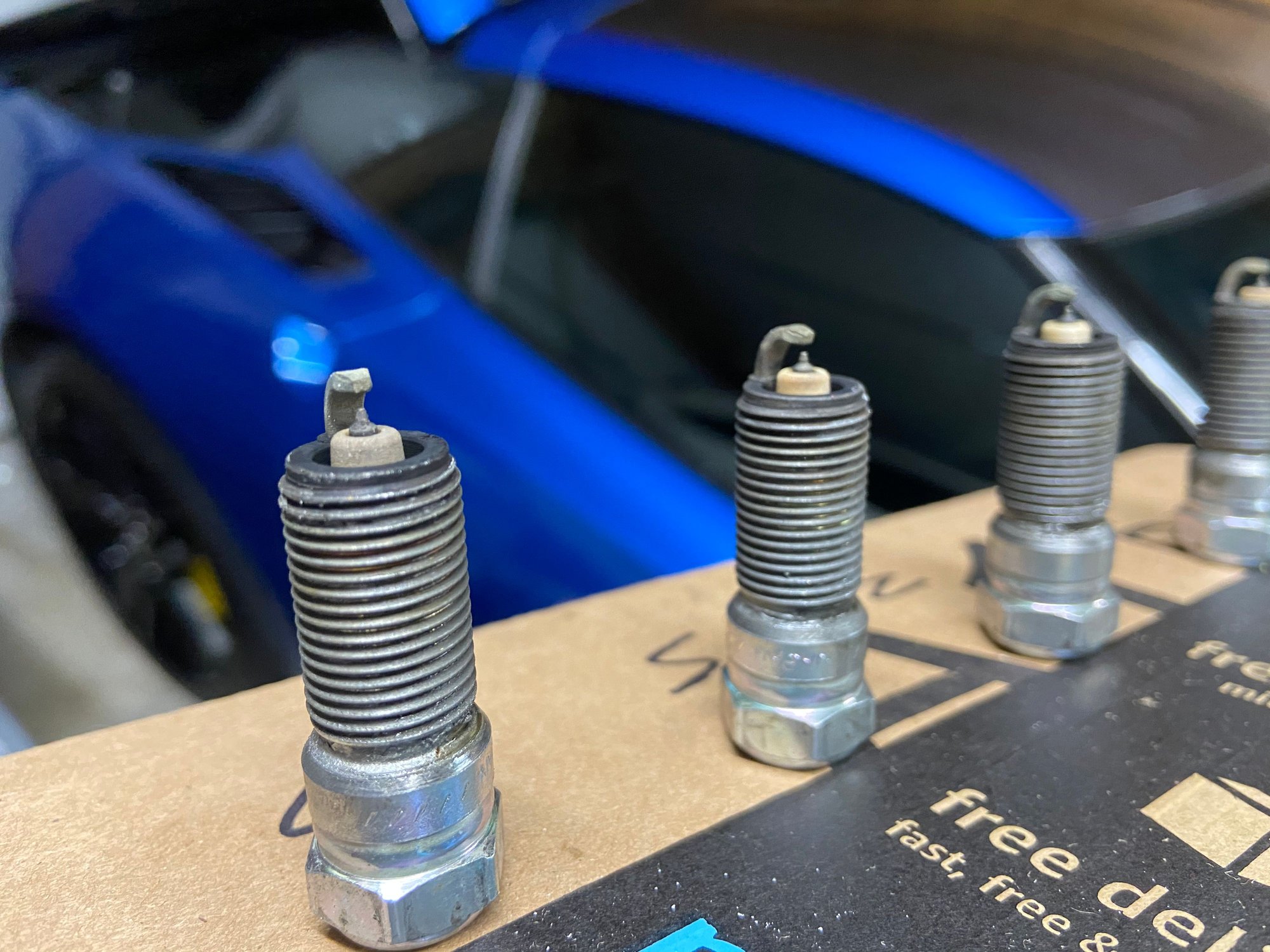

Hi Everyone,

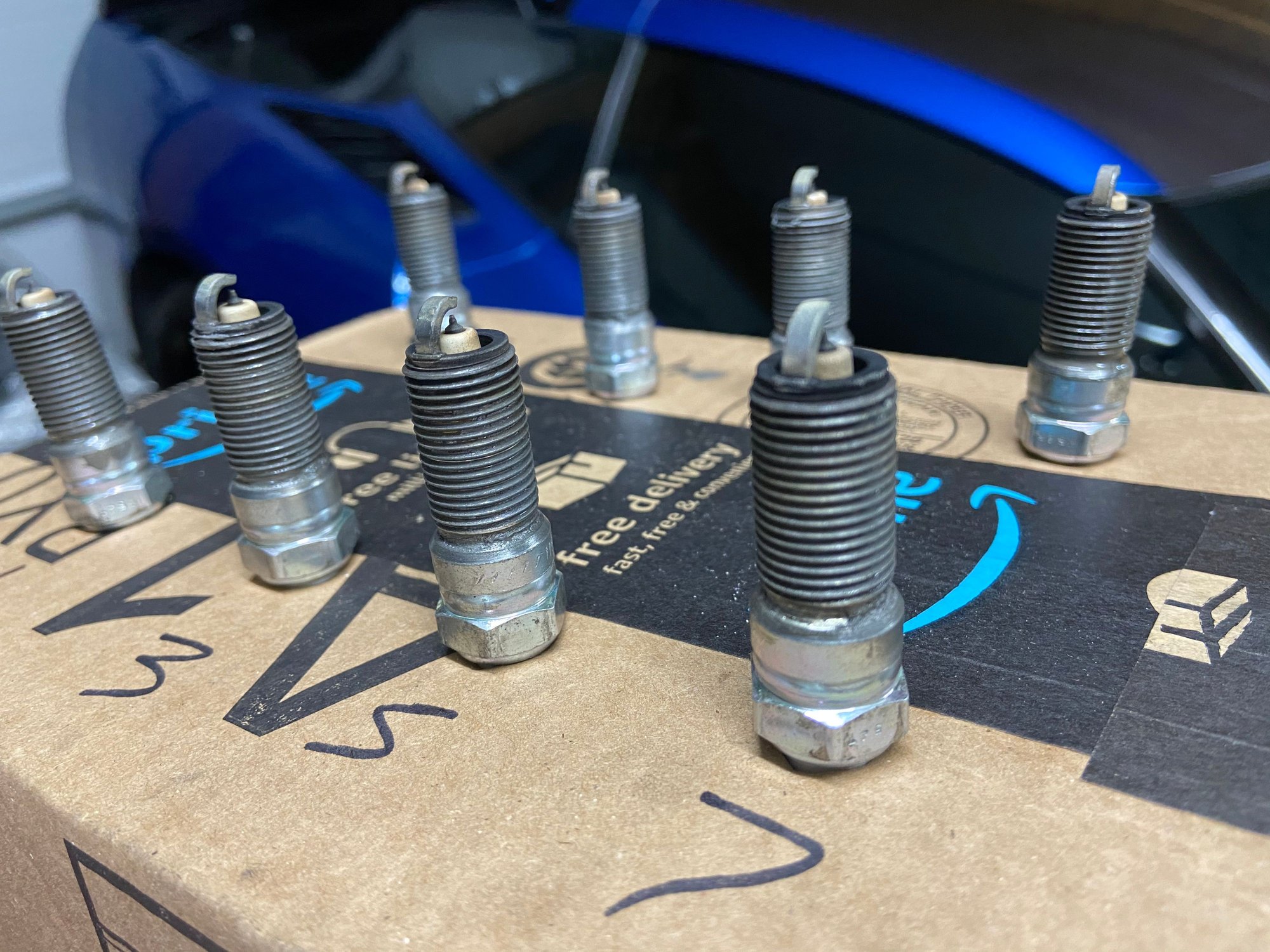

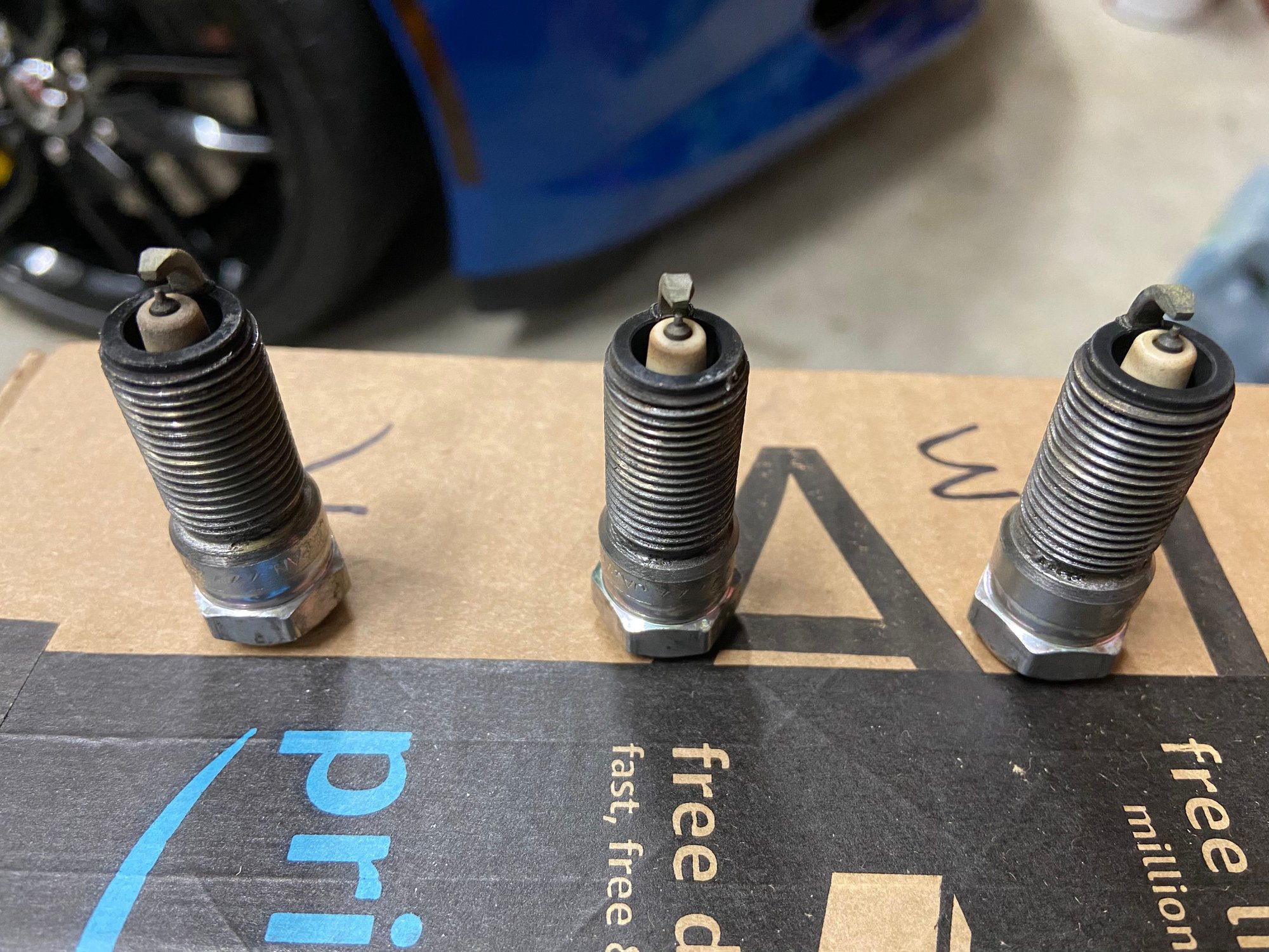

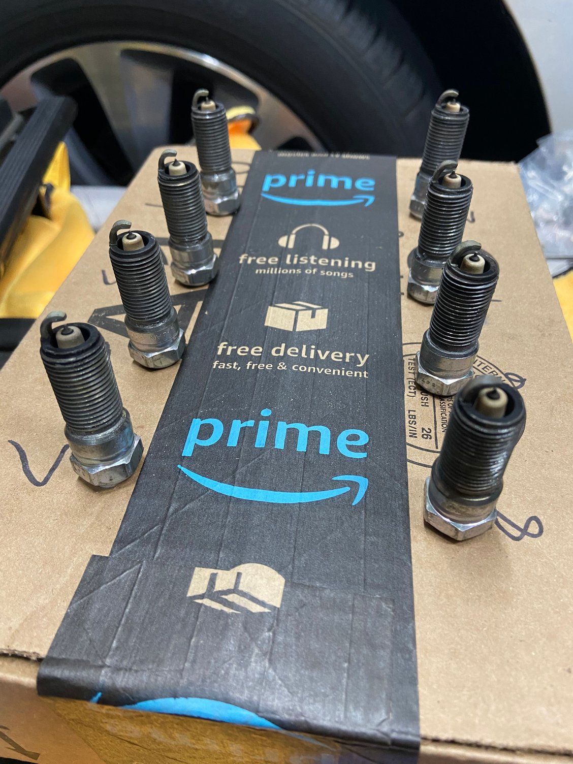

I have a 2014 Z51 with a D1SC running 93/meth. Last weekend my front main spit up some oil (similar to “Oil Everywhere!!” By BlueDevilZ51) and I’m starting to dig into it. Last night I pulled all 8 spark plugs and tonight I’m going to run a compression test on all 8 cylinders. I started with the hard side, the passenger side then went to the driver side. What do you know the very last one I pull (#7) is not like the rest. All of them up to #7 were clean, white/light brown, with .035 gaps (I gapped them all in June this year after I threw a CEL for knock just that one time). #7 is measuring about .045 and and has a light grey film to the porcelain. Is there a chance I didn’t get #7 gapped down to .035 like all the others? Sure but 99.9% sure I gapped them all (all were 040-045 range from previous owner installing). I’m reading articles on how to read spark plugs for preignition, detonation, heat range, jetting, etc and I’m not really sure what I have here. What I’m finding on CF is what spark plug to use and how to do them not specifically how to read them. They’re NGK LTR7IX-11s. If any piston is suspected of excessive blow by popping the main seal, at this point I’d say #7 could be the culprit, but is this light grey film “normal variation”? Could it be my meth isn’t getting back to #7 adequately?
Appreciate all inputs and opinions!

Plugs look good to me, I gap mine to .030 you can look for speckles on the porcelain. That would be a sign of detonation

Close the GAP on those plugs, it will run alot better, lol!!!!!

Plugs look good man close them down to 28 to 30. THEN RELOOK AT THEM. Also how did you run the car before you killed the motor to check them. Robert

I agree with the gapping of .030, I run .032 on mine. . On my Magnuson SC Camaro I ran .025 on race fuel, some run less then that but I wouldn't go lower the that. They don't look bad as another said. Not rich and not lean.
