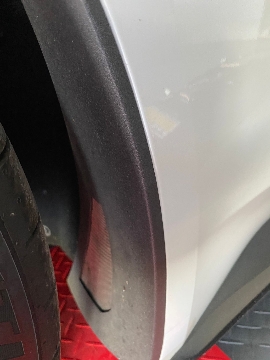

Love to see a picture of how you are venting the meth pump area

Yes, I believe I understand what you did with the mudflap, but a pic would be great!

Here’s a pic,I also did numerous other things too however in anything 80’ and over system still wants to lose pressure and I have to hit test button until full pressure builds(green light) then ok for a run. But will need pressure built in a short while. If temps are cooler….all works fine. I have no idea what could be getting hot to boil the meth(if in fact this is what’s happening. Very frustrating all the time I’ve spent on this issue. Hard to believe everyone isn’t having same issue.Basically Julio believes if washer tank is moved elsewhere it will cure it.I don’t believe this at all because I’ve dropped a thermometer in tank several inches and temps now never exceed 117’. If someone figures it out I’ll buy em dinner!!

So I already had a pretty good tear in the liner from oversized tires on the track right in that same area you put the mesh. I simply grabbed a blade and made a similar triangle hole in the liner for now, drove down to palm dessert to cosco to get some steaks, and then back up the mountain. With out going into any more detail, I held pressure the whole time, right back to my house!! To me, this seemed to help over and above ALL the cooling things I've done so far, including Julio's fixes...
Thanks for the TIP!!!

I’m assuming you’ll have to cut through the fender liner as well as the splash guard. How did you attach the screen to the inside of the splash guard, urathane?

Ok, so I vented in the splash guard as well. Thanks Gary
