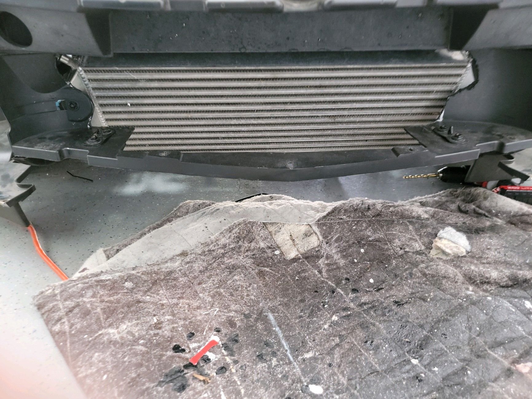

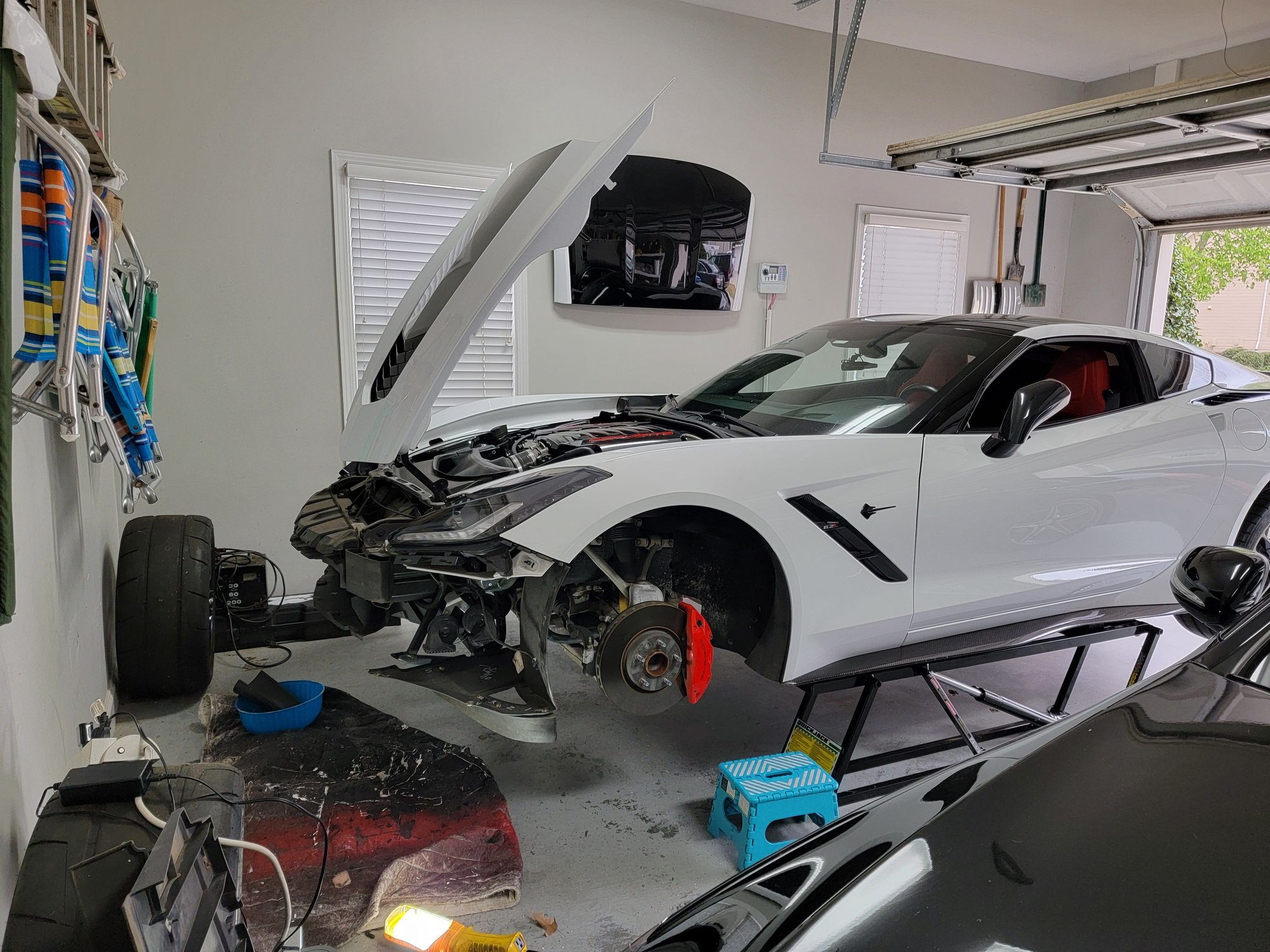

This was the hardest part of the install ... my harmonic balancer bolt would not budge , heat , PB Blaster , the largest and strongest Impact gun with a Ingersoll rand 24 mm ringed socket did not budge it , finally a 36 inch breaker bar plus a 2 foot pipe and a few uga tugas later it came off . It was easy from there . My tuner had me buy a IAT breakout harness and a 3 bar map sensor plus a AIr Fuel meter
