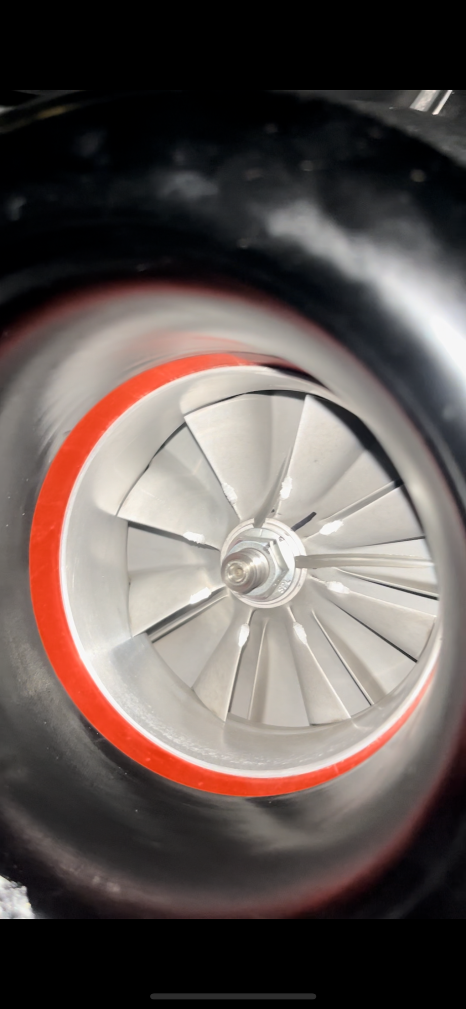

How bad is this impeller damage? I know best practice is to replace the impeller but has anyone had similar damage and the blower still worked fine and lasted?

Not bad at all, I’d run it

Agree with T/A Kid
How'd it happen? If it wasn't impacted and just rubbed, I wouldn't worry about it.

I would at least file the sharp edges down and "smooth" the nicks out best you can.
