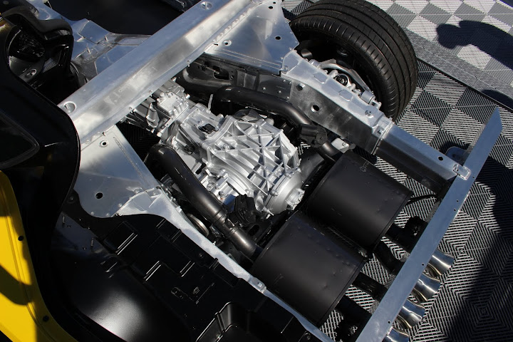

Here's the NPP exhaust in the cut away chassis:

No, as mjw930 stated in his post, the non-NPP has two tips that are from a Y pipe (one inlet, one outlet that splits with a Y into two tips on each muffler).

I guess you didn't read my post. Each stock muffler has one exhaust pipe and a "Y" connection to 2 tips. 2 mufflers = 4 tips.
