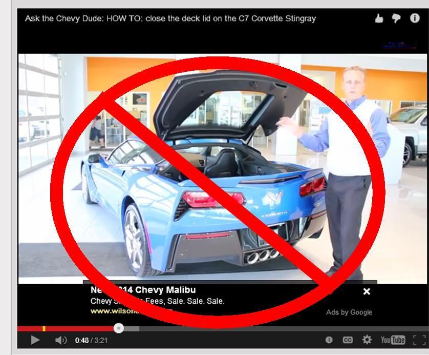

Don't be afraid to close it. the video above explains all

Mine takes a lot more force than that video shows.

I find myself pushing down in the center as demonstrated in the video.

Have had my car for a year and still need to have my door open! Some cars are so tight the “Memory Wire Vent” (that you can see operate it you remove the license plate and look in the large hole behind it) it’s big enough for a tight car! I did that to see if mine was working properly, it is. Some cars can and some cannot latch no matter how much force is used! Forget that video, it has been around for a year, yours either does or doesn’t latch! I have tried from high and low and all force levels. Even tried adjusting the hatch stops to a point where it was misaligned-no latch! It closes so easily with the door open. In fact I can stand just behind the open passenger door and with my right hand gently push on the corner of the hatch and it shuts and latches fine-very little force. Then I close the door with mu left! Just tried today with a lot of force using the handhold (because the door wasn’t open)- no latch! It latched, as usual, by just letting it drop when the door is open. Unlike my C6 (and many other cars) that had an electric pull down to latch, the C7 uses a memory wire activated vent- it is not large enough for some cars.
Do not push in the center of the hatch to latch! Folks at a museum pick-up were told there have been reports of paint cracking. A large dealer was quoted as saying ~20% of the cars he has sold had hatch paint cracks. The first time I tried, a year ago, I saw the hatch frame bend so never did latch it that way. Folks at the museaum pick-up were told to push with two hands near the glass edge where it is peaked to latch.
I just keep a door open. Just have to think thru the process. If you’re getting into the car and will put something in the hatch, open the door first. If you’re leaving and will get something out of the hatch open the door first then open and close the hatch before you close the door!
Does Not Work For All C7's!
