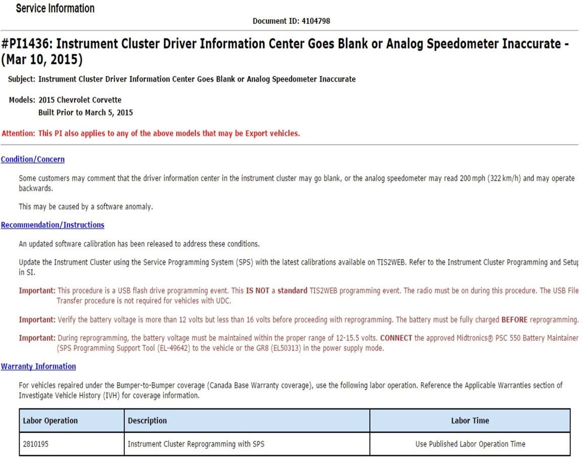

What is the PI 1436?
My steering wheel fav/vol don't work and the right side select dir controls don't either. Now (I had the drive mode linked) the drive mode doesn't change the drive screen.
I did have the battery disconnected a few times.
Checked connectors inside the steering wheel and they are fine.
Found it:

Been a few weeks now and the issue has not happened again after the software update.

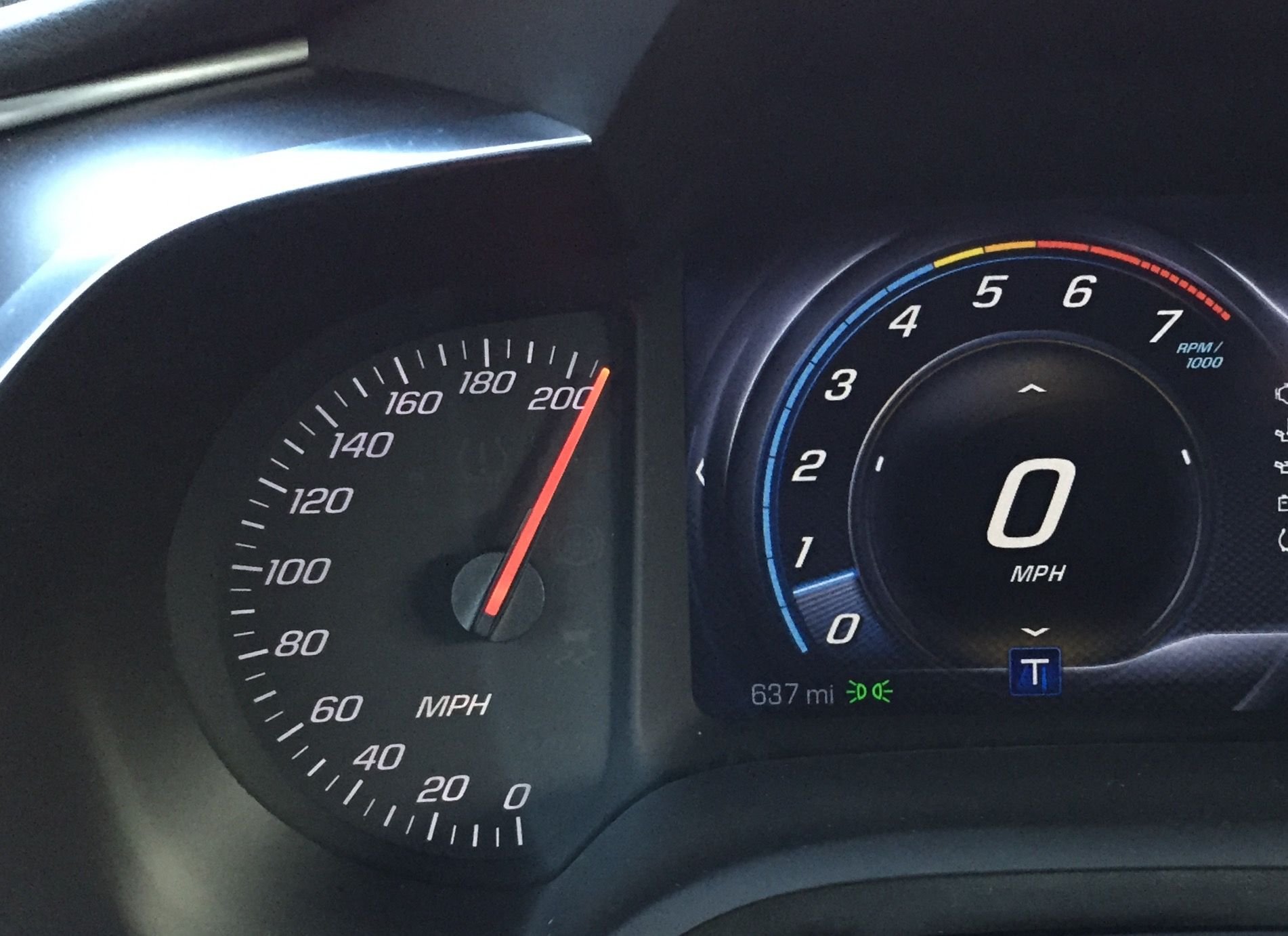

Already had an update for this and it worked for a few days, then the issue returned where the analog speedo operates backwards.
