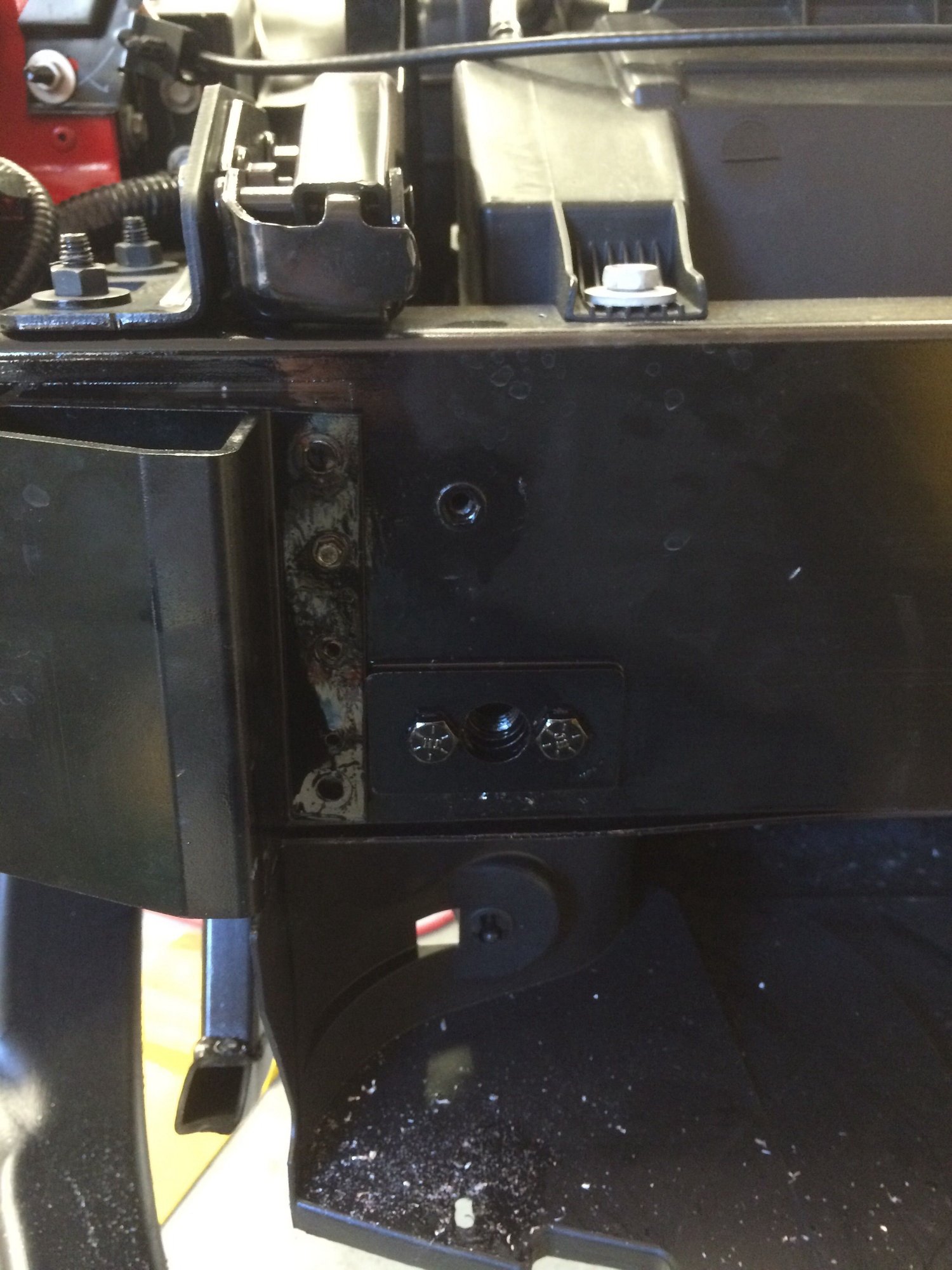

Has anyone installed a front tow hook? I can see on the rear bumper where the hook will go, but the front doesnt seem to have one.

You’ll be disappointed when you find below what appears to be a cover for the rear toe hook does not have the treaded nut on the inside! Only the European cars have both, the hook and the place to insert them!

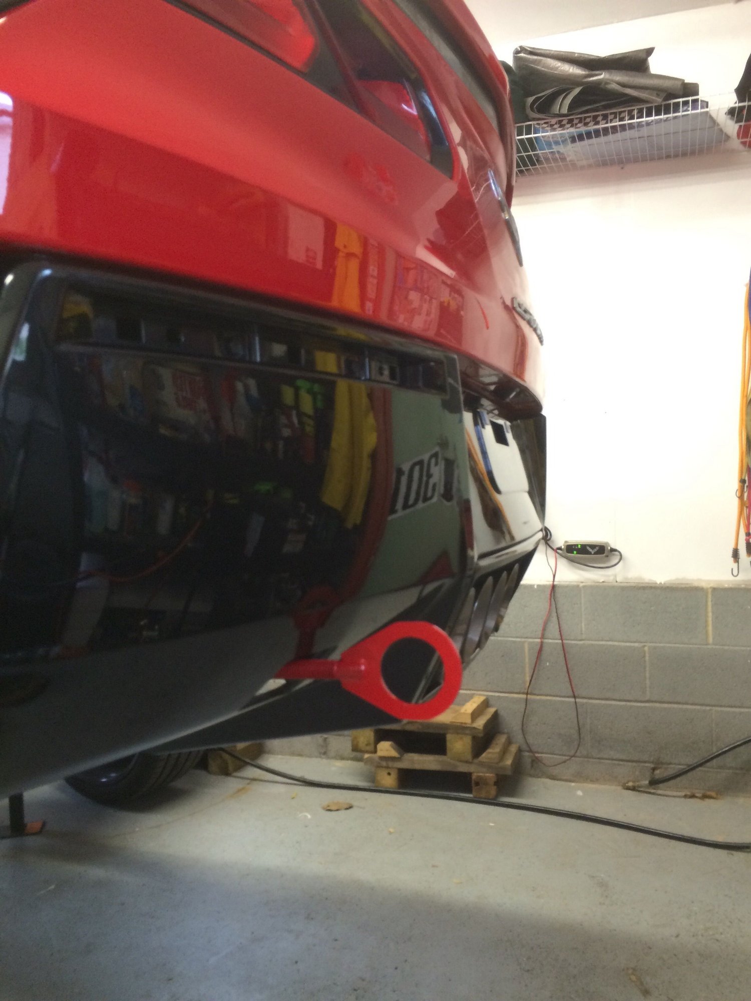

I just picked up my 2015 and notice that the tow hook was missing, am I reading this right that they don't come in the US model?
Just notice that I need to update my picture

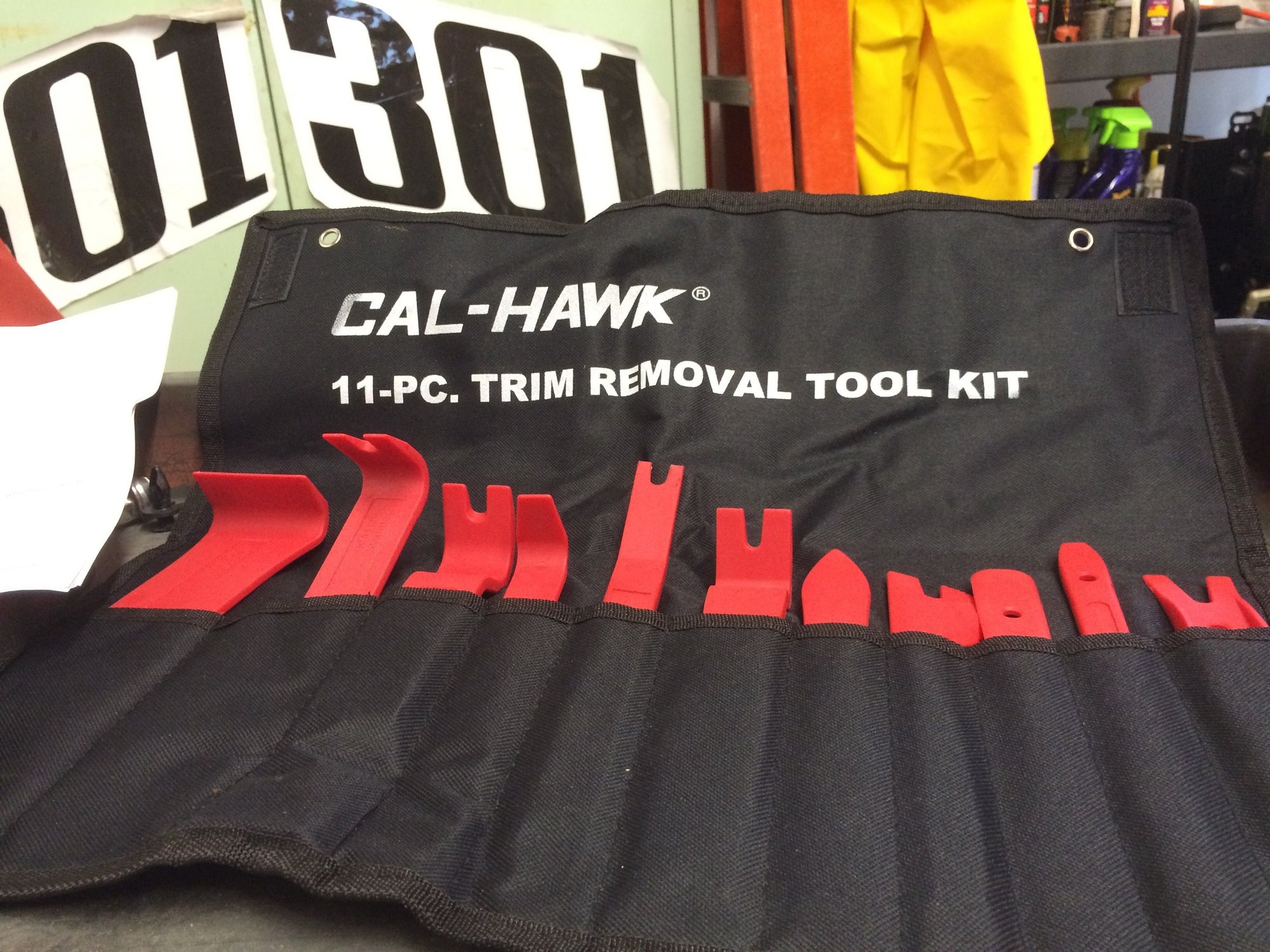

Phoenix Performance sells the brackets you need. They are a PITA to install-mostly because of all the extra stuff you have to remove to get to the actual bumper.
Don't even attempt this project unless you have the proper trim removal tools. I bought this set off of Amazon.

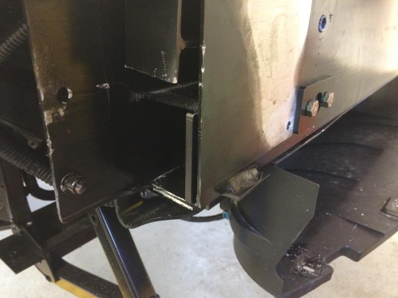

Here is the Phoenix model-exactly what you are referring to : Backer plate with a grade 8 nut welded on it. It's a rather large backer plate as well. I'm more concerned about the rear hook and mount VS the front.

I got the impression that the OP was talking about mounting the backing plate (and receiver nut) not inside the crossmember, but behind it; that is, as you look at the end-on view of the crossmember in your photo, behind the left verticle wall of the entire structure. Hence his concern about whether there was sufficient clearance to fit it back there. I believe his thinking was that this would add structural strength, since we still don't know exactly how GM engineered the european solution. (I've asked Chevy customer service about it. They had no info)
Would you be willing to compare the length of the tow hook from your Phoenix kit to the length of the factory one (using the cutout on the battery cover)? This might allow us to make some reasonable guesses as to whether GM thought mounting the receiver behind the front wall of the crossmember was sufficient. Or it may just confuse things, I dunno.

Correct. I am envisioning a full size plate the height of the frame rail on the engine side of the frame rail to get benefit of complete structure. It will be a week or two before I am able to work on my car and mock something up but think I can get something simple to work and be robust. Will use OEM kook eye and also incorporate GM tow hook bracket from XLR

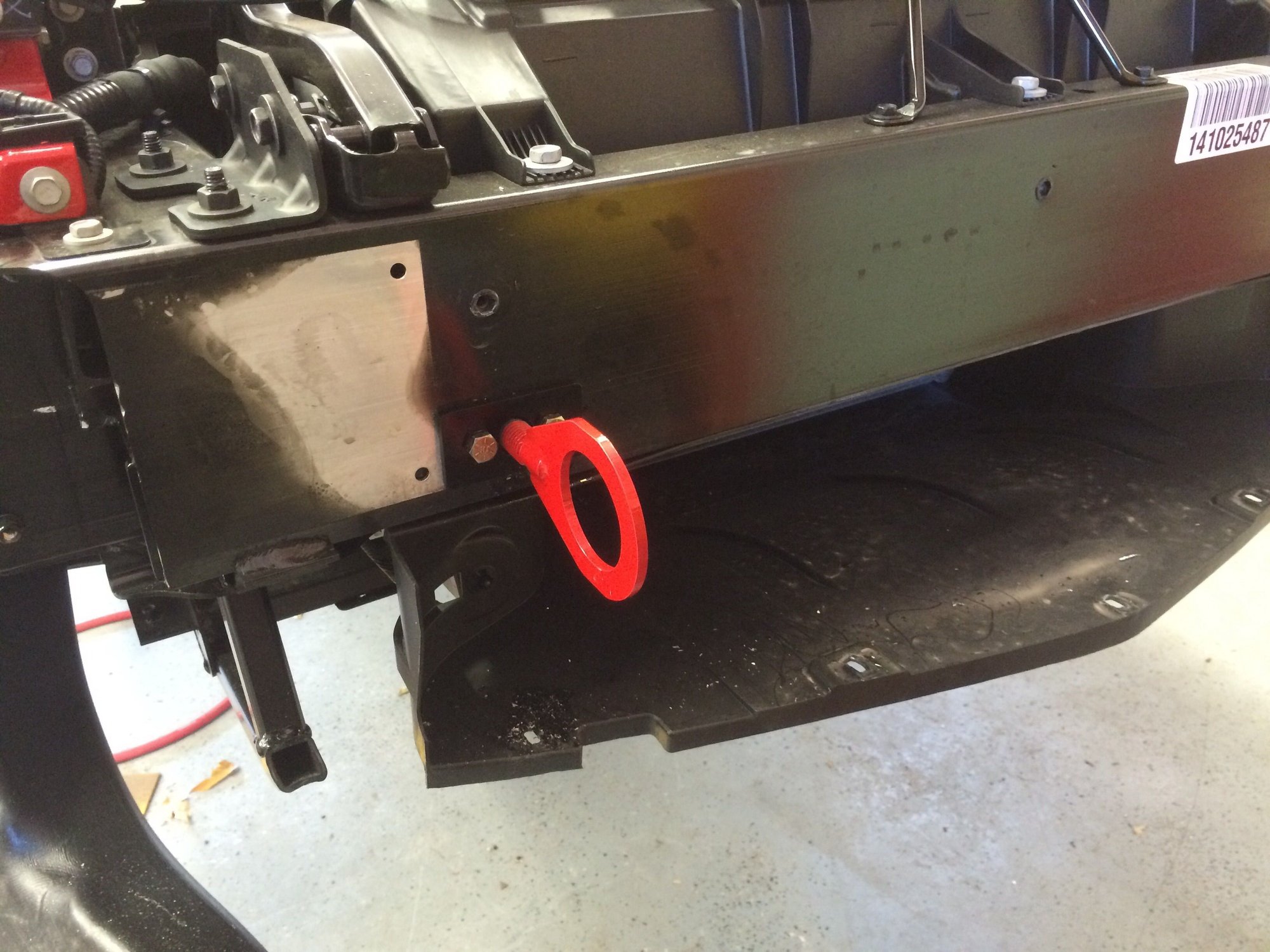

I have attached my CONCEPT for front tow hook bracket that tries to replicate the "export version". I have not removed front facia to see if this approach is feasible. This to me would be minimally invasive and pretty structurally sound. I do NOT know if the thru hole already exists in the front frame rail or if need to drill thru to insert "threaded stock". Again this is prelim concept idea and ballpark size I would envision.
