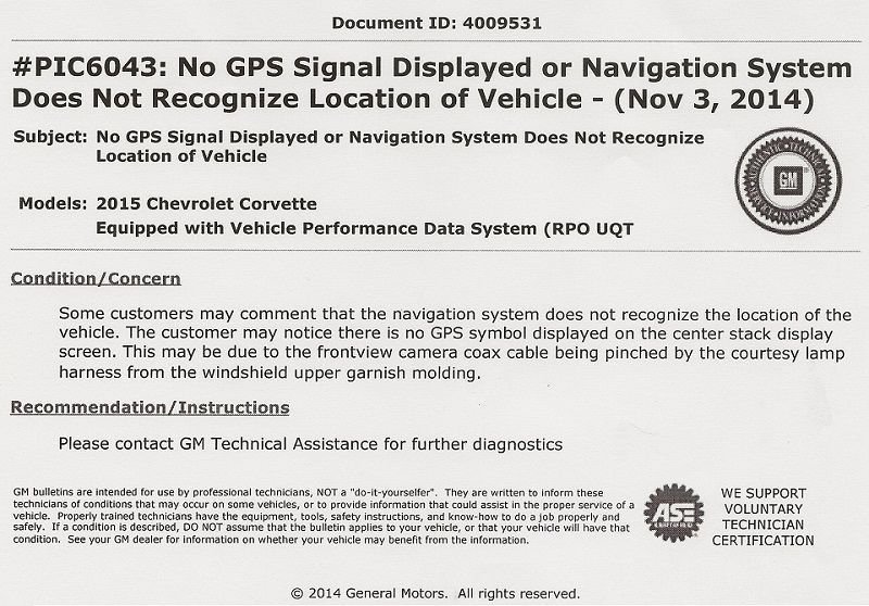

I have this same thing on my brand new car. It is a known issue. There is another thread on this vary topic, but I cannot find it right now.
Here is the Service Bulletin:
Here the other thread;
https://www.corvetteforum.com/forums...r-gps-box.html

I have been assured that the Red X problem on the NAV has been very recently fixed at the factory (Oct, Nov?). There are some dealers who can make adjustments in the NAV if you have a Red X problem from a C7 built earlier.

Mine has this, and the dealer in going to fix it (they say, several threads). GM did NOT want to send the dealer the fix, wouldn't even admit the issue exists, even when I supplied the bulletin. Gm eventually admitted they were wrong and send the fix instructions to the dealer.
Interesting to note, if you have this problem, start a PDR recording for a minute or two, then stop recording. Go to the NAV, wait 30secs or so, PRESTO! Red X disappears and GPS updates the location. So far it's worked every time.
